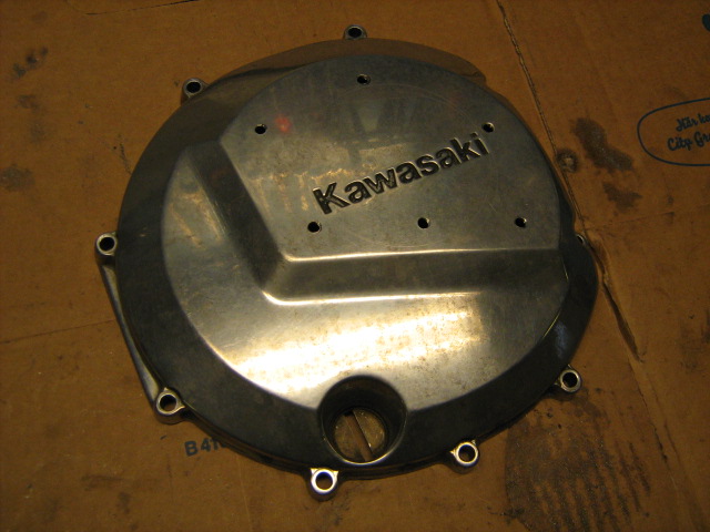

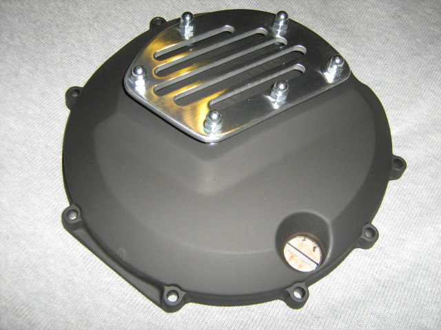

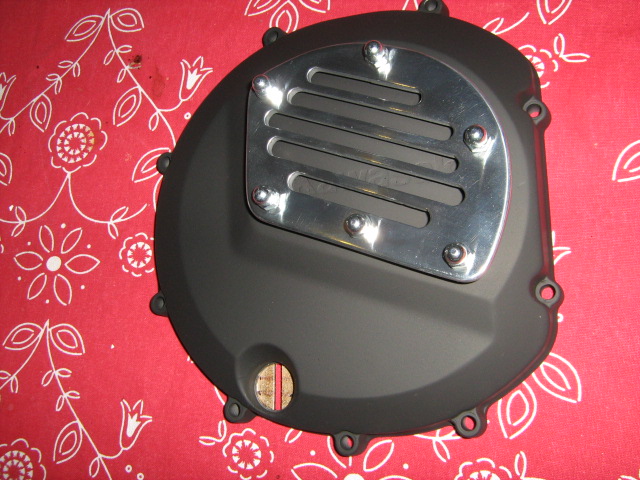

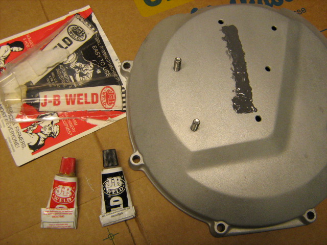

This is not very retro:

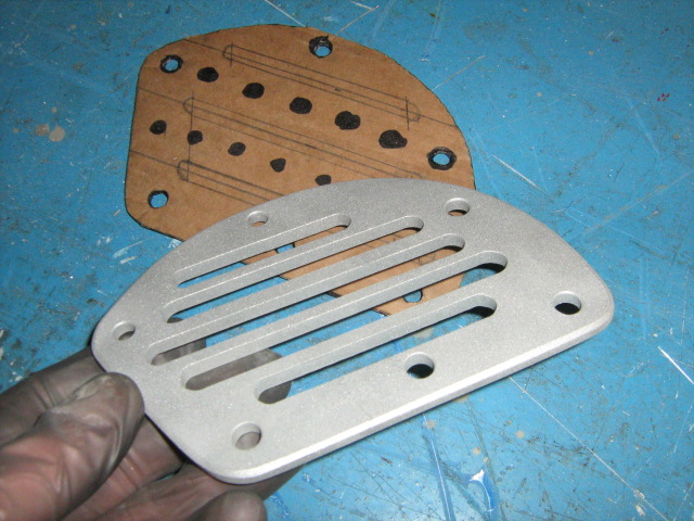

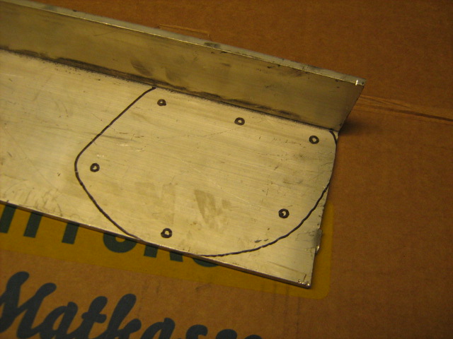

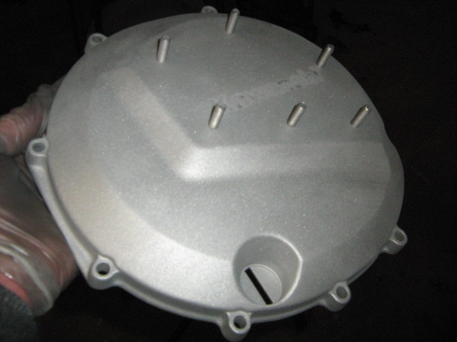

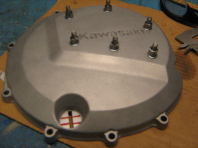

So I cut out some aluminium:

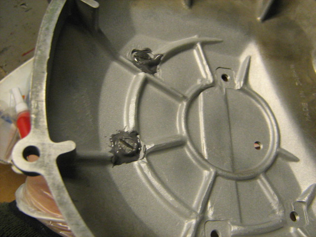

Cover up the Kawasaki-logo with some JB Weld:
Drill, mill and add some bolts:
Milled out some retro shapes in the aluminium:
Glas blasted the cover:

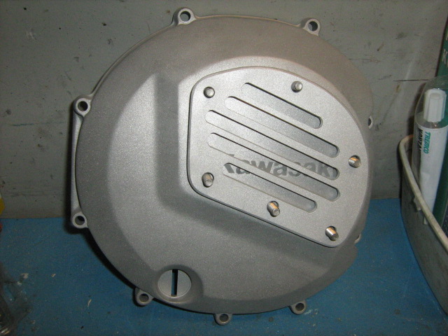

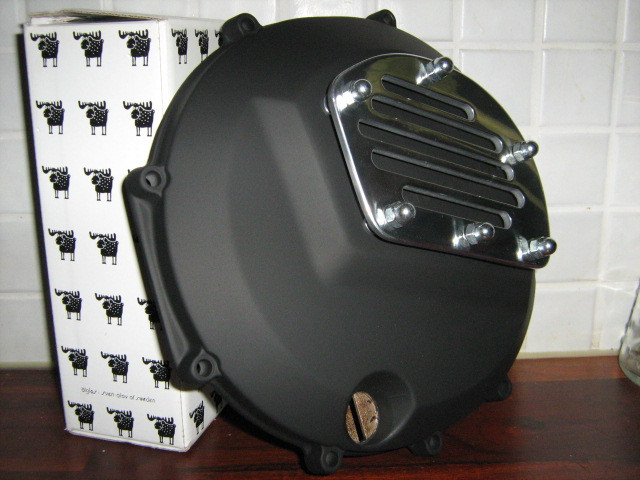

Fit them together and have a look see:
Some heat paint, polish and bling bling..

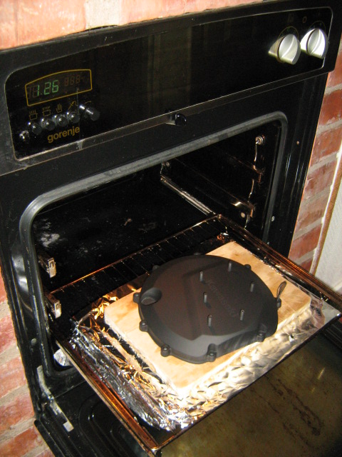

Some complementary pics:
Swedish pie:

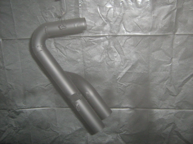

Paint on exhaust pipe:

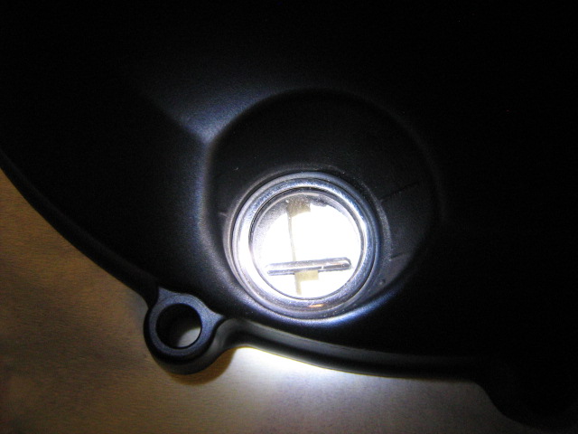

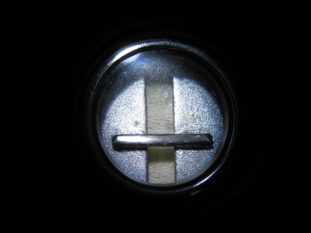

Sightglas how it was supposed to look (before I stuck it in the oven)
Small pipes for distance:
Yet there is so much more to come :laugh:
Swedish pie:

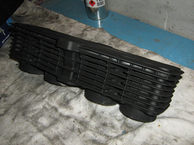

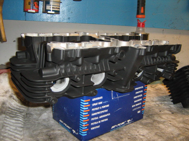

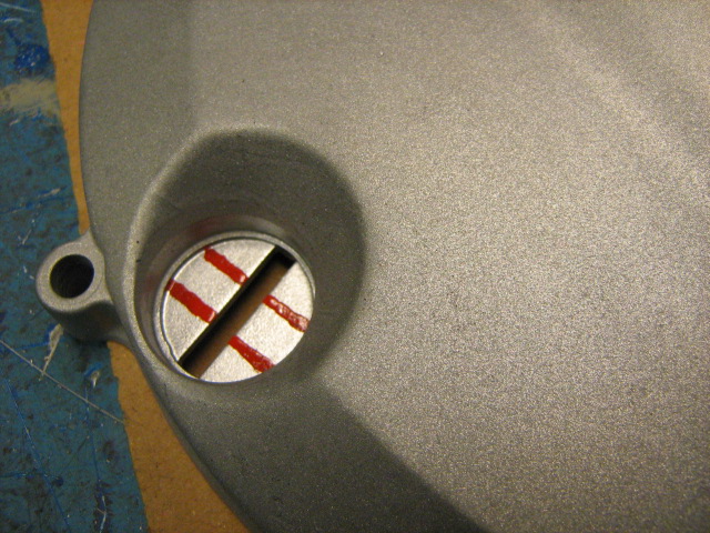

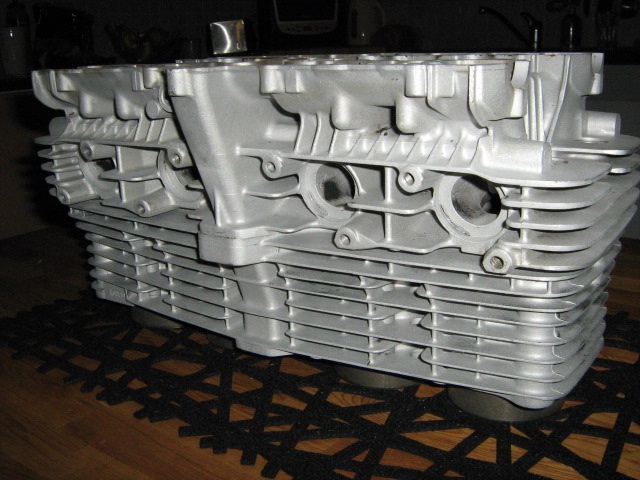

Got the cylinder and cyl.head blasted the other day..
Also a new level indicator on the clutch cover..
Soon the re-assembly will begin !

Got the cylinder and cylinderhead painted.
Now I plan to mill down all the fins.
Got a small package that I totaly forgot about.
My Kawa-logos !!

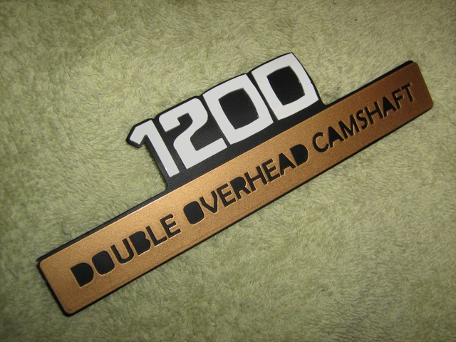

Some more detail work:

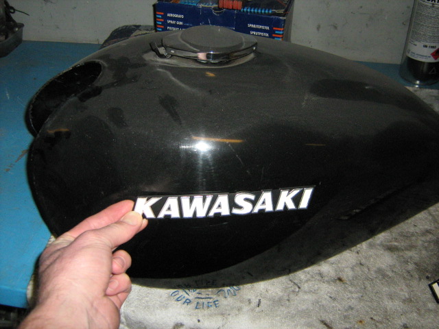

What do you do when your building a z900 clone and need a side emblem for 1200 cc ?
You make your own :woohoo:

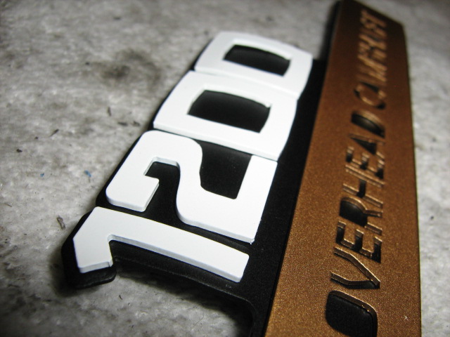

And the 3D effect:
Your feed back is what keeps me doing that little extra...
And the 3D effect:

what kind of paint are you using there?
