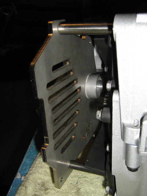

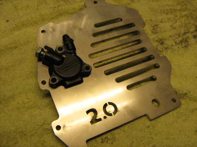

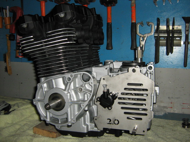

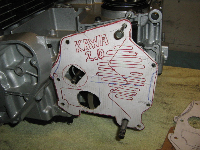

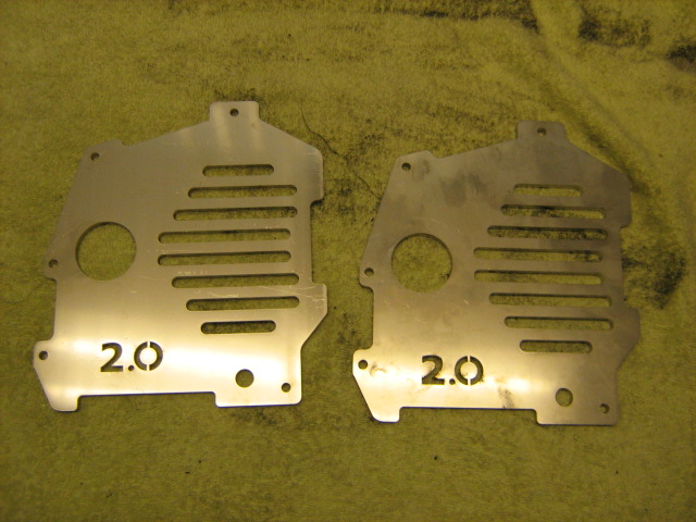

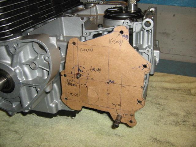

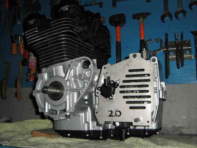

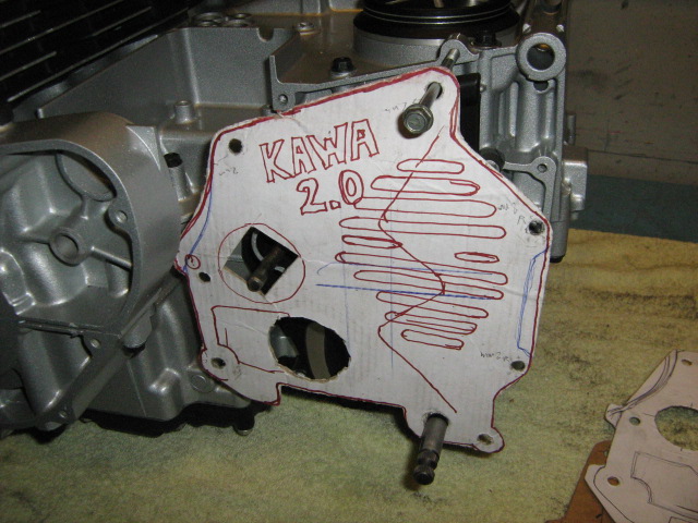

Hey Guys,
This is what I came up with:
Template 1:
Template 2:
Might as well cut two out in the lasercutter
Slave cylinder from Kawasaki GPZ 900 R -89

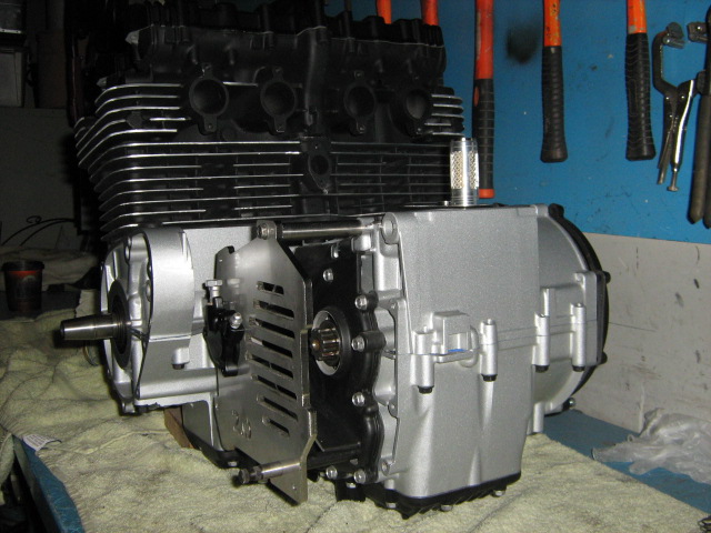

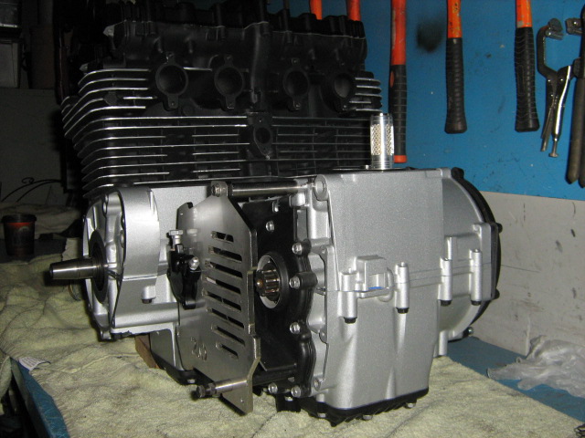

Test fitted:
Need to mill some nice distace bars and might paint the plate black. :whistle:
Template 1:
Template 2:
Test fitted:

Re: Retro Fighter 2.0 (KZ 1100 -82 goes Z1 clone)
20 Feb 2013 21:00
Looks great! That laser cutter must be a great tool. How do you input the dimensions for whatever part you're making? I'm guessing you draw it with a CAD-type system that includes all of the dimensions and then it will cut what you have drawn? I've heard that they have these "3-D copiers" now that literally copy and produce whatever part you have but I think they're only in plastic.

- Posts: 7442
- Thanks: 797
21 Feb 2013 11:07
super cool arnold.
i love the industrial look of them. :evil:
are they steel or aluminum?
21 Feb 2013 12:53
Is that a ZRX slave cylinder for the clutch? I bought one a few years back to do that conversion....haven't quite started on that project yet :whistle:
21 Feb 2013 12:5679MKII wrote: Is that a ZRX slave cylinder for the clutch? I bought one a few years back to do that conversion....haven't quite started on that project yet :whistle:
cheers
21 Feb 2013 19:58
Thanx guys,
To cut the shape out in a laser cutter you need to make a AutoCad-drawing and convert it into a dxf-format. The machine will then read this file to get the shape and you set the starting point for each contour and press play
The plate is cut from 6 mm stainless steel (316 L)
The slave is from a GPZ 900 but might also be used on early ZXR´s
