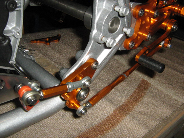

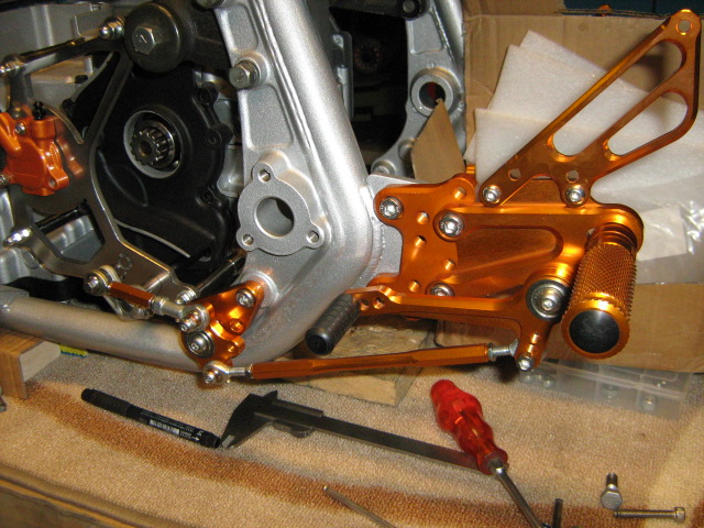

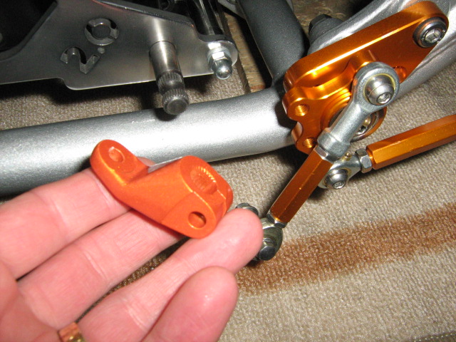

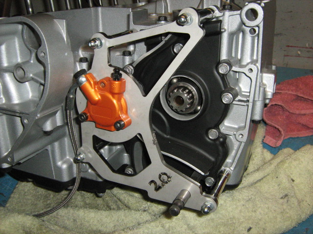

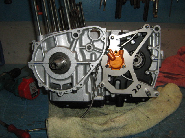

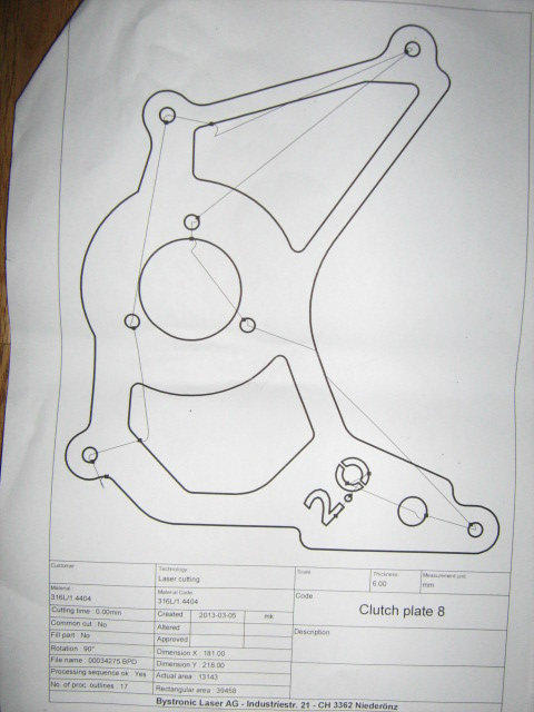

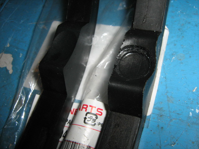

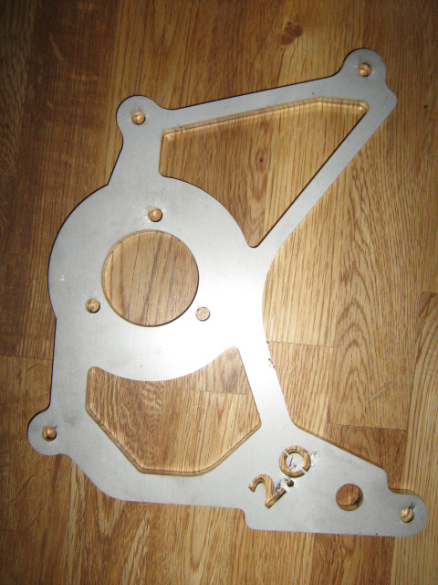

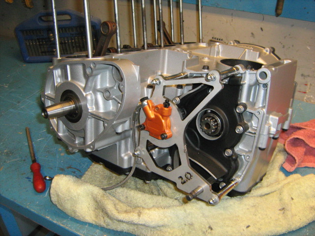

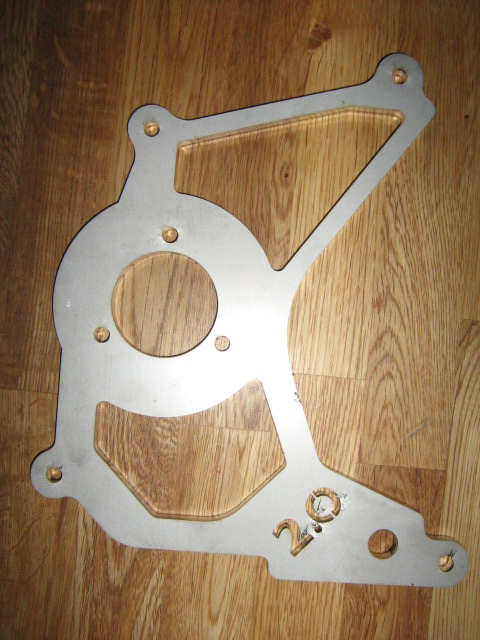

Hey ya all,
Got my new clutch release plate made today. Feels good ! :lol:
Some polish on this and Bobs your uncle.

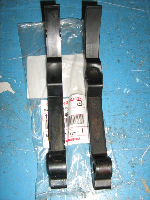

Also swapped the chain tension guide.

Re: Retro Fighter 2.0 (KZ 1100 -82 goes Z1 clone)
25 Mar 2013 15:00 - 25 Mar 2013 15:03

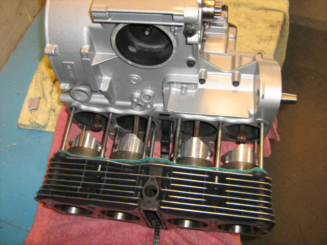

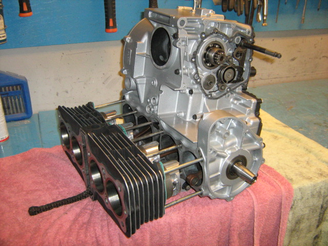

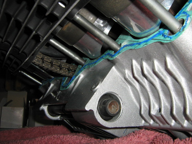

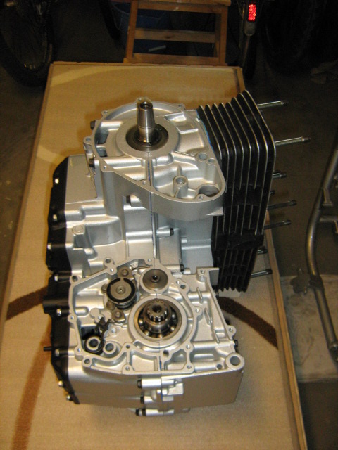

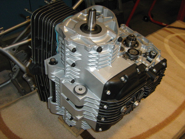

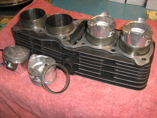

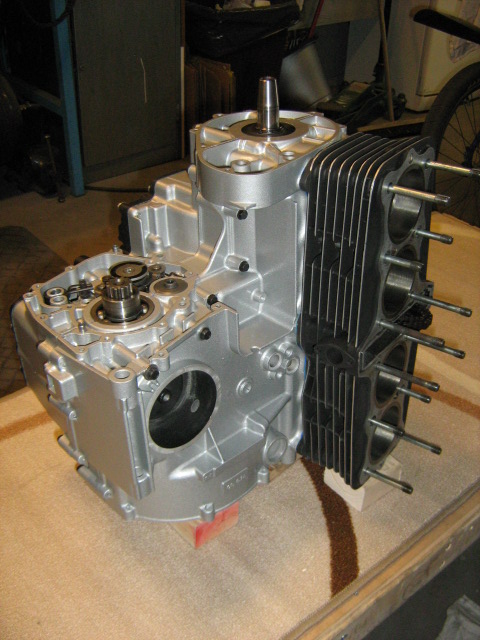

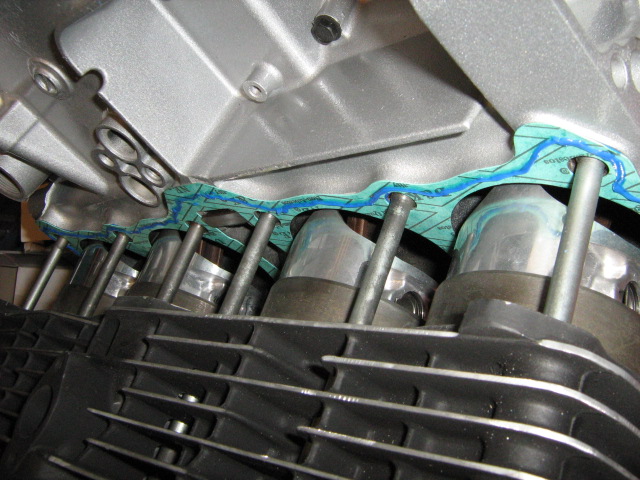

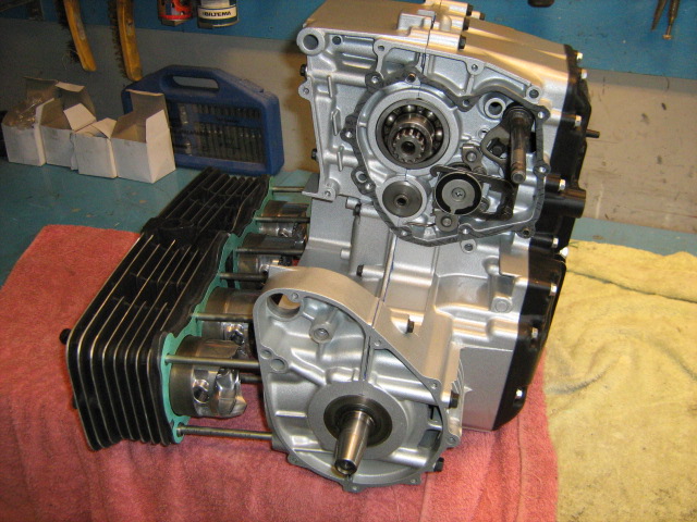

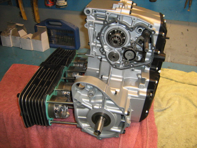

I then got new pistons and rings assembeled and stuck the cylinder on.
Didn´t go the conventional way..but first connected the two piston rods (in down position) and then the other two while the pistons were sitting in the cylinder. I find this way easier

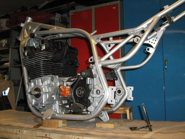

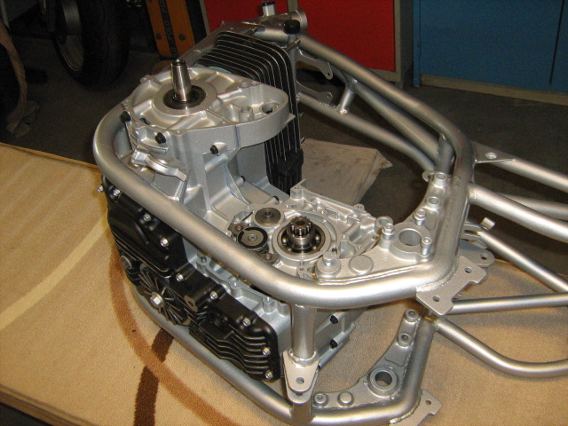

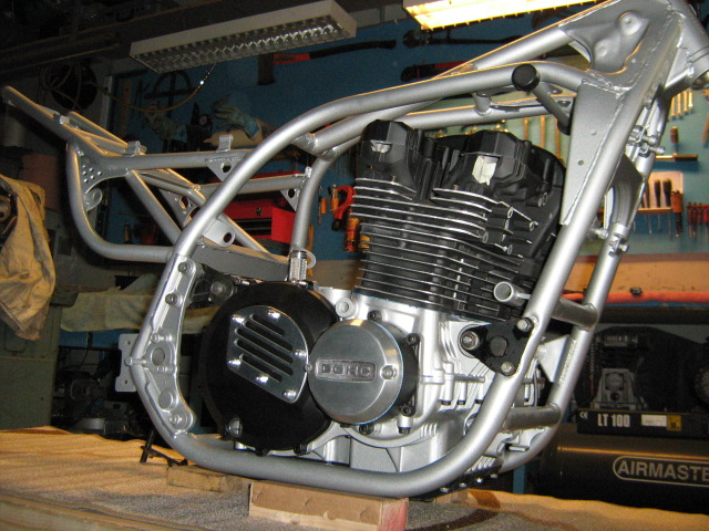

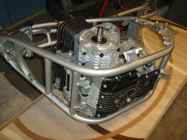

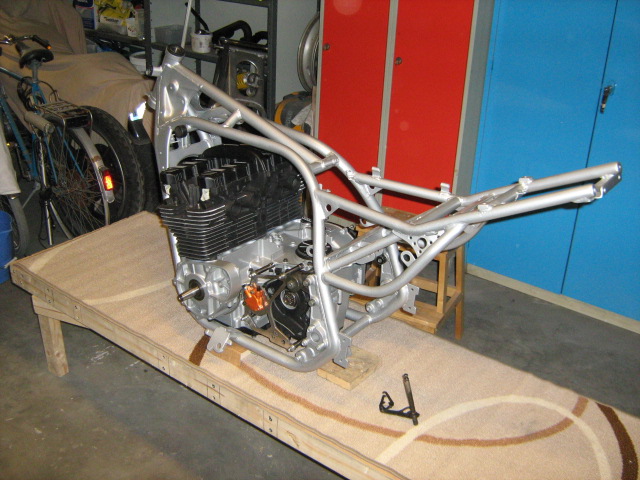

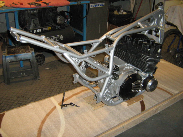

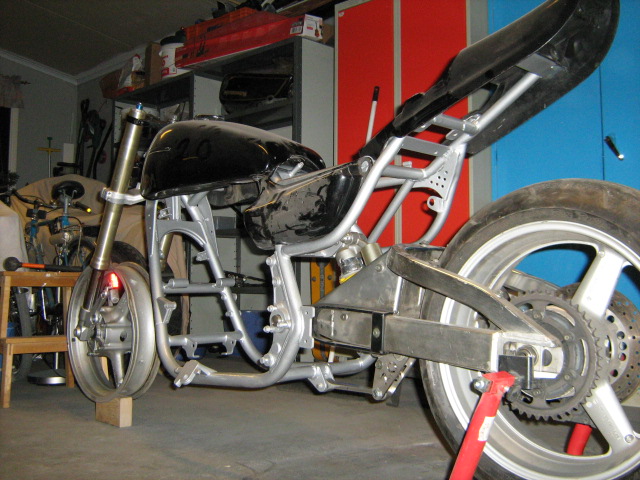

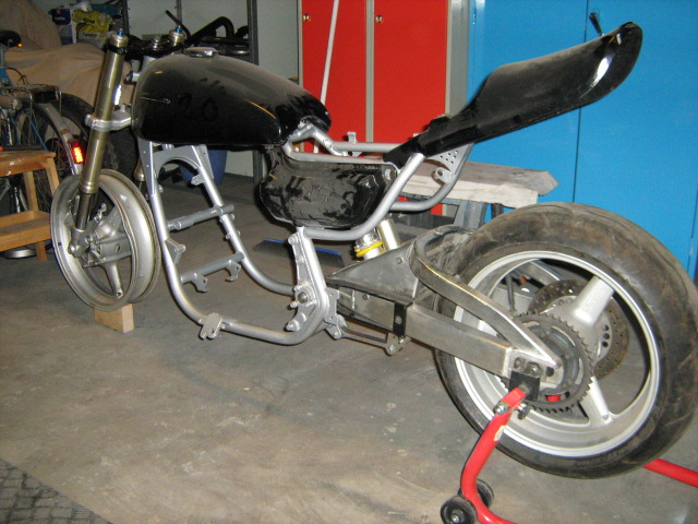

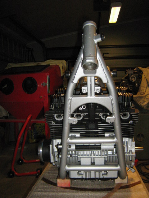

Got the engine in the frame:

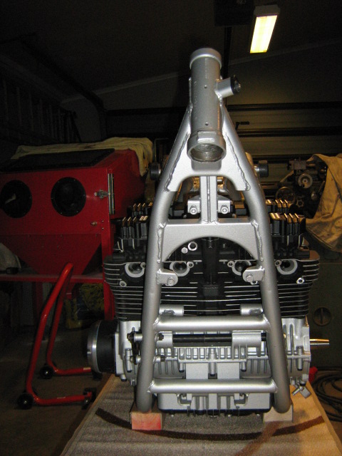

02 Apr 2013 18:08
Looks great. I love that "lay the frame over the engine" trick. I'm definitely doing it that way on the next one!
03 Apr 2013 17:08
Thanx guys !
79MKII: I wasn´t even close to scratching the frame...and I lowered the frame over the engine by my self. You can take a pause and then mount the bolts. Def. the best way to do it.
