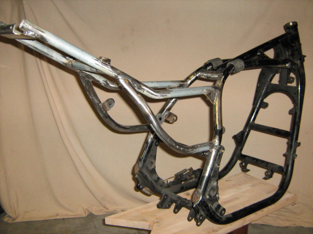

One more frame pic:

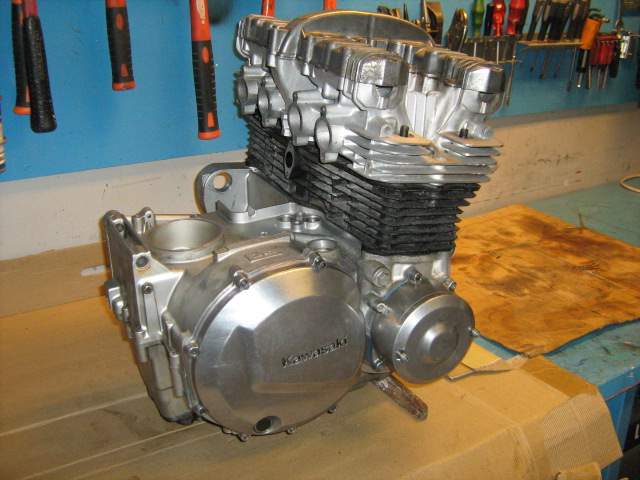

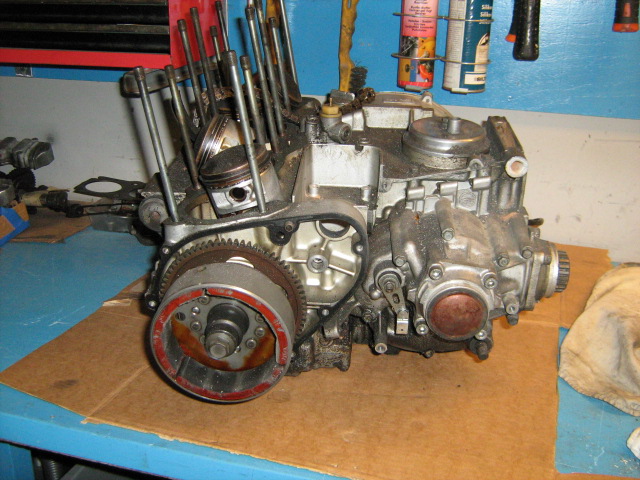

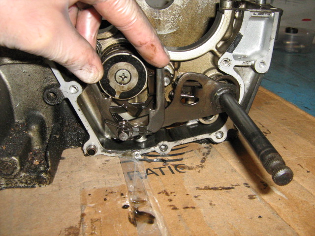

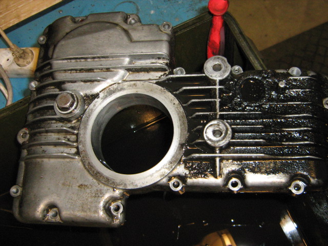

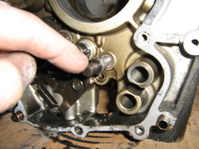

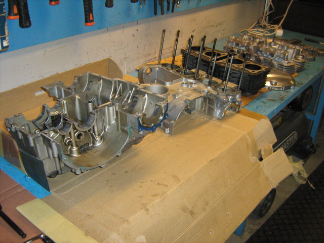

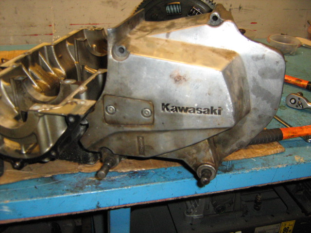

Ok guys, next job up is to do the "Shaft to chain conversion".
Check this baby out ! A guy called Bill aka Mustapha dump gave me a detailed description on how to to the job.
This was his words: "Converting the shaftdrive motors to chaindrive is a very simple operation, just swap out the outputshaft for a chaindrive one, and fit the sprocket backplate in place of the bevelbox, and move the gearshift claw mechanism into the second hole and change the spring pin position over to the adjacent threaded hole, job done. Takes a lazy afternoon on the spanners to sort it out."
Engeine before conversion:

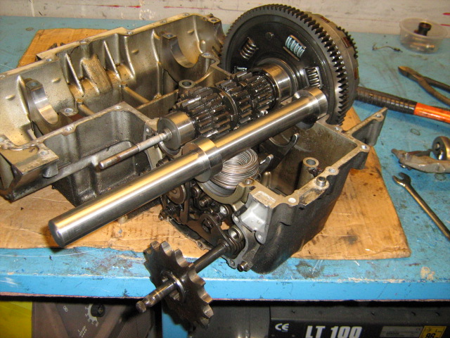

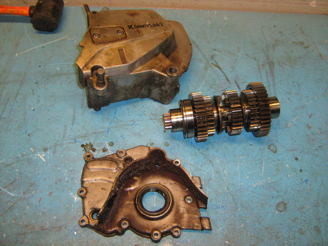

Parts needed: (Here from a GPZ 1100 -81)

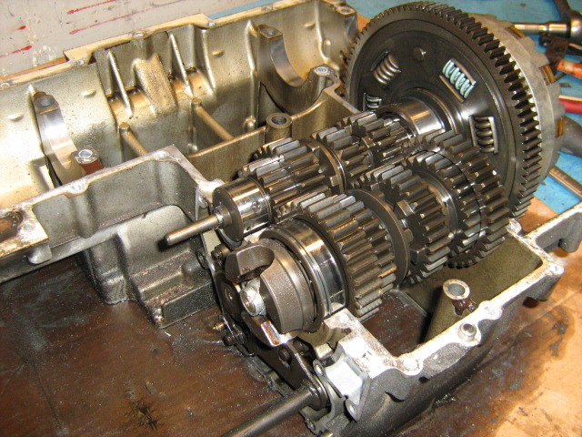

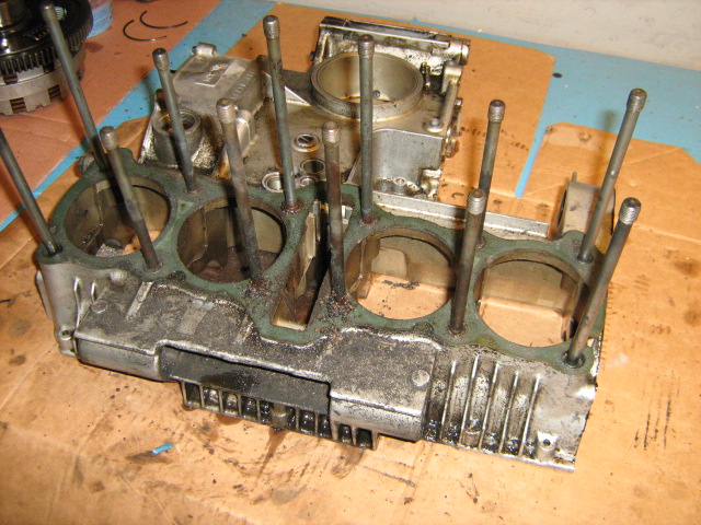

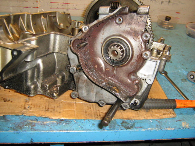

Split the case:

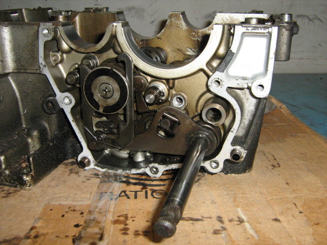

Remove the gear shift mechanism: (open the claw and pull it out)

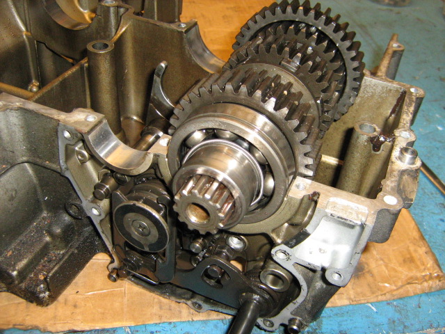

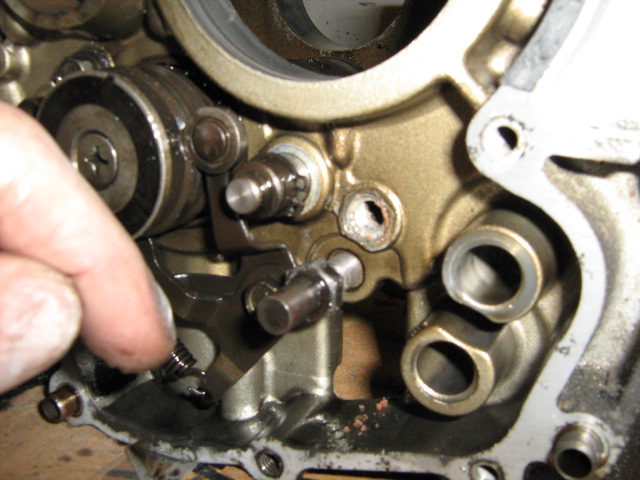

Unscrew the spring pin:
Insert the spring pin in the lower hole:
Insert the gear shift mechanism into the lower hole:

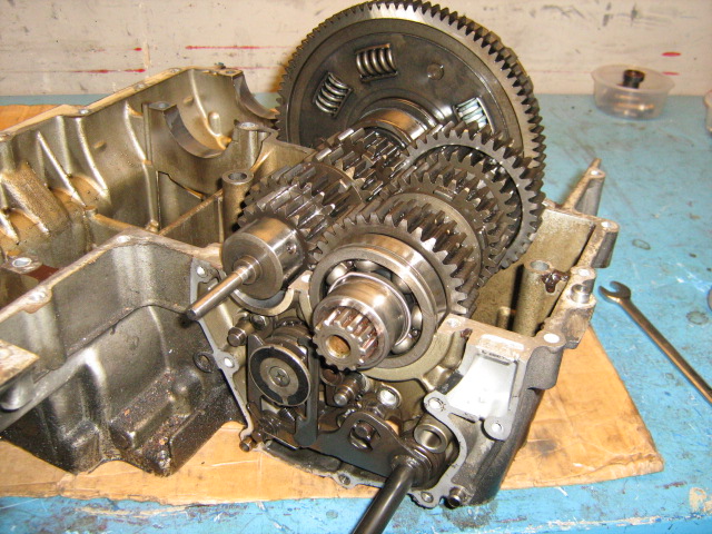

Install the new chain drive output shaft:
Install the clutch basket shaft:
Install the back plate:
Install sprocket and clutch cover and Bill´s your uncle

- etbike3135
- Posts: 379
- Thanks: 50
Re: Retro Fighter 2.0 (KZ 1100 -82 goes Z1 clone)
08 Oct 2012 18:38
If you dont use the shift drum from a chain drive your going to have a problem. You are going to find your not shifting all the way into gears. Like 4th, it will pop right out while your driving.
I would use everything drum, shift lever and anything elese I could take out of the chain. Been there done that!
The pins behind the end plate on the shift drum are clocked different for a chain motor or shaft. Think about it, you just moved that lever into a spot nearly an inch away. Is it going to travel the same distance at the same starting point as it did in its original spot?
