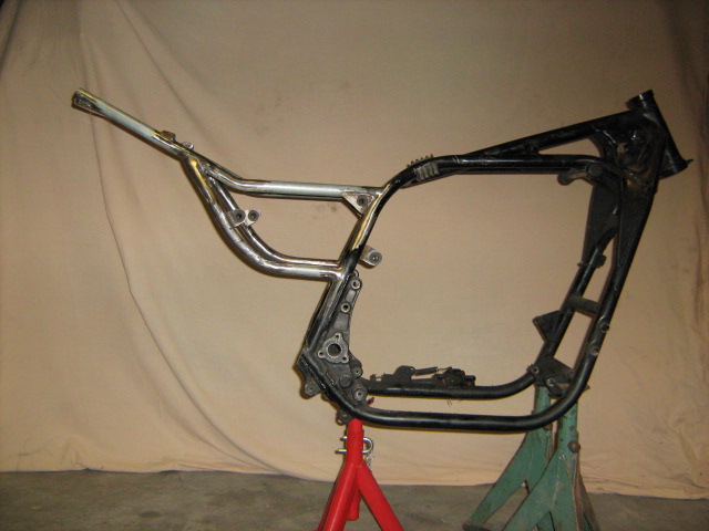

Yepp, sharp eye...the pic is from my KZ750 that I rebuilt some years ago.
The sub frame will hold up...will reinfore it with some sheetmetall.

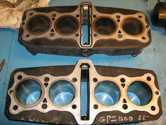

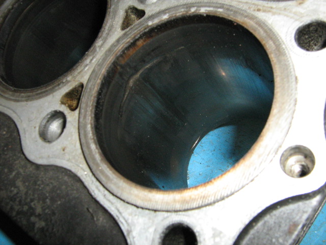

Pulled the KZ 1100 engine apart and saw that the cylinder was changed for a 998 cc. :ohmy:
So I called the scrap yard and ordered a 1098 cc one. When it arrived I discovered that one sleev was seriously damaged. My plan was to bore it up to 1170 cc anyway but the qustion is: Will a bore from 72.5 mm to 75 mm (2.953") clear this damage ?
The force from the damage also moved the sleev out of it´s socket...
My options are to get a different cylinder from the scrap yard or get 80% money back.
So if the damage get fixed with a bore then I´m better of getting some money back for it since I would bore it up anyway.
Anyone know far you bore it up when using a WISECO 1170cc big bore kit ?

Long story short:

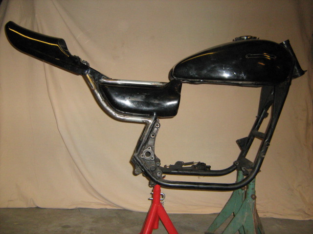

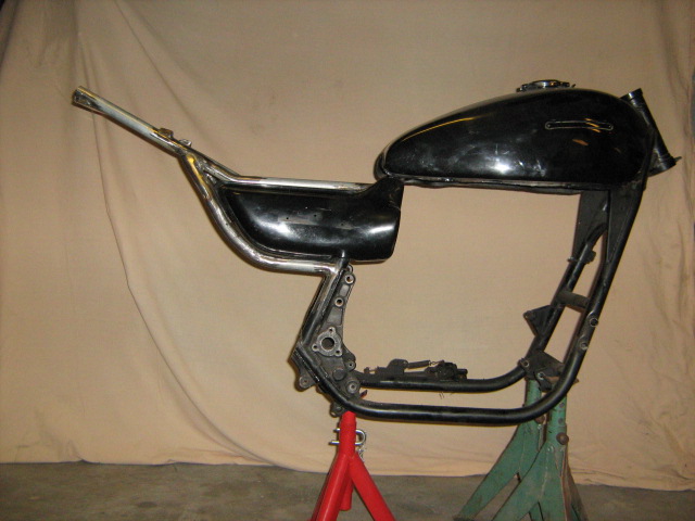

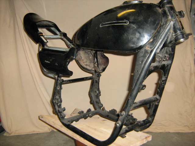

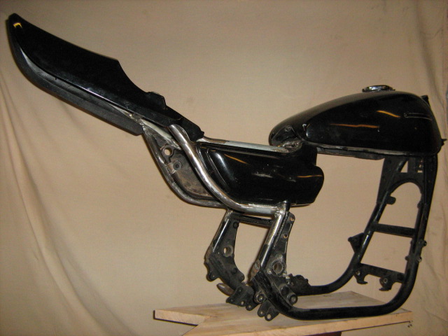

Update: Subframe done !
After some serious adjustmenst back and forth I´m 90 % happy with the outcome.
Will now go on with swing arm, forks, engine, electrical....

Only difference i might have gone with would be to hide the subframe tubing behind the side panels, but it looks amazing this way too!

Thanx Tusch,
Ha..ha...to have the tubes line along the side panels was not negotiable. It will look nice when the frame in silver boxes up the side panel i bronze/gold. But thanx for the input !
the cylinders should clean up no problem....

Turboguzzi...took the cylinder to a specialist today and he said now way.
The damage is to deep, needs a new sleev to make it work.

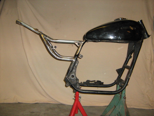

One more frame pic:
