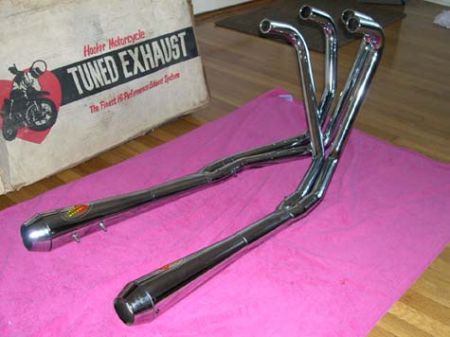

Reminds of the Hooker Headers, which once were available in 4>2 and 4>1.

Patton,
That HH setup is sweet! I think it'll look nice. Was considering running two, stack with a radius 2 into 1 collector into the mid pipe. Kinda like half of the factory 4 into 4. I decided against it after playing with photo shop. Like I said, will move it up like a high mount at an angle.
