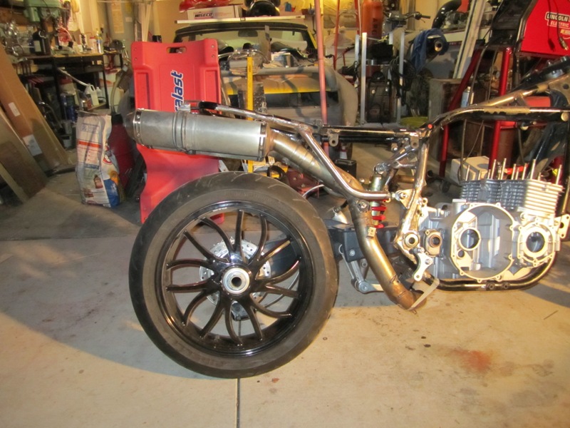

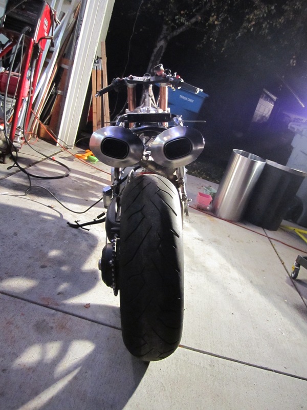

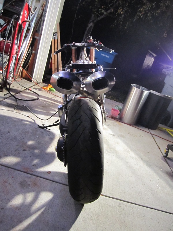

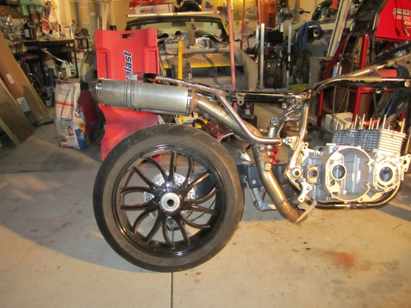

Ok, here is where is gets iffy and people are going to love :woohoo: my idea or absolutely hate it! :sick: I have been wanting to do this and this bike is perfect for it! Will take some fab work and changes, but my bike may becoming a Ducasaki!
Undertail exhaust.... Yeah Baby! Now proceed with the verbal flogging! Let me have it!!!
Cory

31 Aug 2012 00:43u may need to reverse the cans to gain tire clearance, but i like it.
Cory, notin like a little heat under ur but on a cool morrnin.
