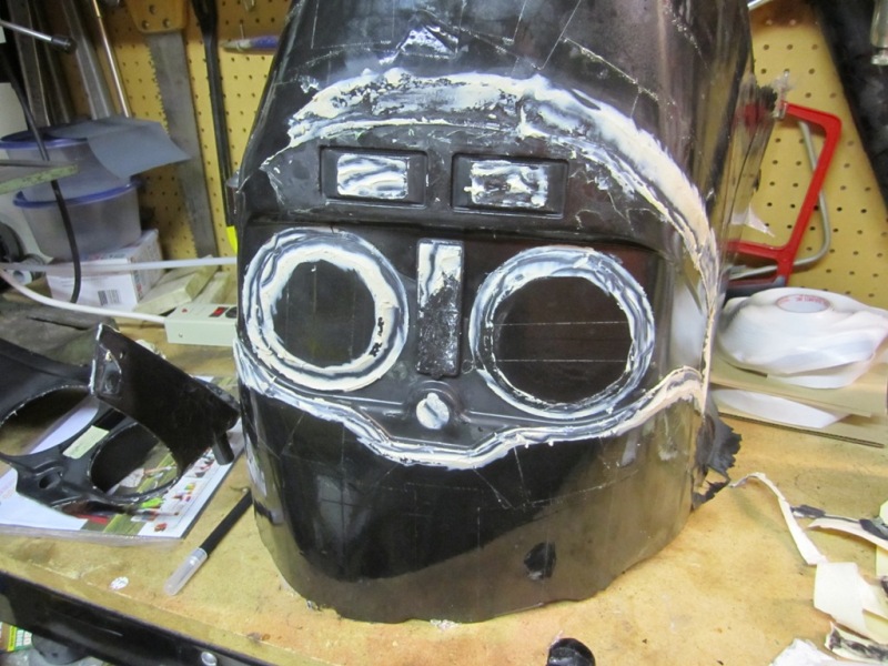

The heavier weight fiberglass cloth doesn't like to conform to the tighter radiuscorners/edges' of the mold. So with a healthy layer of lighter weight cloth, I mixed some fast resin with high density filler to make a thick paste. I used a cut down body filler spreader to fillet the corners. It doesn't look pretty, but it doesn't have to. Once I lay some glass over it and saturate it with resin, it'll smooth out.

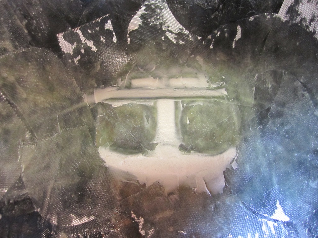

It really doesn't look all that different, it just has more layers of fiberglass.
For the ultimate in mold strength and longevity, I would use carbon cloth instead of fiberglass, but my pockets aren't deep enough for that! :sick: Lets see, $30 a yard, 3-4 yards of material.....yeah, too much money to make a mold out of carbon. Now $4 a yard, thats more my beer budget :laugh:

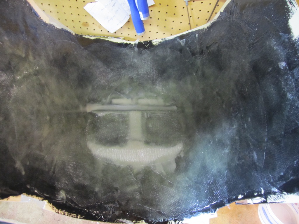

Wow, the resin cured a little faster than I had anticipated, so I was able to strip the mold this evening. After pulling the flange, all I could think was it looked like something out of Star Wars :laugh:
