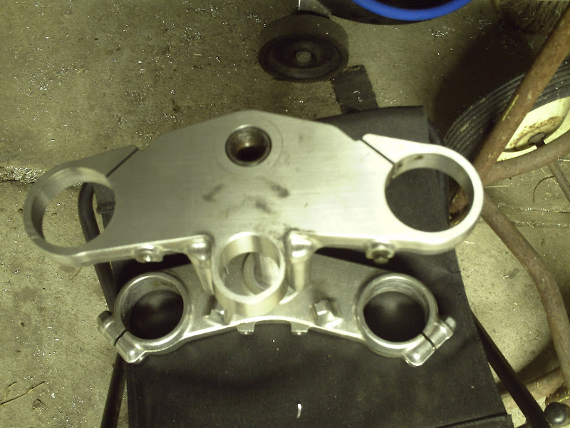

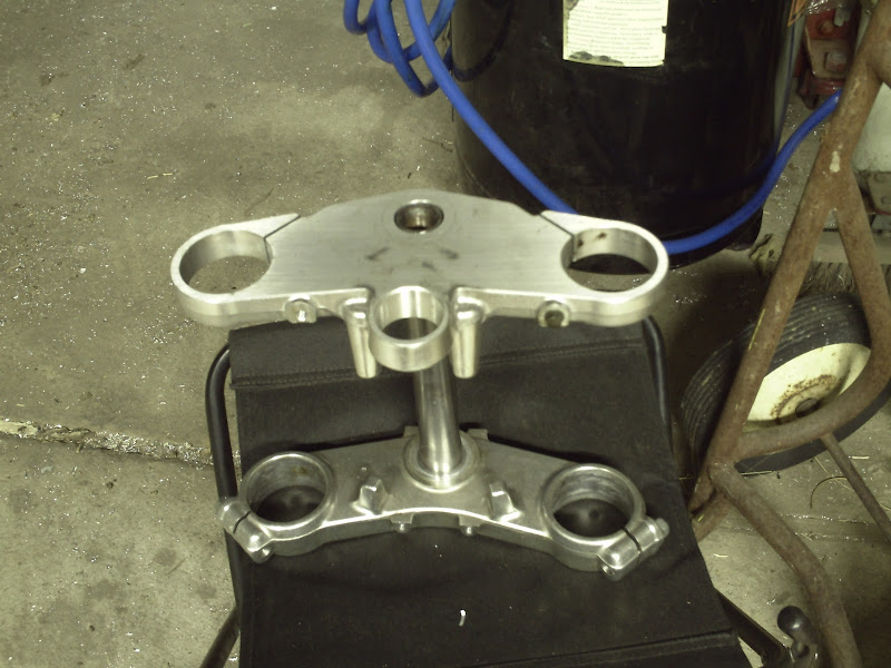

now it has nice slip fit,
all pieces fit together.
i have ordered some material to build the bar clamps out of,it should be here in a couple days.i still need to weld the stem in,and cut some pockets in the underneath side of the upper triple to get a flat spot to bolt the risers.
we're getting there
we're getting there

looks great Leon. now im green as they come, so if you like, just tell me to shut up....
would it be easier to weld the risers to the top of the clamp and tap holes for bolts thats the bar clamps can bolt though?

kz1k wrote:
easier?maybe,negligible.
but if we machine and bolt them we can always build different ones and just bolt em on if you decide we need something forward or backwards or taller or shorter
