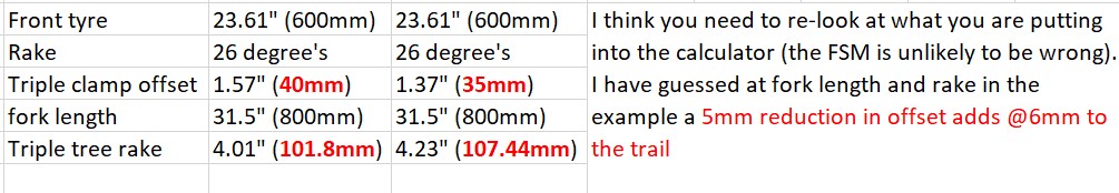

30 Oct 2023 02:43 - 30 Oct 2023 03:28According to that calculator, the current trail of my bike is 4.32in, or 109.7mm. What's strange is that my FSM says that the trail is 104mm, which is what I've been going off of this whole time. So I'd be very curious to find out how Mama Kaw is measuring trail compared to everyone else.
Calculating the trail of the new forks I'm getting 4.07in, or 103.4mm. This includes the 10mm drop I've already drawn into the top triple. A difference of 6.3mm.
Now, what got me going down this rabbit hole and seeking this understanding was because I was curious if increasing or decreasing the triple tree offset could correct the difference in trail. I calculated a 35mm offset instead of the stock 40mm, and the difference in trail dropped down to only 0.8mm Reducing offset increases trail). I had hoped this might be a viable method, but checking with my 3D model, I can see that it would cause the fork caps to touch the handlebars. 3mm is about the maximum amount I can decrease the offset. The difference in trail would then only be 2.794mm. Might still be worth doing though, what do you guys think?
You need to factor in that shorter forks will reduce the "rake" angle which will shorten trail, the best advice I can give is to extend the forks to "stock" length (somebody way cleverer than me could probably calculate the rake change with shorter forks but would need a lot of data) and once the tree's are cut there is no turning back. As I said previously sticking with "stock" "fork length" and "offset" will take the guesswork out of it and you can simply replicate the stock tree's (with the holes further apart) to get the correct spacing between the forks

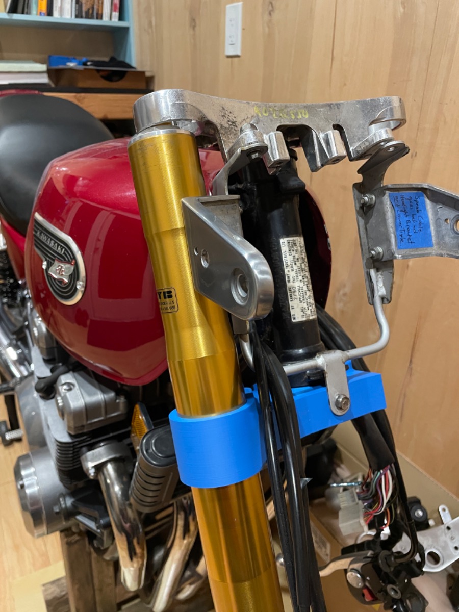

Kind of an exciting update on this project. I got the first 3D printed prototype part made and mocked up. Overall I’m pretty pleased, there’s some changes that need to be made, but they’re relatively minor and should be easy to do.
The prototype only has as much as necessary, which meant cutting off one of the fork clamps. Turns out the part is too big to 3D print any affordable way, but chopping it down like this made it cheap.

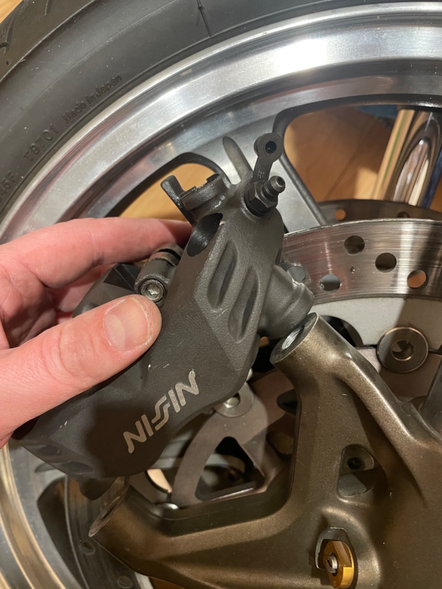

Now for the bad news. It looks like I’m gonna have a challenge with brake calipers/rotors and getting everything to fit and line up. Again, the forks are ‘03 ZX6R, and all my research says that ‘07-‘08 ZX6R Nissin calipers are a direct swap and a better caliper, so that’s what i got. However the offset between the brake caliper bolts and the rotor center is way off in this case.
I thought maybe the ‘03 rotors have more offset built into the rotors, but looking at photos they appear to be even less offset than my Zephyr rotors. So I think the ‘03 front wheel hub itself must be wider.
At this point I have no idea what to do about this issue but I’m open to ideas.

11 Nov 2023 02:06 - 11 Nov 2023 04:08The offset on all these dished Kawasaki rotors is the same at around 15mm whether they are 310 or 320mm dia.
The discs on most radial equipped bikes are plain flat though..
The usual solution is to fit disc spacers and longer bolts.

Agree with Zed on the disc spacers (they must however still locate on the centre hub so you might have to get creative with the spacers) since you haven't cut the trees yet is there an option to reduce the spacing and bring the forks closer to the wheel? Possibly even a combination of spacers and bringing the forks closer? Looks like you need to find approx 8mm each side

I think spacing the forks closer together might be a possibility, I’ll have to look into it. I know it will be complicated around the speedo drive, but as I’ve said before I might just have to lose that altogether anyway.
Thanks for the suggestions on making spacers for the rotors, seems like that would be an easy part to design.

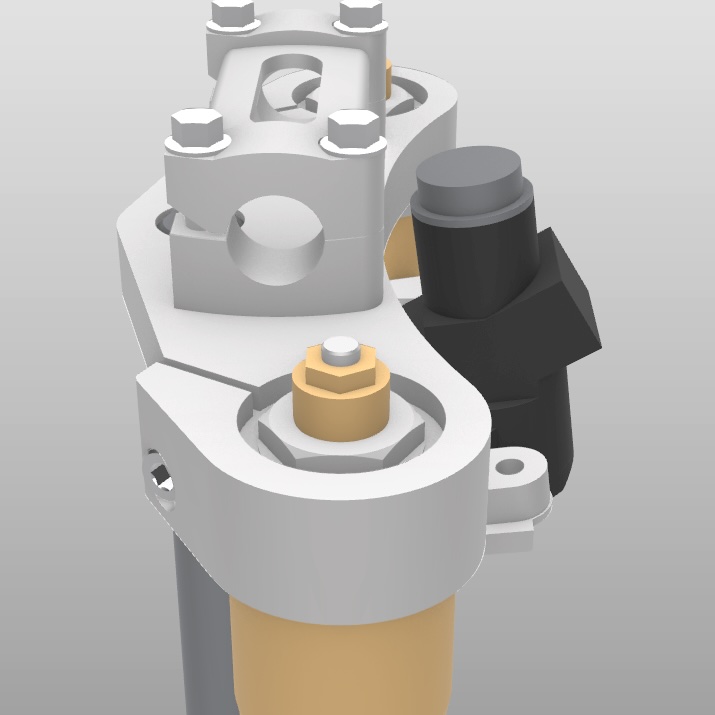

1. Without going too deep into the "why" I came up with this idea, one thing I'm considering doing is making the upper triple flat on the top, with the 10mm drop still there, and a ledge where the top of the fork hits like a stop. The clamp bolt still sits in the same place, and the cutout on top leaves enough room for a socket to break loose the fork cap. Here's a render to hopefully make what I'm explaining clear.
My question regarding this is does anyone see any reason not to do it? I do suppose it would be possible for rain water to get stuck in there, which could cause some corrosion over time. But we are talking about alloy parts, and there is still the slit in the clamp for water to drain out of. I think a positive aspect would be consistent fork height, rather than relying on your eyes to make the top of the forks flush with the top of the clamp, there's a built-in stop instead.
