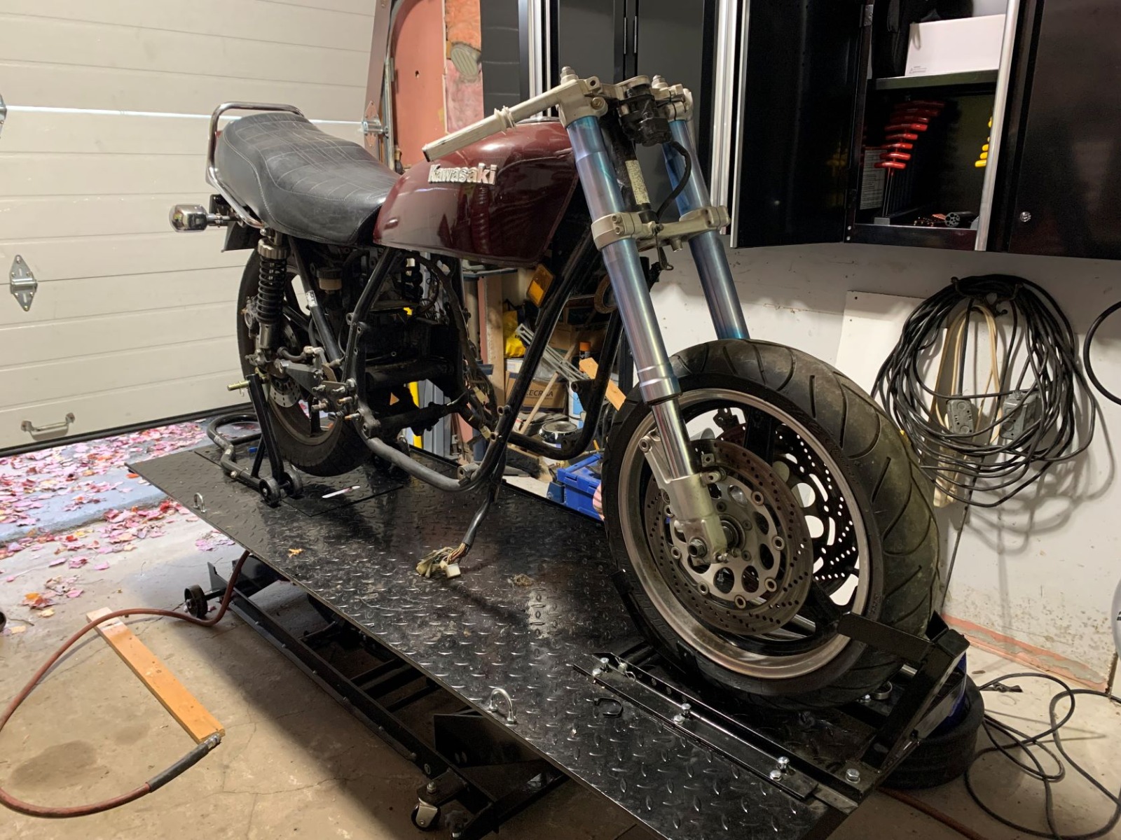

Hi supermotobobby,

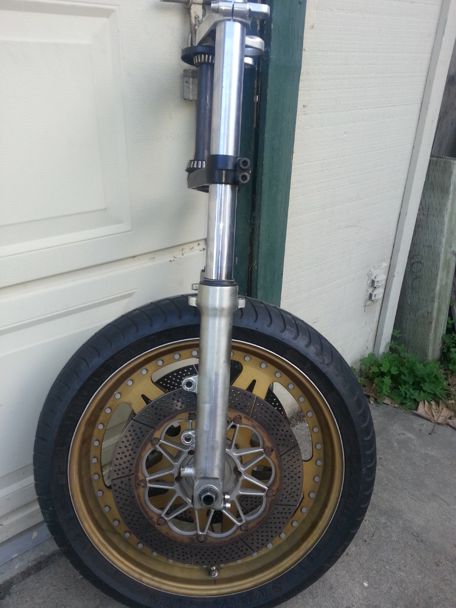

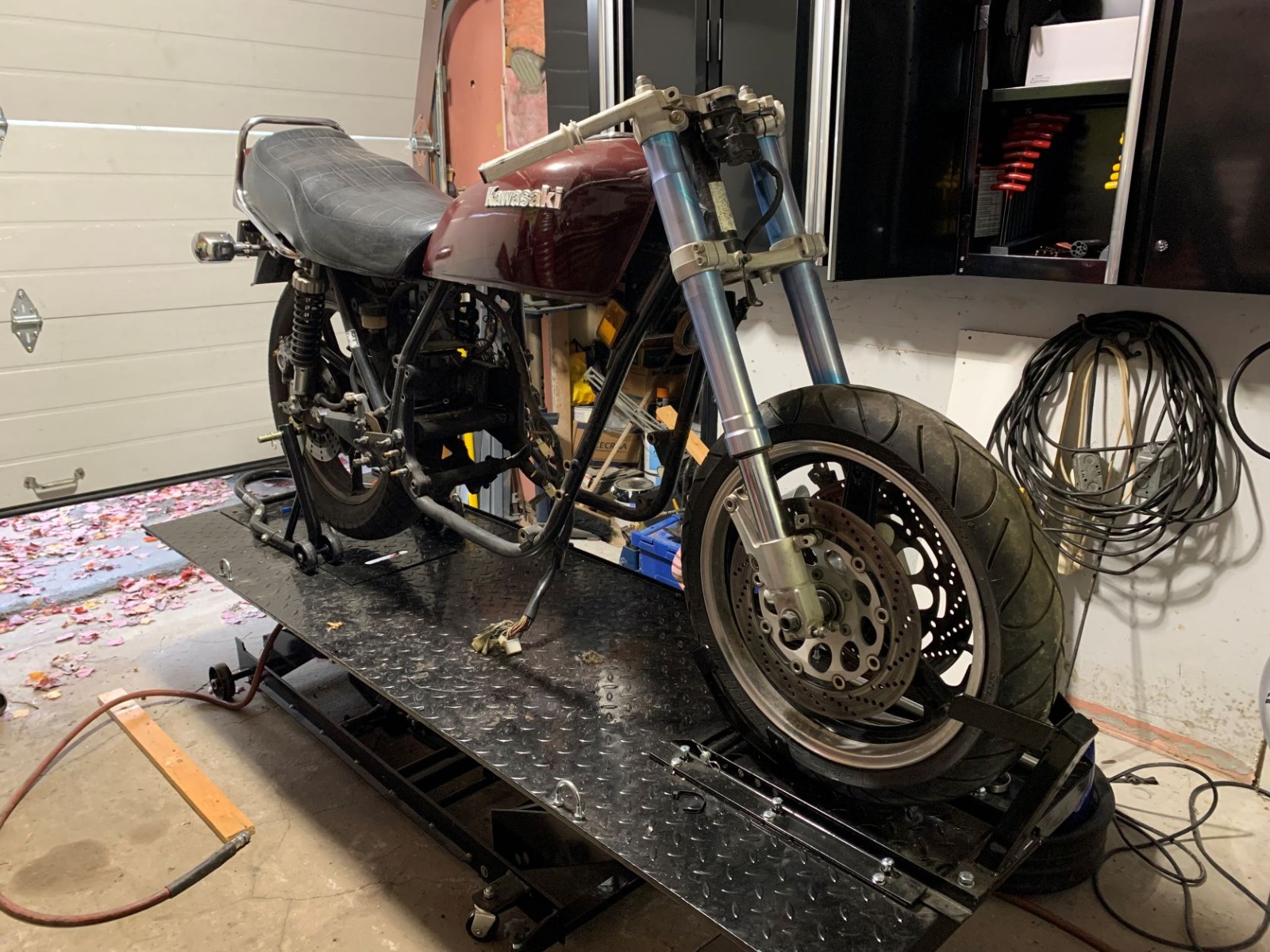

I am doing about the same mod to my '80 Kz750, '94 GSX-R750 complete front end swap, for start.
Here's the begining.

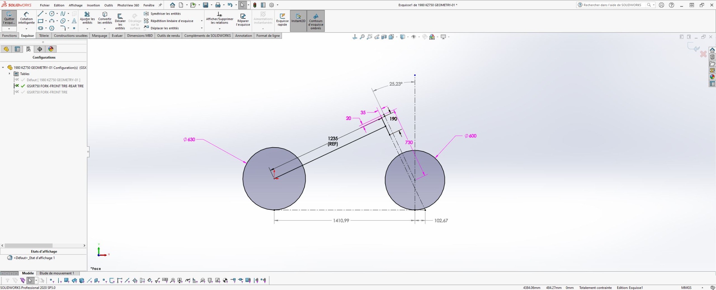

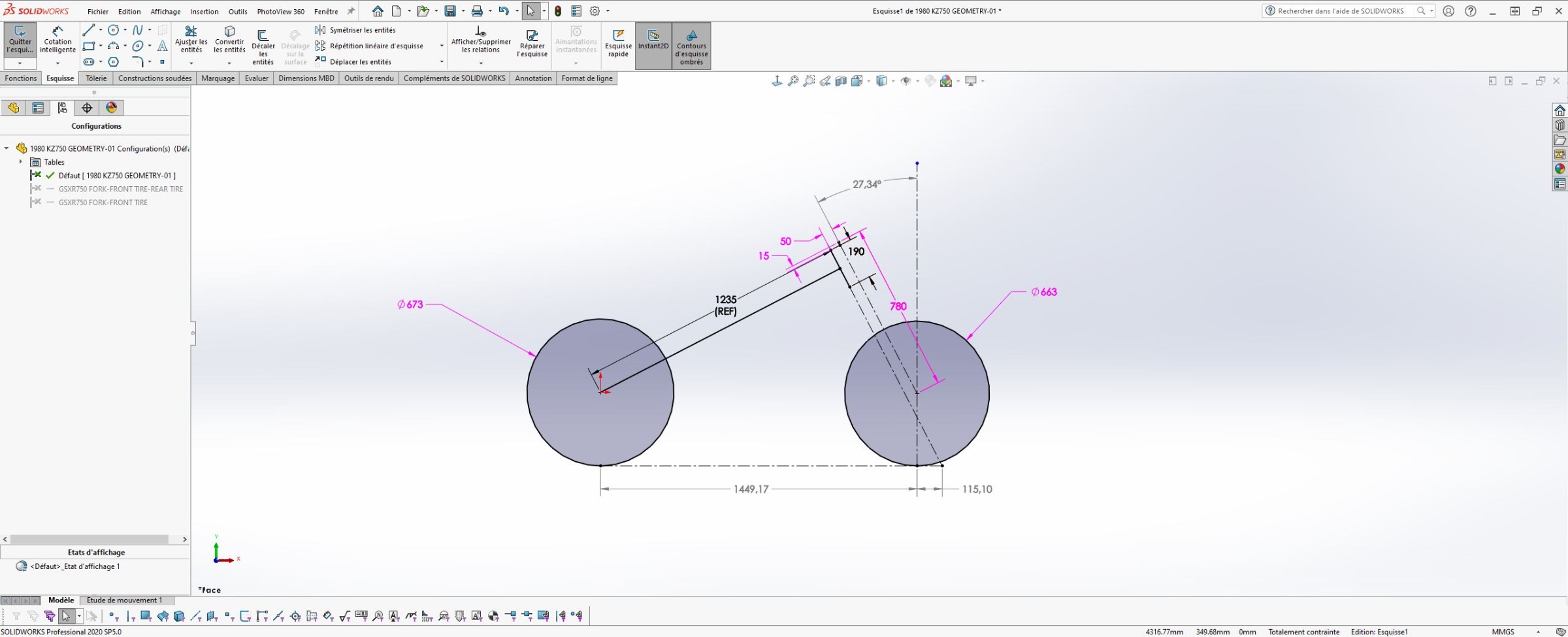

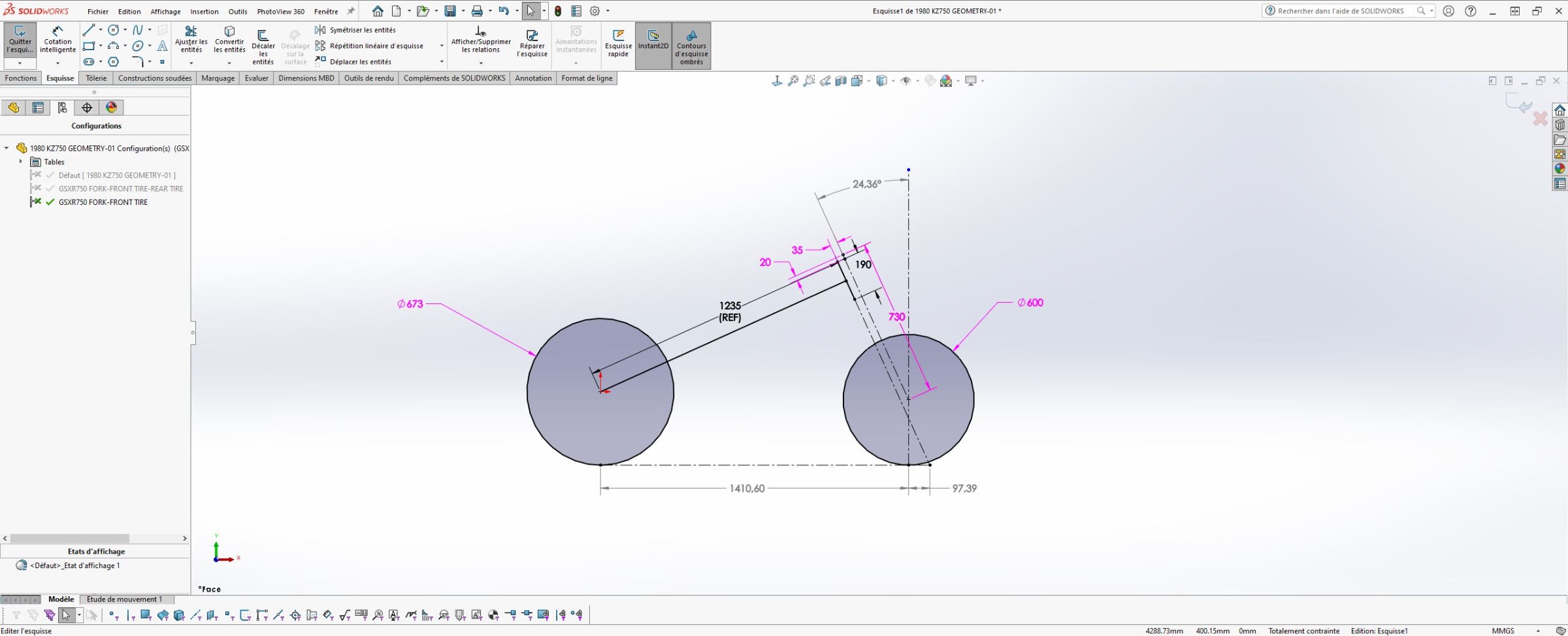

Re: USD Forks
19 Jan 2023 14:08
Hi Stereordinary,
These are te mesurments i took of my 1980 Kz750
As you can see on the left side of the picture with the green check mark what is involve.

Re: USD Forks
19 Jan 2023 17:14
Fascinating! So it looks like you measured everything out, and drew it to scale then you were able to calculate the difference in rake/trail right? Very interesting.
That’s been one of my major concerns is making sure I don’t ruin the handling of the bike.
Mostly what I meant was if you had measurements for like the stanchion diameter, overall length, axle diameter, etc. But this maybe even more helpful, so thank you.

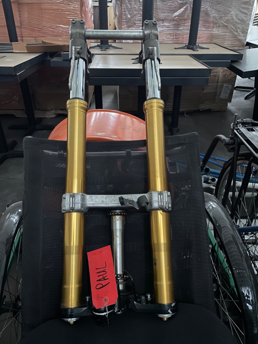

Started thinking again about how to fit USD forks on my bike. Took the advice/suggestion of B-K-Mod and started drawing dimensions out full scale. Haven’t gotten very far in that yet, mostly due to time restraints but also because I think one of my measurements is off, and I’m not sure which. More on that later, I’m sure.
But I also had this thought about how I have been obsessing over finding just the right set of forks. Like as if there is a unicorn set that would make the swap plug and play. But it just seems like that’s never gonna happen, so I asked myself well if I’m going to have to have a custom axle, and maybe custom triple trees made regardless, what forks do I really want on there? Like basically what forks do I think look the coolest? And then also, what kind of cost am I looking at if I open up the search like that?
Now, I would love to have been able to just plop down some cash on some brand new Öhlins or Showa forks, but I don’t have that kind of money. Especially when we are talking about an experiment that might not even work out. So I just kind of started browsing around eBay at used forks. First, I was pleasantly surprised that some of the prices were pretty cheap. Then somehow my search started coming back around to the same year/make/model over and over: the ‘03-‘04 Kawi ZX6R.
As luck would have it, a good looking pair in my price range was listed for sale by my local salvage yard, so I walked over and saw them in person. Offered to pay cash and saved even more money. So for $200 out the door I’ve now got a complete ‘03 ZX6R front end to mess around with.
