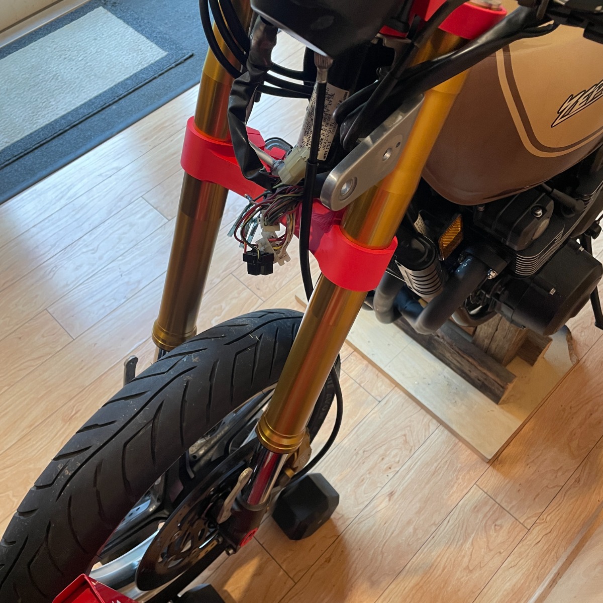

Just thought I’d update where I’m at with this project. I was busy with other things for a while, and waiting to hear back from Cognito Moto. But I’ve had a little bit more free time, and a bike in my shed for other service, so I am turning my focus back to it.
I decided to revisit Wookie’s suggestion of moving the forks in closer together to eliminate the need for any kind of rotor spacer. I had previously assumed that it would be too difficult to take the wheel in and out for tire changes. But then I thought, well how difficult are we talking, and is it still doable? So I moved the clamps in, making the fork-to-fork spacing 200mm.
It works, and it doesn’t. In order for the calipers to center on the rotors, I still need to move each fork an additional 2mm in. Also, the largest section of the fork (where the lower triple clamps) is now touching the headlight bracket, and causing it to flex inward a little. The good news however, is that the wheel is actually very easy to get in and out because the right side spacer now just fits through the lower fork clamp.
For the next revision I want to try moving the forks in that extra 2mm, but I also want to see if I can reduce the offset a little. This will do a few things, correcting the overall geometry, moving them away from the headlight bracket, and closing the gap between them and the fuel tank while turning full lock. Will keep y’all updated.

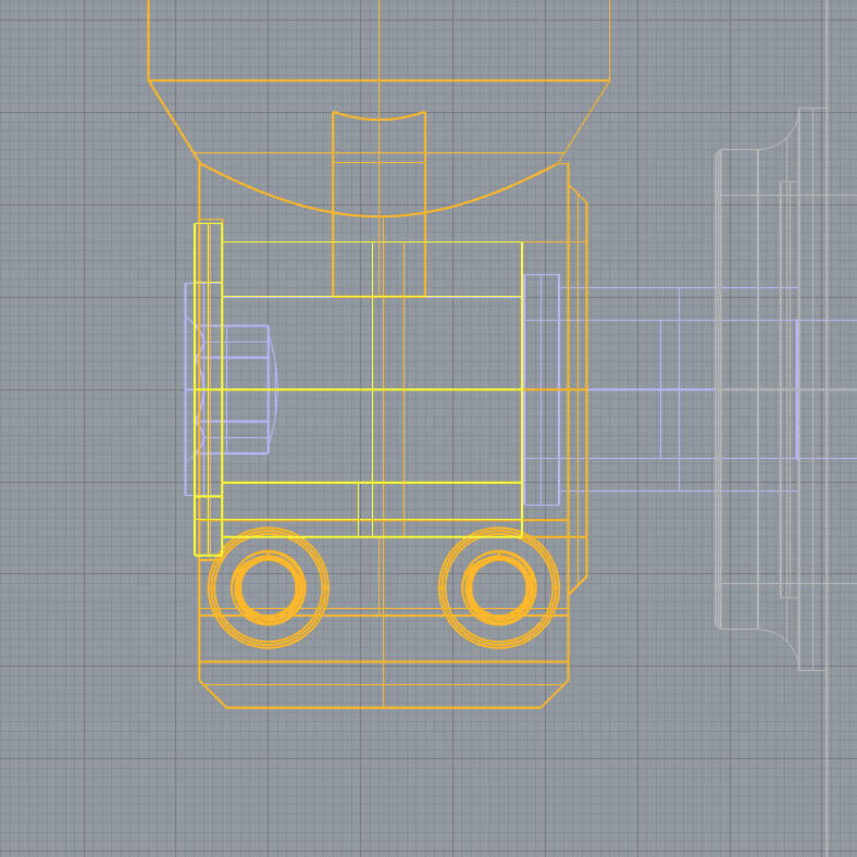

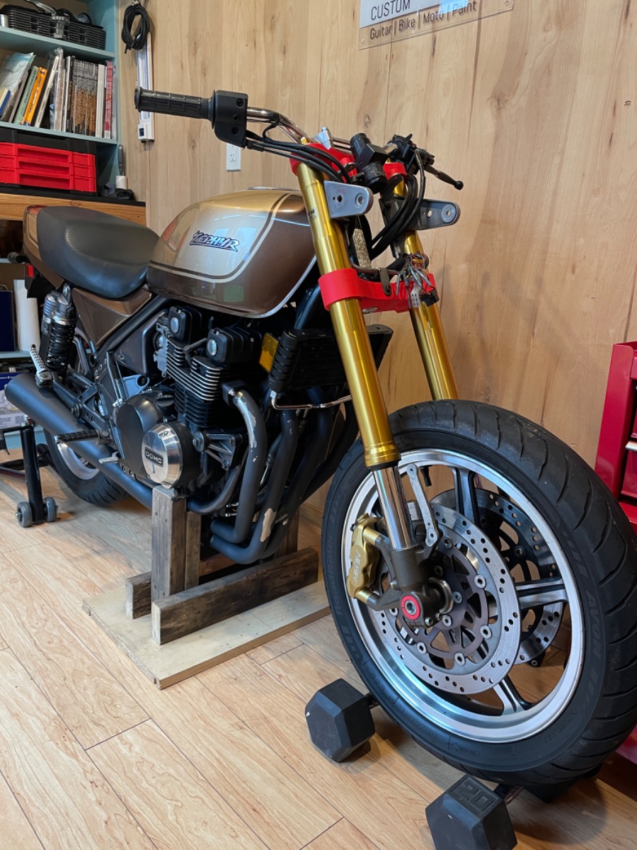

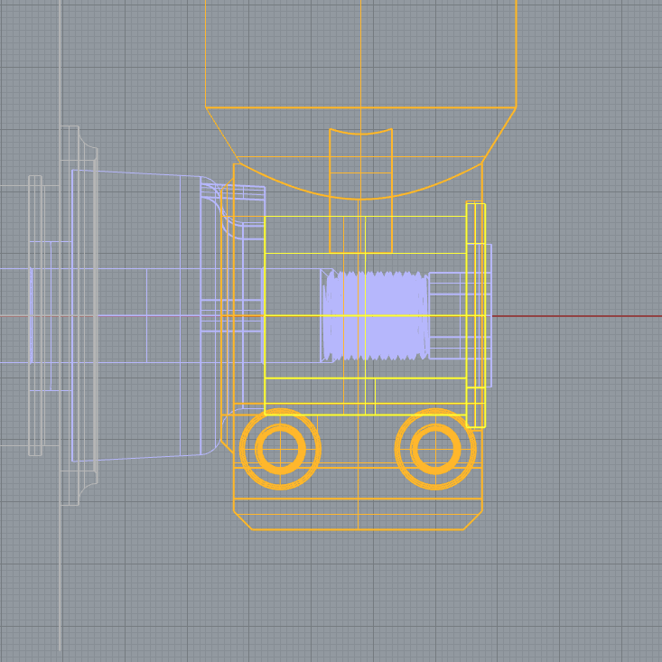

With all of this narrowing of the fork spacing (5+2=7 each side) I'm looking at the spacers that are needed to adapt the ZX6R forks to the Zephyr axle.
Quick recap, for those not caught up on this thread: We previously discussed changing the bearings to fit the ZX6R axle into the stock Zephyr wheel, and/or having the Zephyr wheel milled out to accept a ZX6R bearing. However I've just hit nothing but brick walls with both of those ideas. Bearing manufacturers don't want to say their bearings are sufficient for the job, and no one seems to want to mill a wheel (if there even is enough space). Plus there's the added complication of my preference for using the stock speedo drive. So unless some other answer comes up on those topics, I'm going to be making axle spacers.
Here is a screen grab of what the spacers look like (in yellow):
The fork lower is represented in a gold/orange color, and the Zephyr axle is the light purple.
My concern with this is that the spacer needs to be shorter than the total width of the fork lower by 7mm. A few mils and I probably wouldn't worry about it, but as you can see, it's sort of floating above one of the fork lower pinch bolts. I could make it the full length, but then I'd need to also make a separate inner spacer instead of using the stock one, and I highly doubt it would work at all like that on the other side where the speedo drive is.
So the question is whether or not it's ok to set it up like this. That inner fork lower pinch bolt is only clamping against so much material, but maybe that's ok? It does sit over the centerline of the bolt. Maybe I need to design a new inner spacer, and maybe the speedo drive can be modified? If it was milled flat on it's left-most side... (hard to explain in words)?

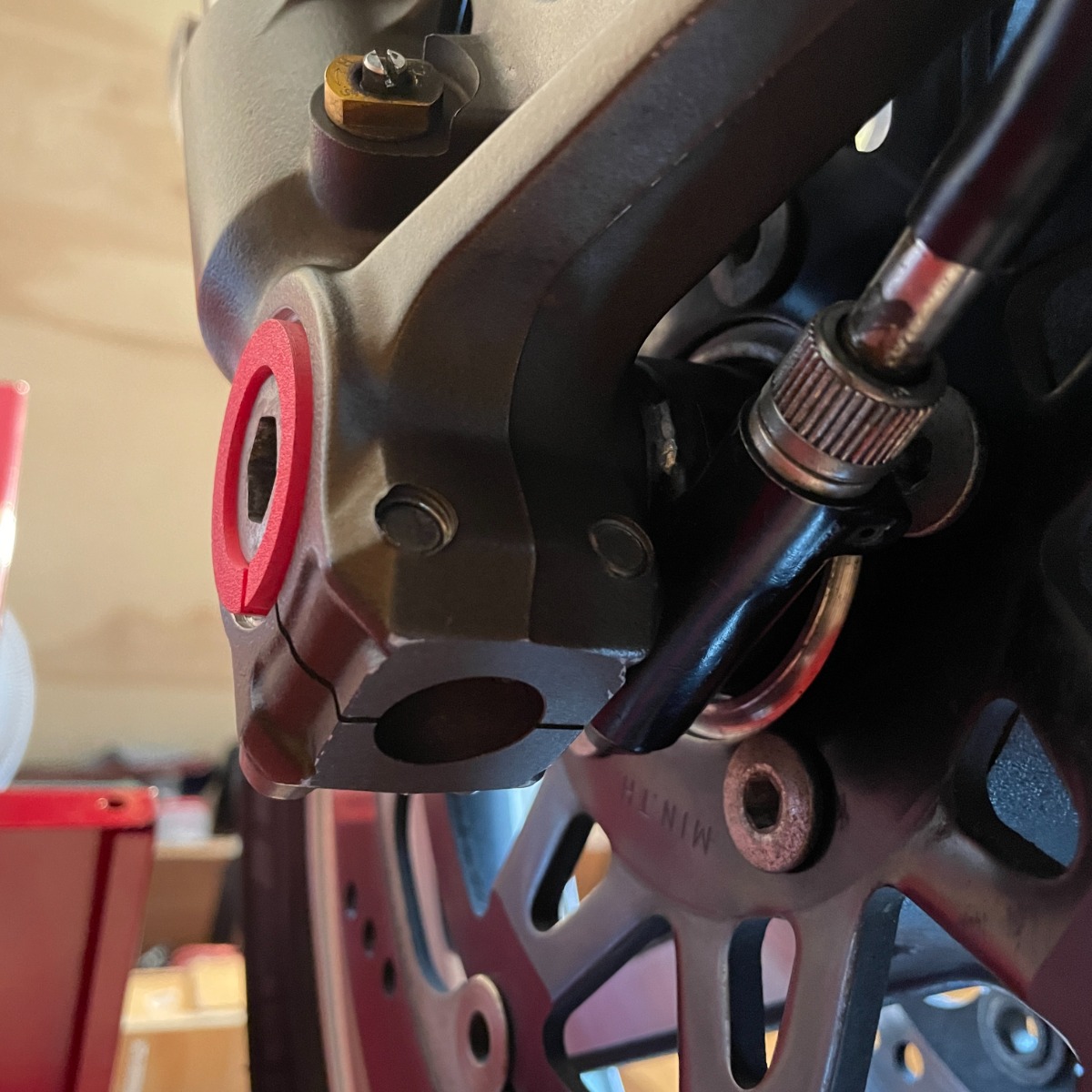

Just did a speedo drive test fit. It was looking like there was no way the cable would fit around this fat Nissin caliper, so I decided to take a gamble and modify the drive itself. I thought that might be a smarter idea than trying to modify the fork lower. Basically all I did was remove the two notches on the drive that are there to help stabilize it in the stock fork lower. By the looks of it, with the cable attachment part angling outwards, and the brake caliper radial mounts angling inwards, they might overlap, which would stabilize the drive. Pretty pleased to report that it works. Unless anyone can see any reason why this is a bad idea, I've got it mounted in a functional manner.

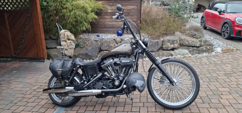

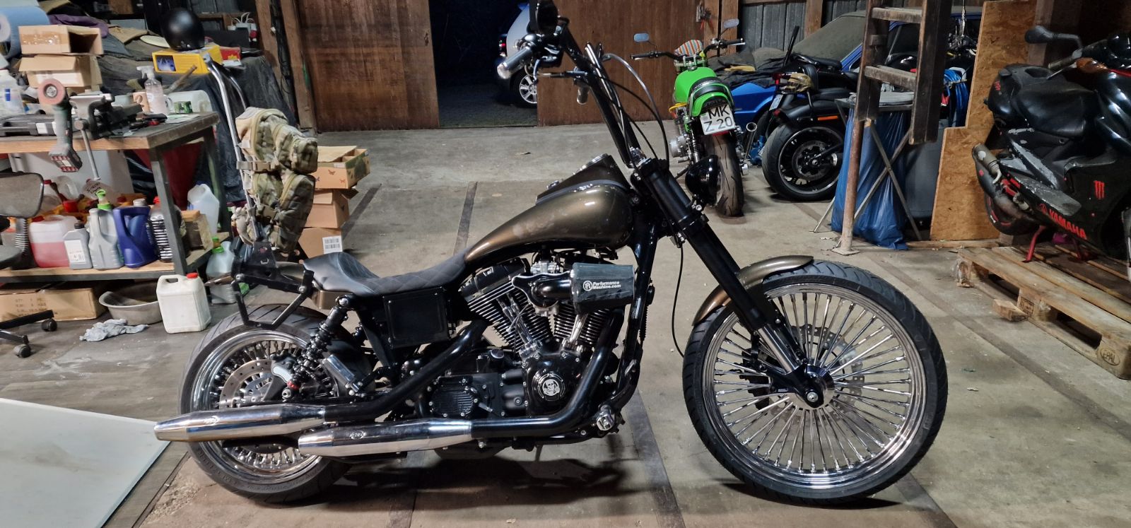

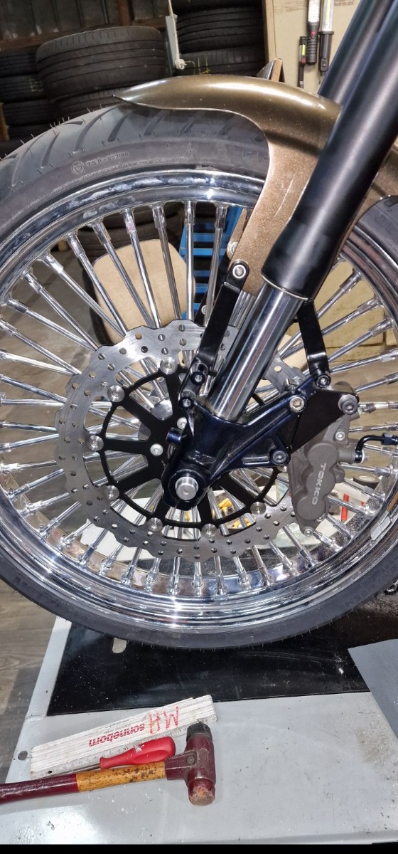

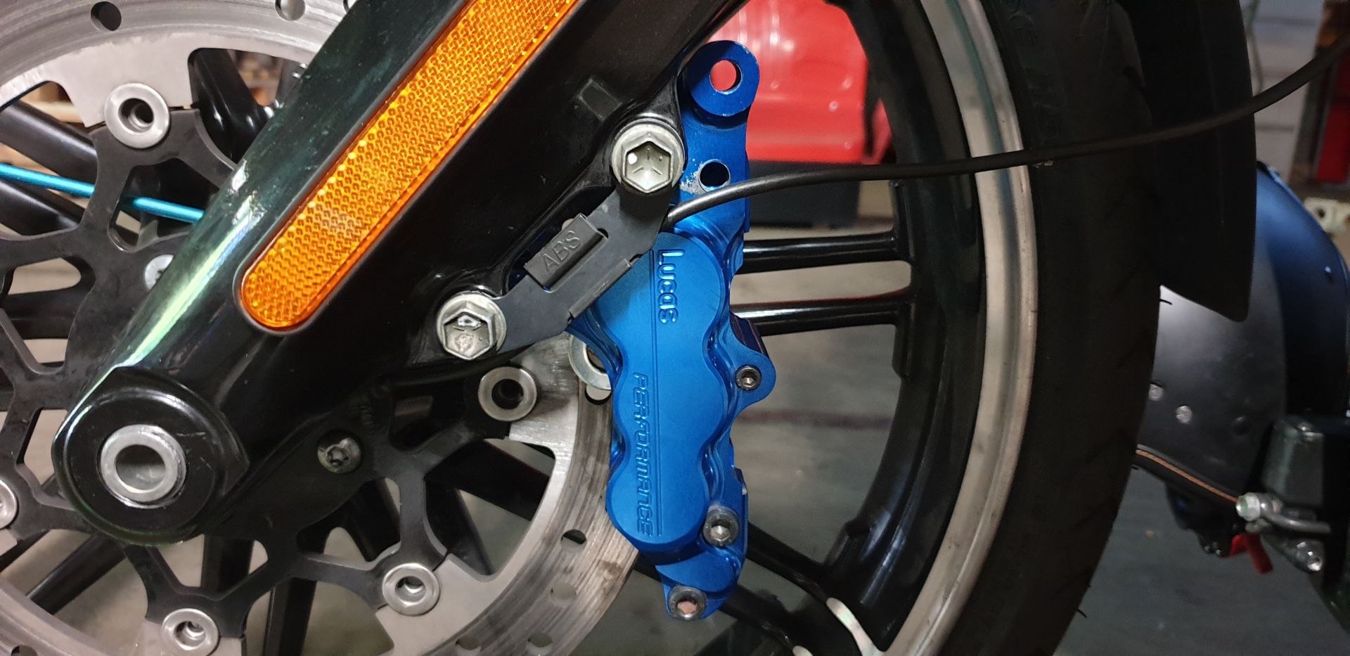

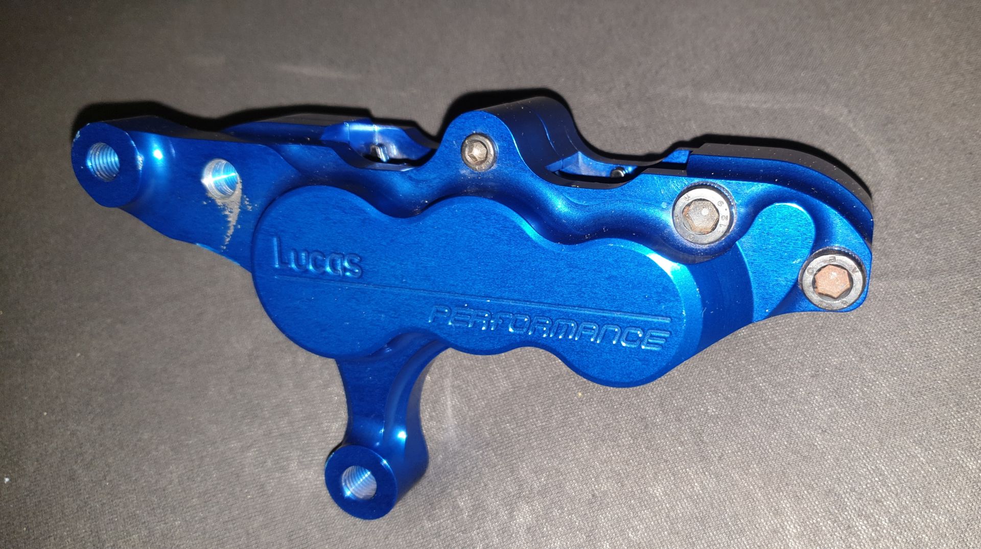

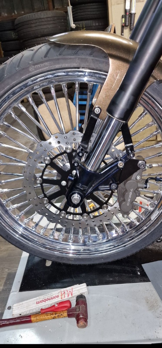

I did a USD fork conversion last spring for my best friend and Harley Davidson enthusiast bike.
His 2004 FXDWG,had a spongy front brake and a poor performance/response behavior of the fork.This is the finished result.
before:
now:

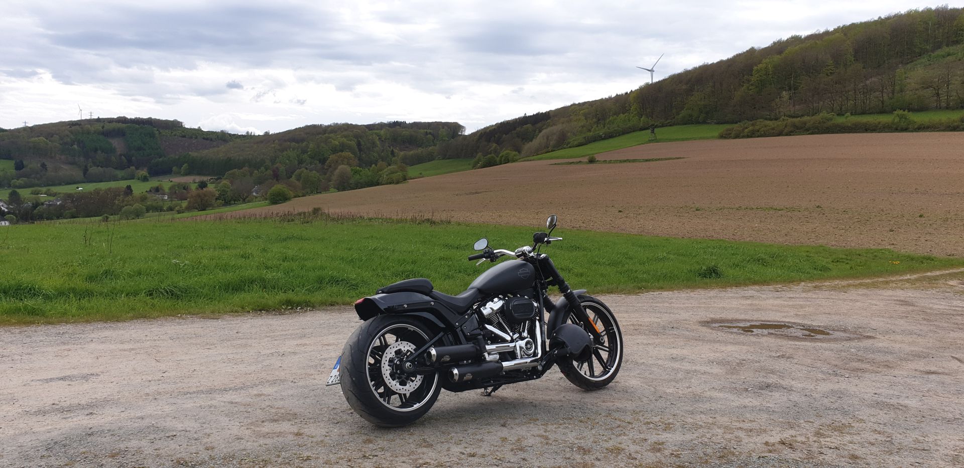

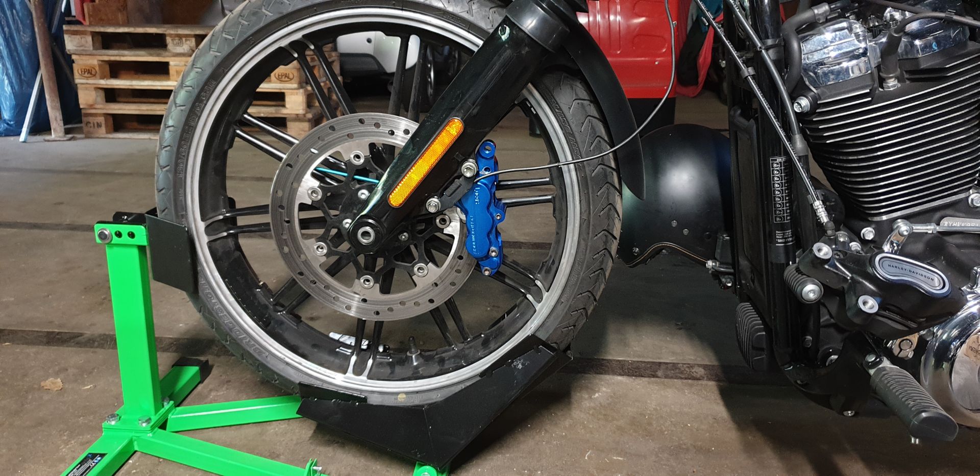

and and my current non Kawasaki project:
before:
now:

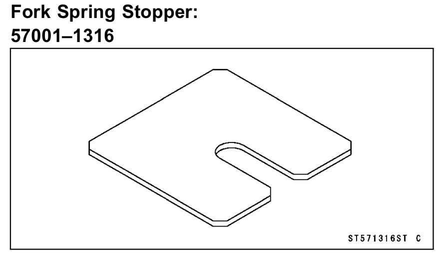

I’ve got a couple more questions about doing the fork extensions talked about previously in this thread.
I understand how to do it, but I need to purchase if make a fork spring stopping tool, like this:
It seems simple enough to make, but does anyone know how wide the “slot” needs to be? I’m guessing somewhere around 10mm, but wondering if anyone knows off hand.
My second question is about fork spring preload. With the tensions in place I think that means the springs are effectively longer within the forks, is that correct? So then that would make them softer, and therefore to compensate I would drive the preload adjuster in further, right? I think the standard setting for preload on my forks is 14mm out, but with 20mm extensions, am I going to be able to compress them enough?
