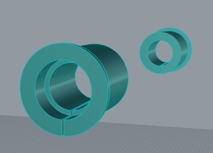

09 Aug 2023 00:52Wouldn't it not be able to do that anyway, because it's captive by the axle collars?
It's impossible for the wheel to float if the spacers are registered against the immovable fixed points of the fork inners and it removes any side loads from the collar arrangement which could cause movement even though the collars have the stepped locating lips.
It's just my belt and braces approach and maybe over cautious but i feel would be good engineeing practice to do it that way and then the whole assembly is locked in.

I get ya. Currently I have the speedo drive on the left, and there's no leftover space on that side. The right side spacer however I think could be made larger because of what you're suggesting, but also I think it would look better. More even visual distribution on each side. Maybe I could even contour it similar to the speedo drive for symmetry.

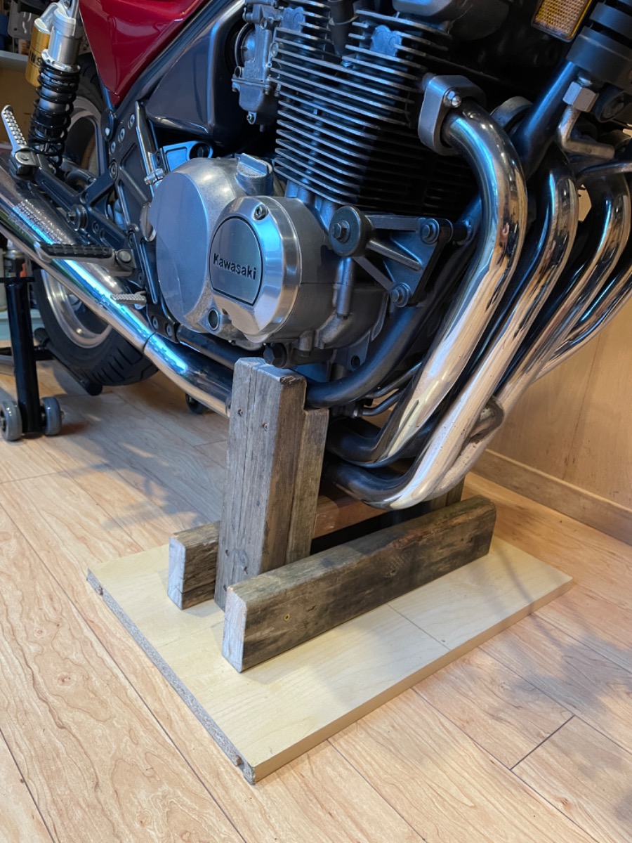

Made this little overbuilt 2x4 stand to hold the front of the bike so I can take the lower triple out for measuring.

Whelp, I got the spacers in today and they’re screwed up. It’s my fault, should’ve measured more carefully. Pretty sure there’s no way to modify them to work either. Live and learn I guess. Is there really no one here that can help me with 3D printing for prototypes? I’ll pay, not asking for favors.

Might be able to save the adapters after all. More on that later.

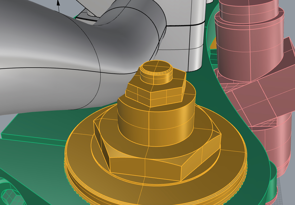

Rethinking the top yoke, I wanted to try and make it as flat and simple as possible to save on what it will cost to have machined. Figuring I could extend the forks as discussed earlier in this thread. However then I remembered that the top caps will be too tall and make contact with the handlebars. Render image is below.
So my question before I go with the original plan of a dropped top yoke is if there are aftermarket replacement top caps with less height? Like even if it's a pre-set sort of deal where I get a certain size for them to set preload, but then the they are no longer adjustable. Or, if a complete replacement cartridge kit might achieve that?
