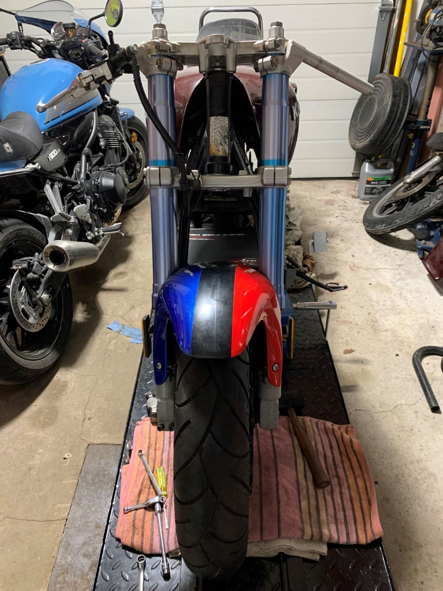

28 Feb 2023 23:07
It is not unironic that I took a photo of upside down forks while they were upside down, lol.
Anyway, my plan is a methodical one. I hope to carefully measure and 3D model nearly every millimeter of this entire front end, as well as the necessary parts of my bike’s stock front end, and use all of that to create a custom axle, and at least the top triple, but possibly both top and bottom triples. Then I will have to have those parts machined, and I’m sure that won’t be cheap.
Yay, fun!
Yay, fun!

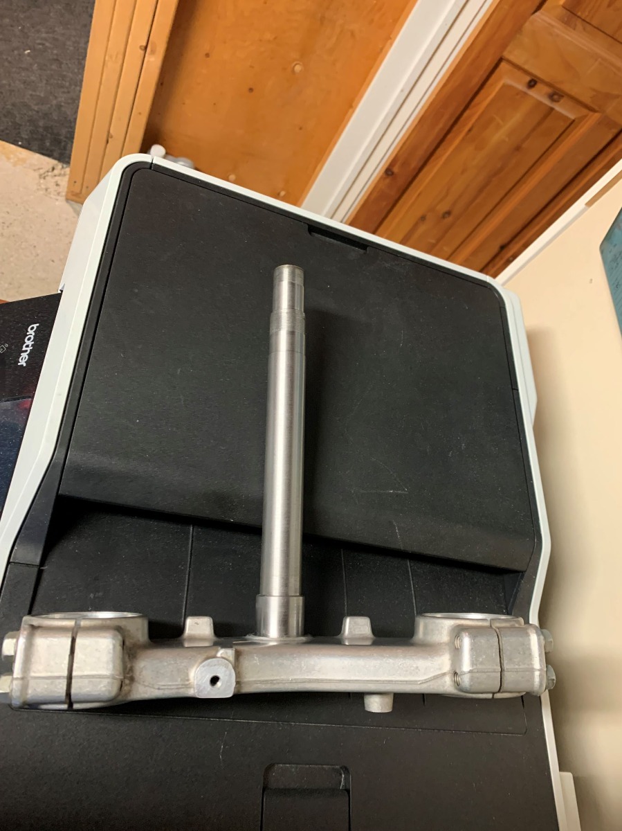

Re: USD Forks
01 Mar 2023 02:13
I have "re-worked" stock ZX6R stem to fit the longer ZX9R forks to my 82 1000Ltd. Custom tree's are nice but there are cheaper options

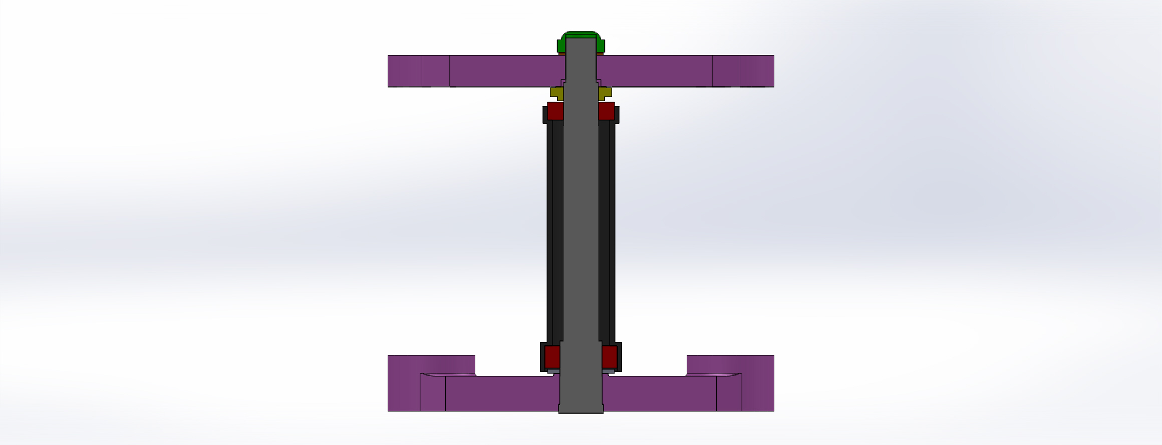

Re: USD Forks
01 Mar 2023 17:18
Well , nice forks you got!
I also had to mahcined the stem shaft but i kept the triple tree and all the rest from the donnator front end.
And i order the riser clip-on from Woodcraft Racing, the stock clip-on were nearly hitting the tank and i wanted them to stand higher.
Picture is the cutaway view of the shaft and the other part assembly.

Re: USD Forks

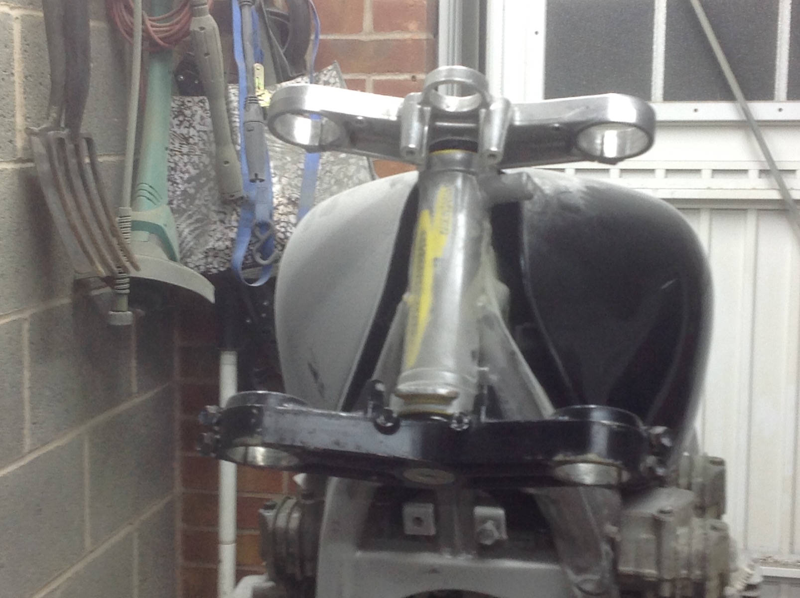

02 Mar 2023 11:08 - 02 Mar 2023 12:39It is entirely up to you how you go about this but from experience you are best to use as many parts as possible that are designed to work together. Why do want to use the ZRX triple? What you are doing is very similar to the conversion I have just done and you are in danger of over complicating things. Your stock bearings are - upper 25x47x15 (same as my 1000Ltd) lower is 28x52x16.5 (also same as mine) the process I followed wasI’m thinking I can maybe press out the original Zephyr stem to reuse, and I have a lower triple that is supposed to be from a ZXR250 I can check and see if it fits the forks. If that works out, the axle and upper triple are the only parts I’ll need to have custom made. I can save myself some money by designing and 3D modeling them myself, it’s just the cost of having them machined.
Riser clip-ons is a great solution, but I’m determined to keep my original handlebars.
- press out ZX6R stem
- Check top bearing retaining nut thread is no bigger than 25mm
- machine stem down to 25mm for top bearing (the earlier stem for RWU forks is 25mm as standard)
- Machine stem down to 28mm for lower bearing (you may need to reduce the shoulder under the bottom bearing if you are a little short on length)
- Fit stock Zephyr bearings

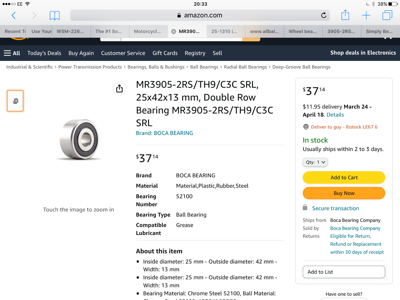

Just done a quick google search ref wheel bearings, it looks like yours are 42x15x13 and the ZX6R are 47x25x13. There are bearings available in the size you need (42x25x13) but you would need to check they are suitable for your intention or alternatively you could have the wheel machined out from 42mm to 47mm and use 6R bearings in your zephyr wheel which would then mean you can use the ZX6R. Axle

Whoa, ok now that’s interesting. I had thought about bearings and whether or not it was possible to use the stock ZX6R axle, but I just assumed it was a non-starter. That could be a great solution.

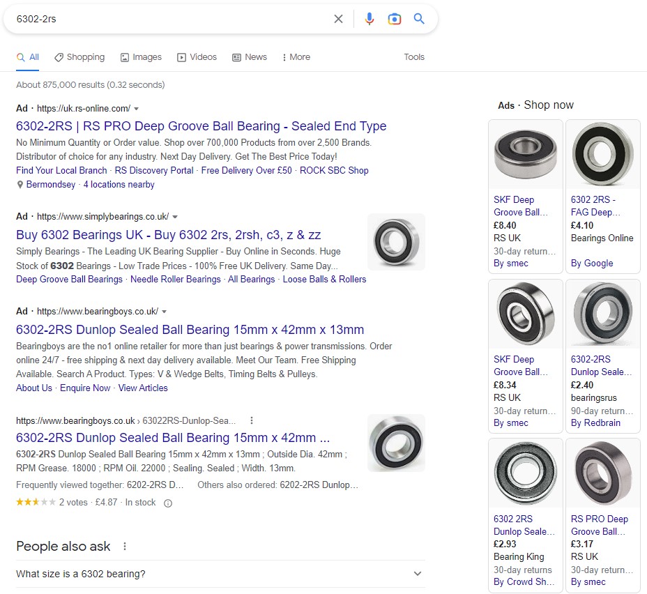

edit: Question, where are you finding information about what size bearings various bikes use? I went looking and thought it would easier, but not finding much.

Re: USD Forks
03 Mar 2023 00:41If you use the below link to identify bearing EG: 6302-2RS (Zephyr wheel bearing) then type the bearing number into google. WARNING: if you go the custom bearing route make sure the supplier confirms they are suitable for wheel bearings !!Whoa, ok now that’s interesting. I had thought about bearings and whether or not it was possible to use the stock ZX6R axle, but I just assumed it was a non-starter. That could be a great solution.
Identifying the correct wheel bearing for Kawasaki bikes (bikebearingshop.co.uk)

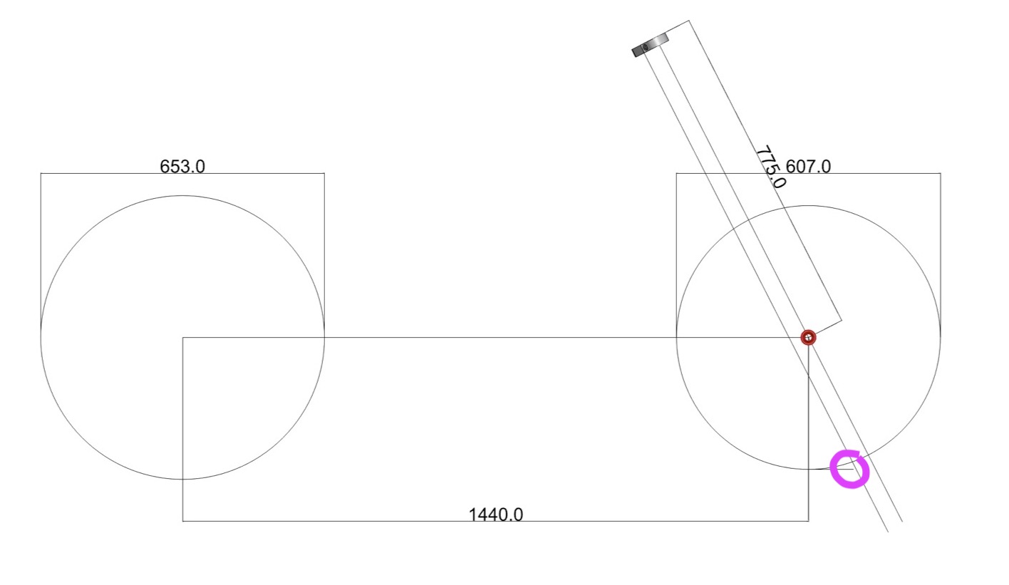

Re: USD Forks
13 Mar 2023 21:48 - 13 Mar 2023 21:51
Would someone be able to look and give me suggestions about where I might be wrong on my geometry here? My manual says that the trail should be 104mm, but I have a gap indicating that I'm getting more trail than I should be.
I'm wondering if maybe the trail should be calculated with some amount of compression on the forks. In other words, fully extended I measured 775mm on the forks from axle center to top, but maybe when the full weight of the bike is loaded, the wheelbase is shortened to that 104mm trail number.
Or maybe I'm supposed to use the front wheel axle as the center of rotation to bring the rear wheel up so that both tires are flat to the same plane. This would angle the wheelbase center line slightly.
