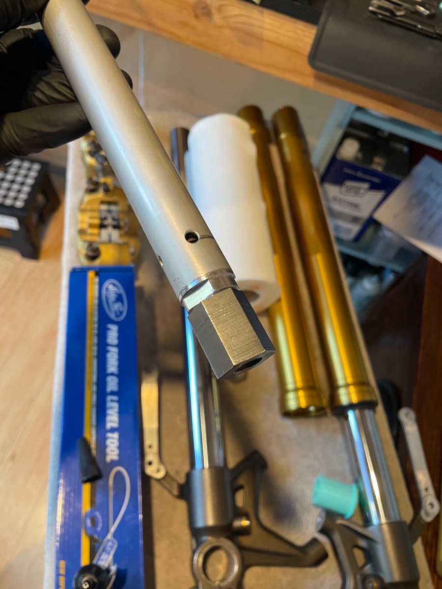

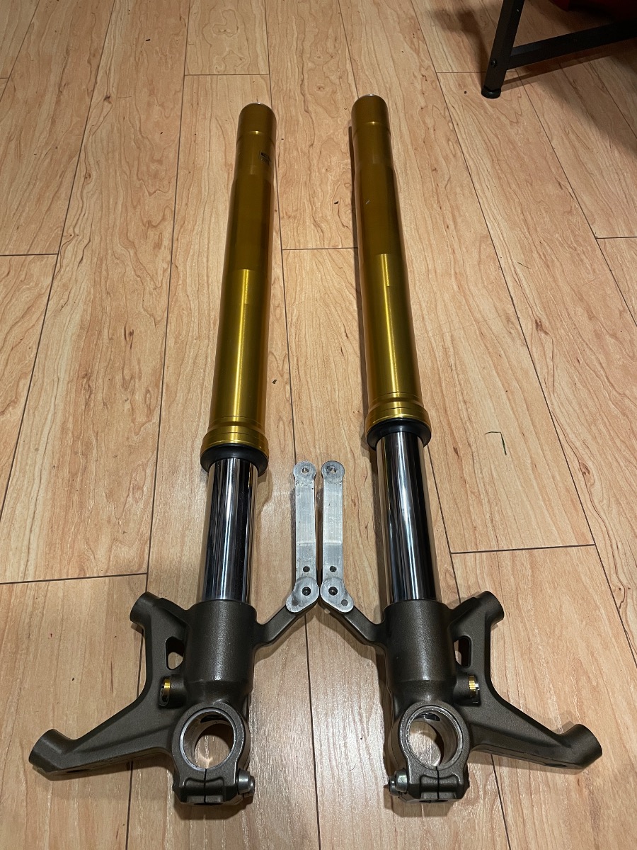

I suppose there’s not a ton to update, but I did want to share that I successfully rebuilt my forks with extensions on the damper rods.

Those forks look very similar to some i am looking at locally. 2008 z750 kwacka.
Did you get this bike in USA?
Some gold anodized ones for sale locally. not as much choice around here. i am going to measure them up soon.
I am hoping they are similar to 636 ,etc and an 'easy' swap i.e. bearings or pin swap. Looking forward to many nights of measuring and shimming.

I’m not an expert, but after a quick search it looks like the Z750 forks you are looking at are the same forks I have. What bike are you trying to put them on?

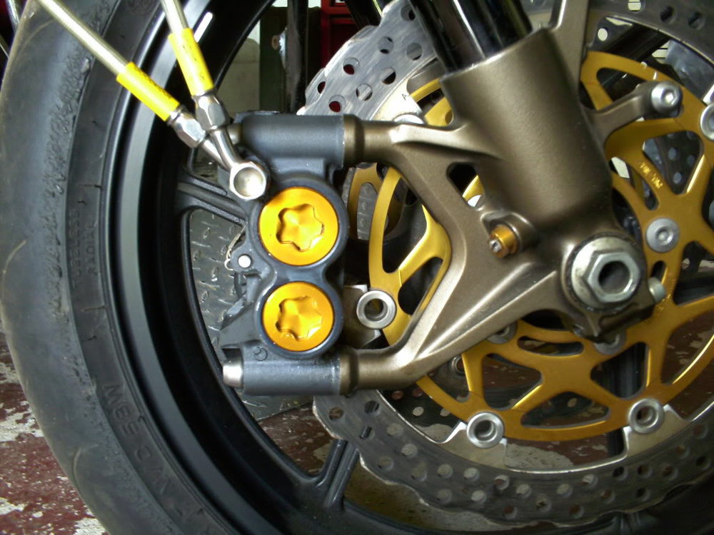

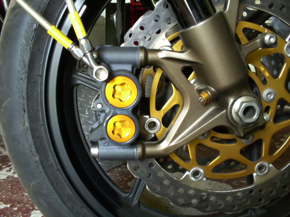

Most radial calipers use the same bolt spacing.
I used R1 calipers on my donor 05 ZX10R forks.
The only mod i did was to remove 5mm off their "feet" so they fitted the smaller diameter 310mm 05 ZX10 brake disc.
The later models use a larger 320mm disc so it would have been a direct swap if i'd used those.
The following user(s) said Thank You: boyracer, Stereordinary, kimchella
