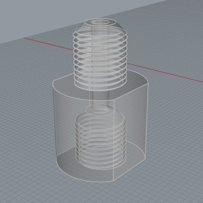

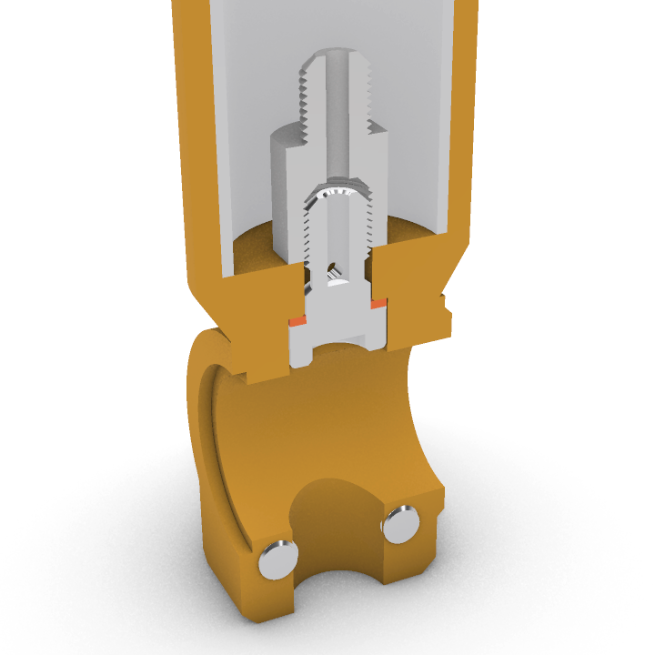

19 Oct 2024 09:50I'm finally making some progress on this. I bought a spring compressor tool (cheap one off ebay), a fork cartridge holding tool (from RaceTech), and a damper rod puller (Kawasaki OEM off ebay). With those I got one fork disassembled and able to understand a bit better how things work. I think ultimately Zed's method of lengthening the forks at the bottom is the way to go. Especially since I had to take everything apart to replace seals anyway.Doing it at the bottom like Zed did is slick, but more complicated than I think I’m set up for.
It took me a fair bit of time to measure things out and get some idea of how the oil flows through the system. I still don't get much, I mean suspension is basically black magic as far as I'm concerned. But at least I can see how the spacer needs to be made. Here's some screenshots of the 3D model, any feedback would be appreciated.
Only one question, I assume that the spacer needs to be made of steel, or stainless steel, right? Aluminum seems like it would risk threads snapping at the base on the upper male-threaded part.

Yes! Steel.

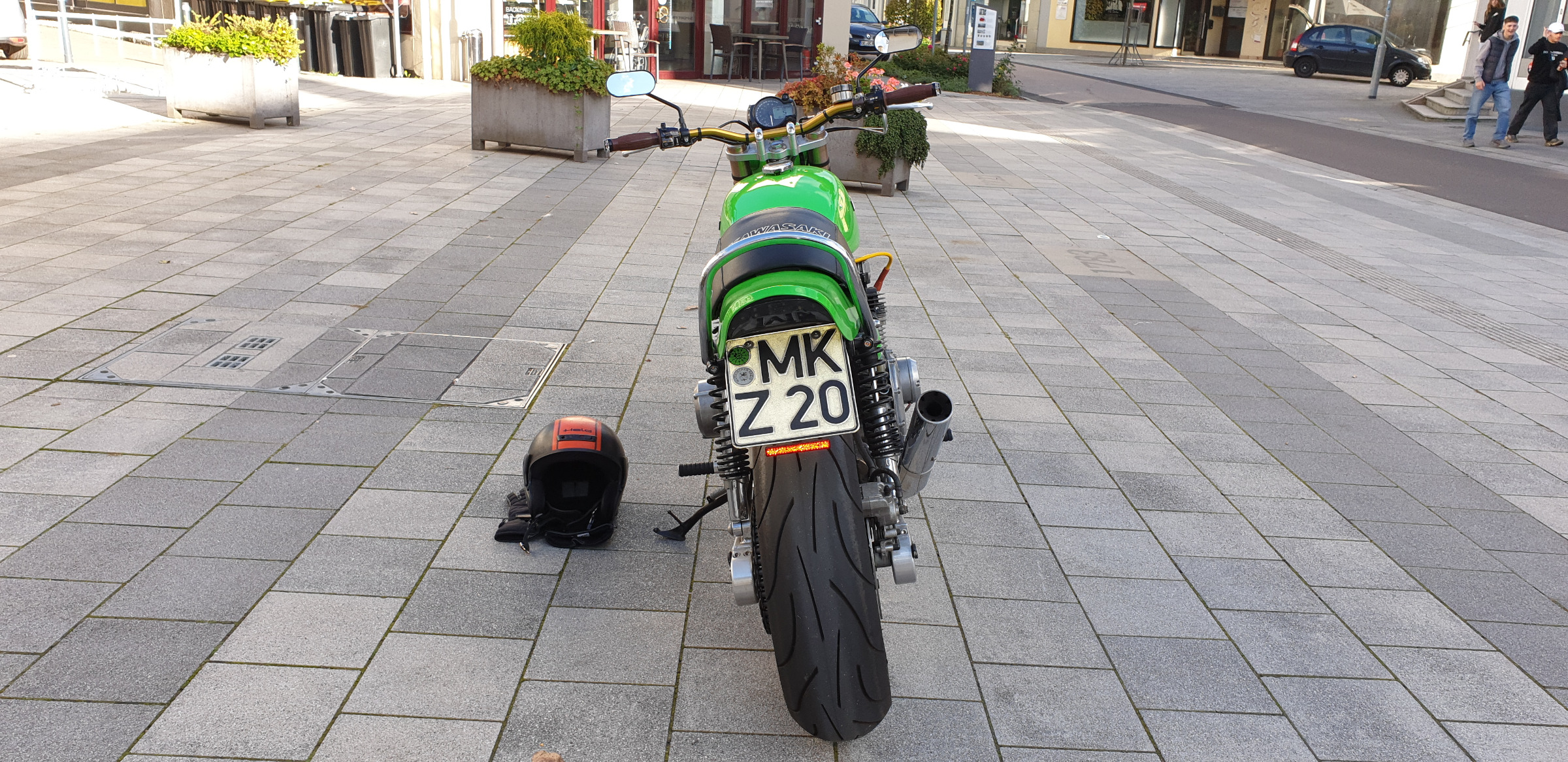

As for my opinion, you don´t need any extra front fork lenght extention.
My stock ZX9-R fork and brake parts upgrades are perfect for cornering and high speed drive perfomance and give me
enough ground clearance in any situation.....

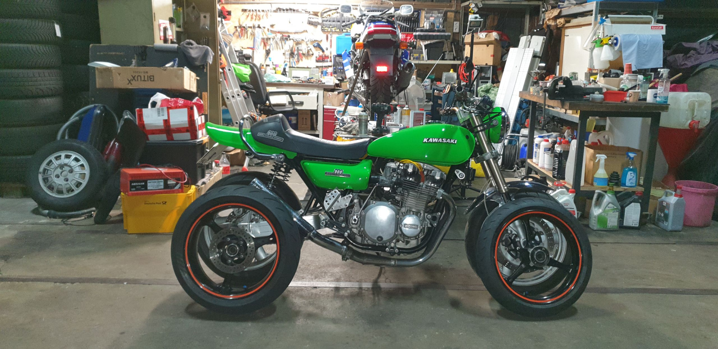

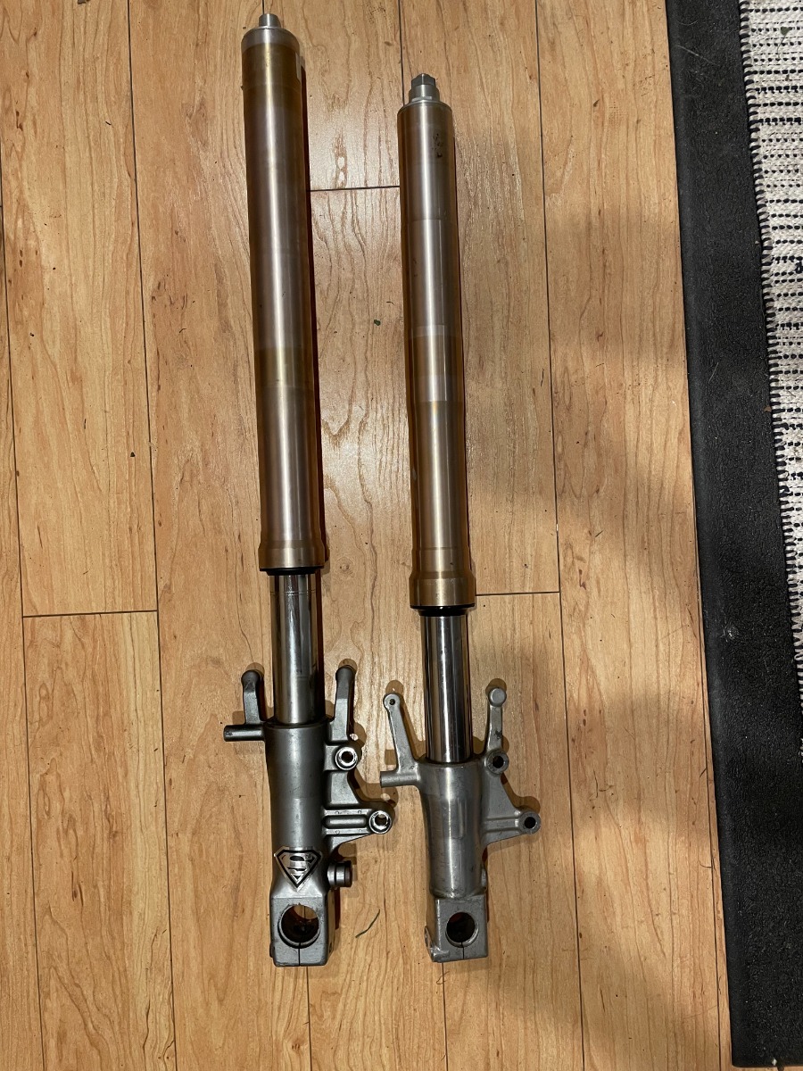

20 Oct 2024 15:17I appreciate the input, and your bike looks great, but ZX9R forks are well known to be longer than most all other sport bike USD forks. I'm quite sure that they are longer than my ZX6R forks. Here's a photo of one next to a ZXR250 fork, which I think is about the same length as my forks.As for my opinion, you don´t need any extra front fork lenght extention.
A breeze from the west.

The RWU ZX9 forks I am using are 30mm longer than the ZX6 version that use the same lowers. Even the ZX9 are 45mm shorter than a Stock “J” which uses a 19 inch wheel so without extensions I would be approx 70mm lower than stock with a 17 inch which would be a little to “public schoolboy” for my vision ( nose down, arse up)
