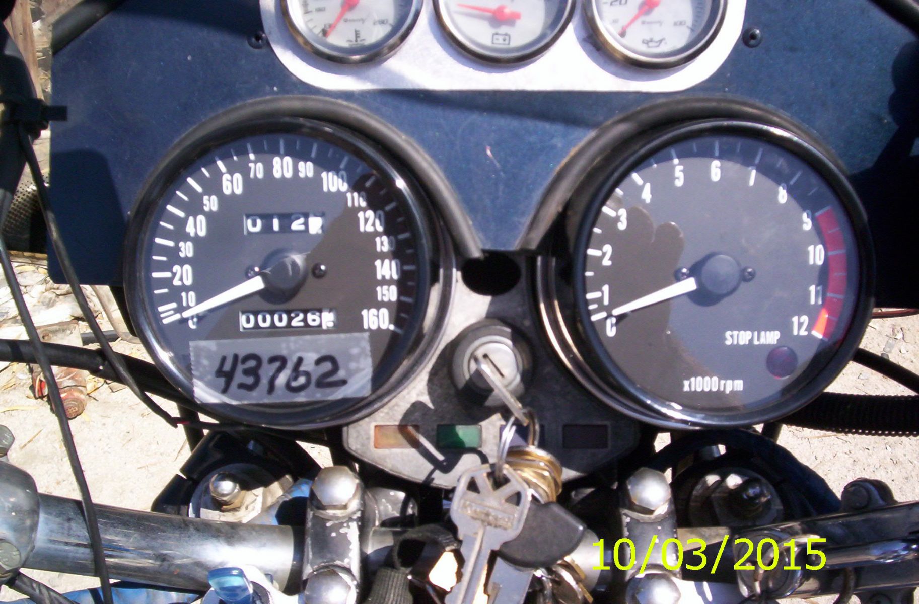

I'm happy to report the Tach and Speedo work perfectly even with a spongy cable. The Tach pulses a little at idle which suggests to me, the drive is bent or worn out. At speed they both hold steady. :woohoo:

Do you feel like you have a new bike with only 28 miles on the speedo now ?? :laugh: :laugh:

I put the old mileage on the tape until the rear tire wears out so I know how many miles I'm getting out of it. She seems happier with new gauges or maybe it's me

Well after 4000 miles my new gauges are having a problem The odometer stopped working. The trip meter was sticky and hard to set. The other day I tried to reset it and that's when the odometer stopped working. I sent z1partsinc a message telling them about it. We'll see what they have to say. The speedo still works well but I need the OD.

Steve, that's a bummer man. They look really nice too. Hopefully z1 will fix you up.
I've restored dozens of speedometers in my life so ... Typical mechanical speedometer operation works on the principle of induction. The drive cable spins a weighted disc which in-turn induces another disc that is attached to the needle you see. A specific spring pre-load determines the needle's accuracy & of course it's ability to return to zero.
The odo, however, is mechanically driven by the same cable via a (typically) helical plastic gear. I've seen these gears bind-up (usually from dirt entering and contaminating the grease). Often either the primary helical gear or it's driven mating gear will strip due to being bound-up. I have also seen them crack (quality control problem).
The trip reset spins the numeral reels forward as if simply driving it clicking the numerals sequentially until they all cycle to zero. This reset action usually has no interaction with that helical drive gear or the mating driven gear.
So... it sucks because given the description, i believe you have a broken unit by obviously no fault of your own. It will require the unit be dismantled & those gears being replaced.

I can reset it but I think the worm gear is stripped. When I noticed the trip meter has sticky and hard to set I sent a e-mail about it. No response. I bought a alternator stater at the same time. When the wires got chewed I sent a e-mail, got a response telling me their mechanic would contact me the following Monday. He didn't. We'll see what happenes this time.
