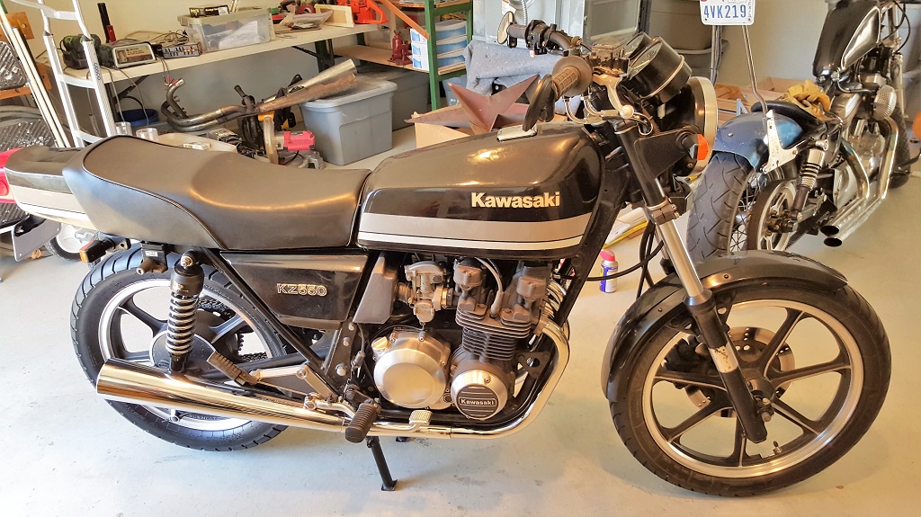

I've always liked seeing the pics here of resto-mod bikes with super shiny engine cases, however, what's a guy (or gal if there are any here?) to do when their bike's engine is not in need of rebuild and thus, unlikely to be polished?

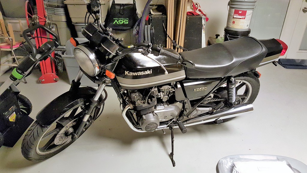

I decided to tackle my new-to-me kz550 last week. I had a day off and sat in the garage, coffee in hand, staring at the engine casings of my bike:
I love the stock looks of this bike. It has some mods, but mostly stock but the engine casings are letting it down.

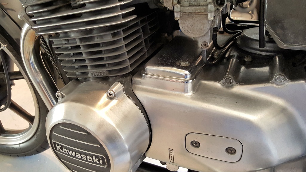

So I went out to the local hardware store and bought some sandpapers - 120, 180, 220, 400, 800 (last two wet/dry papers). Also bought a couple packs of steel wool - triple zero and quad zero and an assortment of wire brushes (mainly toothbrush sized, steel and brass bristle).
It's certainly unnerving to take sandpaper to your bike but I've done this before for other car projects and knew it would work; it's just a matter of time and fingers holding out.

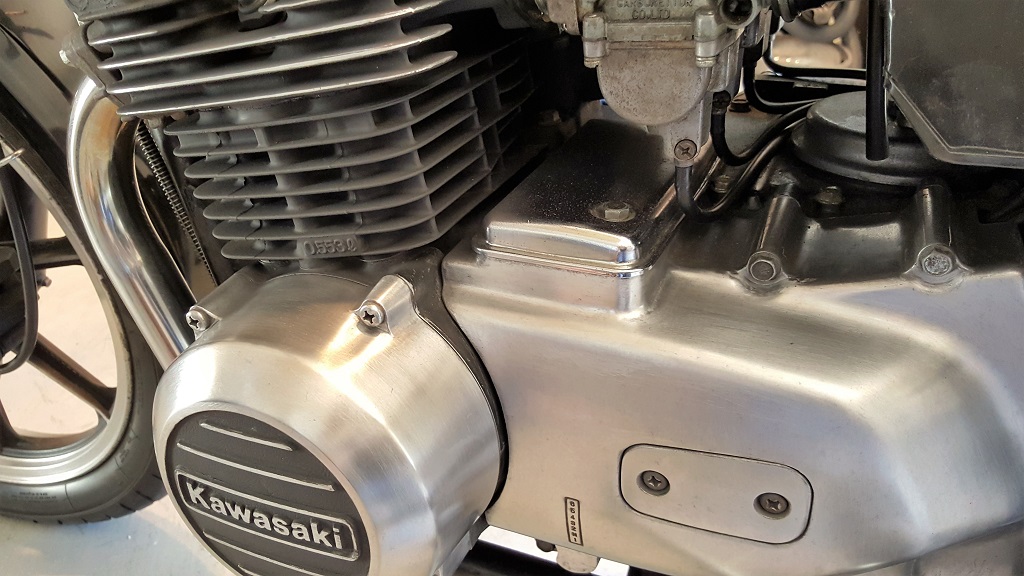

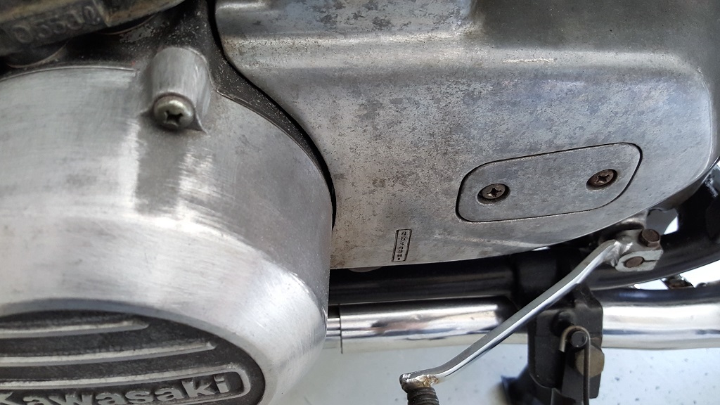

I started with the 120grit only where the cases were scuffed or scratched deeply to smooth out the surface faster. You could start with 220grit if your case is already in nice shape and just oxidized. Here's the start:
As you can see, the change is quick and so long as your fingernails and skin can handle the constant back 'n forth of sanding all you have to do is keep going and occasionally sweep the dust off and move-up to a finer paper all the way through to the finest grit you have. I stopped at 800grit and went to quadruple zero steel wool to put the factory-like shine back on the casings. Here's a pic after probably 6 hours of sanding and polishing with steel wool:
As you can see, it's pretty good. I could have gone up to finer grits of paper like 1000g, 1500g and 2k grits and this shine would be approaching a truly "polished" look but I didn't have the time or patience. I just wanted the ol' bike to look better or closer to factory new.

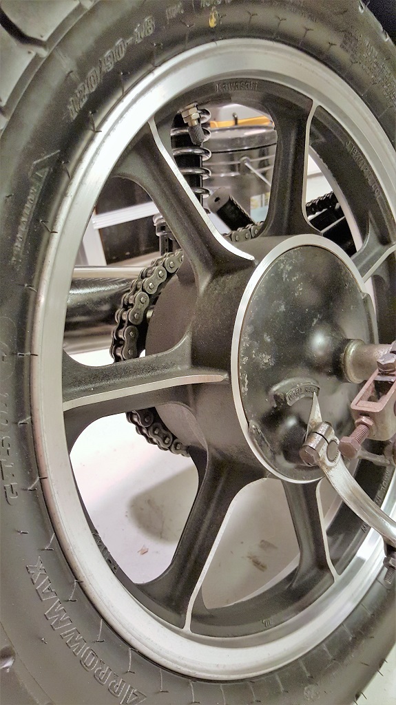

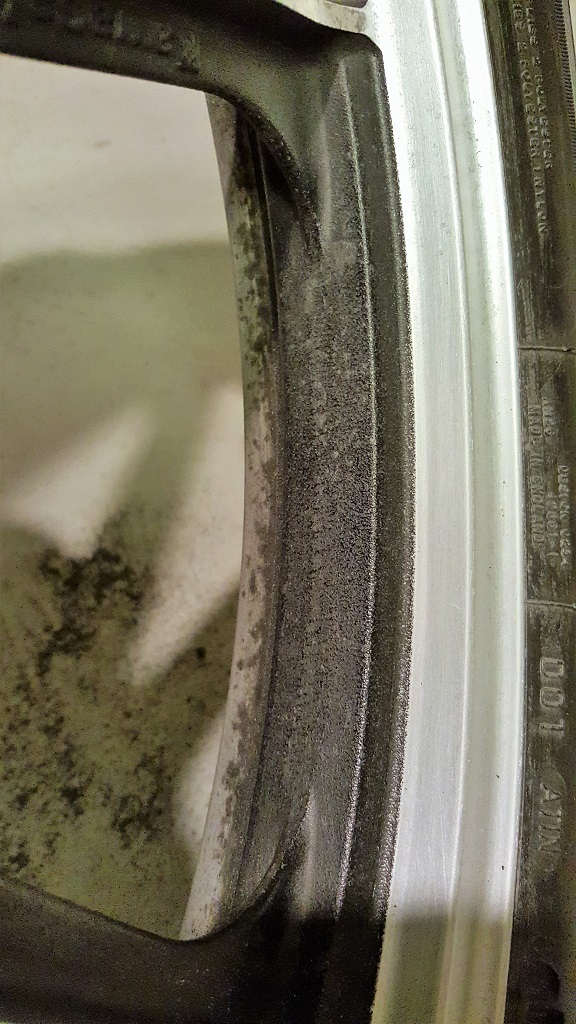

The wheels were the same process, except I started by washing the rims of grease first and then followed with the papers. Lower numbers to start and remove rash and then skip up to higher numbers. This applies only to the rims and NOT the spokes. The spokes were where I needed those wire brushes. In particular the steel wire brush and just like your mother showed you how to brush your teeth in the "right way" there is a correct way to brush your mag wheel spokes - side to side across the spoke worked best. If you look really close, the spokes have small grooves across them. I'd guess made by a lathe or similar tool at the factory. These small grooves mean sanding is impossible so I experimented with the steel wool but found simply briskly pulling the wire brush over the spokes worked best to get a shine back and remove the oxidation in those grooves. Here's the "During" pic of this. Far side of the wheel is untouched and near side is in-process:
and the finished result of the wheel "brushing":
And the final coffee in hand and staring at your hard work about 8 hours later... Not bad for a few bucks in sandpaper and basically cleaning supplies:
Oh. I also picked up a rattle can of satin black paint. I got high heat paint and sprayed it into the cap and then used an "artist" brush to paint the areas that were originally black like the foot peg mounts and the case covers. Then after the paint dried, I zipped over the engine fins and timing cover etc with 800 grit to take the black over-spray or drips off and light polish with the quad-zero wool again..
Not expensive. Meh... admit it was a day in the garage but still worth it in my humble opinion. I've noticed it rides better now too. Must be like when you wash your car and suddenly it works better... :laugh:

I did have to sweep off the "black dust" (seen in close-up pic of front wheel, on garage floor) occasionally but ultimately the alloy is hard and shiny smooth but If so, then maybe skip the steel wool if you're worried and just press-on with higher grit papers. By the time you hit the thousands, you're polishing, not sanding anyway...

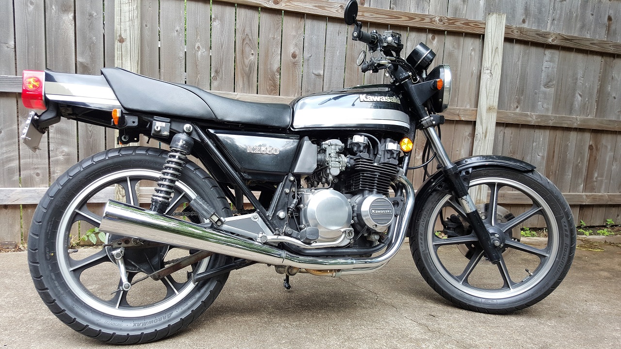

Thought I'd show an update on the engine cases. I admit this bike doesn't get exposed to inclement weather and since I buffed the engine cases, I've only filled it up maybe 4 times but it does get ridden at minimum weekly.
So far so good. Little more than wiping dust or bugs off it.
