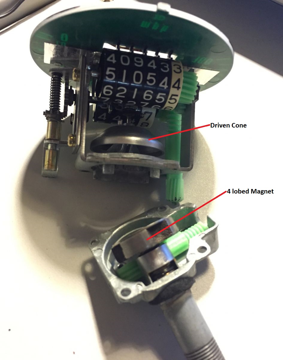

Well that didn't work. They don't sell the 20 minute JB anymore. This SHT takes 2-4 to get hard and it was still tacky. Like gum.
I took another one to the shed and filled the void with solder and filed it smooth. Yeah it didn't stick but it did fill the larger space and the hole. I drilled that and put it back together. Seems to work but for how long? I'll do the switch and pack up the new ones tomorrow then send them Friday.

I've had the crimp ring of my speedo so many times in the last year and a half, trying to sort it out, that I don't know if it could take another round!
How they heck did the dampening rewind spring get broken?
What part are we talking about here?

Thanks. The driven cone, it's pivot and mount. On the top of the mount is a divot. The pin is broken. The spring broke because I let it swing wildly. I think I didn't put it together right. This time I rotated the cone one full revolution before I put it together. I just don't want one or two holes staring at me while I ride. :pinch:

Have my old gauges ready to go back on the bike. The Tach had a broken spring. I decided to see if I could fix it. There is a arm that is bent in three 90* angles. The end is bent over and crimped. The spring goes in there and is bent over to hold it in place. I opened the crimp, put the end of the spring in there, bent it and recrimped the arm. The spring will be about 1/4" shorter but who cares. PITA taking it all apart but now I'm an old hand at it. I set the preload one turn this time on both. I expect they both will lie but at least they won't be flopping around. :whistle: I'll pack up the new ones and send them back tomorrow. Who knows, they might even work right.
