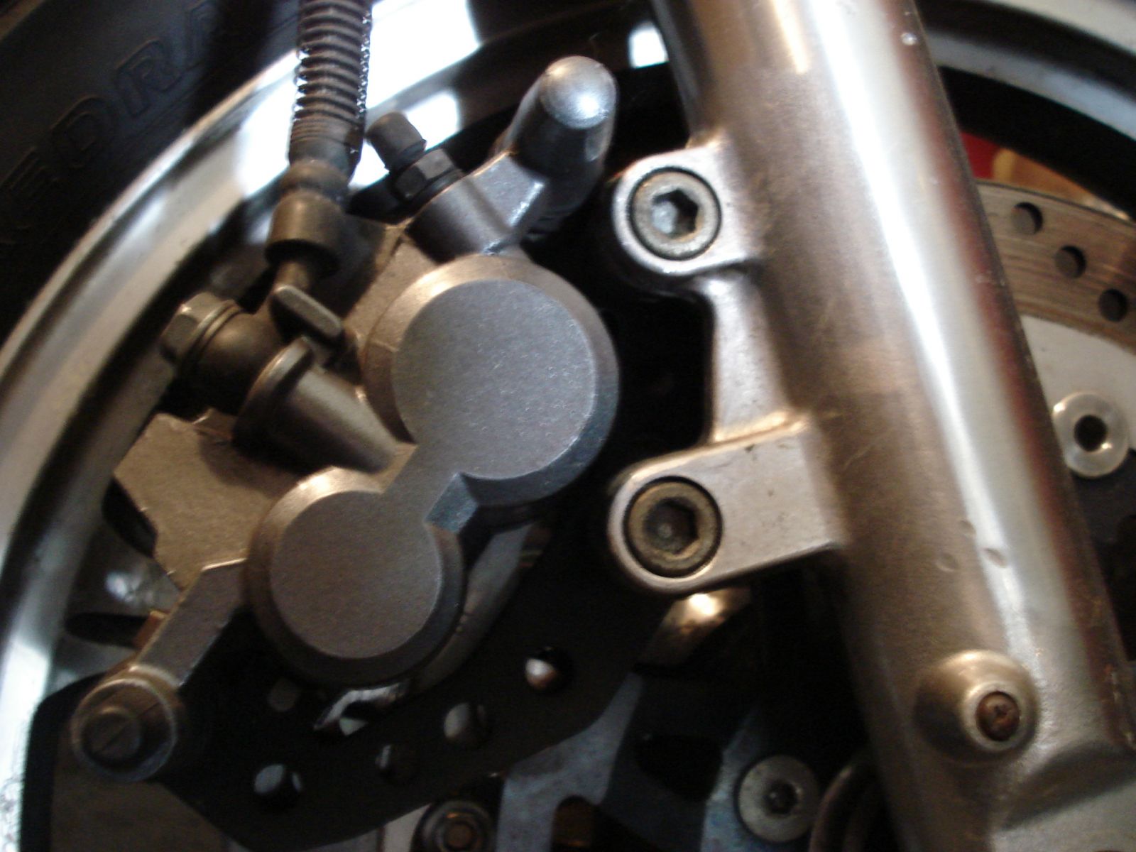

04 Jun 2011 10:11Harvey1327 wrote: These calipars are of a ZX7.
Attachment IMG_0883.JPG not found
Did you make those brackets? That is the exact same conversion I want to do on my GPZ. I already have the calipers.

Now that's what I'm talking about! That looks great! Where did you get the caliper brackets? I would love to do something just like that.

That is just a perfect solution. That's all I'm looking for is somebody who can make a bracket to adapt late model calipers to the stock rotors. Then I could work on getting the EBC brake rotors. That whole set up would be much less than $1100 for sure. Used calipers are on eBay all the time for very reasonable prices. Maybe if I select a caliper like Harvey posted, I could mock up a bracket since the fit looks to be very close to the factory caliper anyway. It looks like it even shares the top mounting location. You'd just have to pivot the caliper to where you want it and mark it.

Just realized that there might be a major problem with that brake set up. If I understand correctly, for a brake system to work properly, either the rotor or the caliper has to "float". Our KZ rotors do not float, but the calipers do (they slide side to side when mounted on the forks).
In the set up shown, it appears that the ZX-7 calipers are solid-mounted onto the bracket. If neither the rotor nor the caliper is floating, wouldn't that create some problems? Hopefully you guys can help me understand this. :huh:

04 Jun 2011 14:34 - 04 Jun 2011 14:3879MKII wrote: Just realized that there might be a major problem with that brake set up. If I understand correctly, for a brake system to work properly, either the rotor or the caliper has to "float". Our KZ rotors do not float, but the calipers do (they slide side to side when mounted on the forks).
Those calipers DO "float". They are in rubber lined pistons and can go side to side. You can see one of the rubber lined sliders at the bottom right. It is that small black "nipple". The second one is the little dome at the top.

Here is my attempt at making that bracket out of steel.
Attachment DSC02397.JPG not found

That bracket looks great! And thanks very much for the information on the calipers. The fact that they do float is great news. Project back on! :lol:
