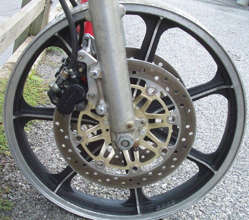

1000 Police forks/calipers with KZ1300 18x2.15" wheel and 298mm rotors, all stock Kaw parts w/no machining,on a 550. It should stop well

Those look real nice! I have to find something that will bolt up to my Z1-R wheel though...I have way too much money in it at this point.
How did you paint the centers? Did you just mask it off or is there another trick?

31 May 2011 23:1079MKII wrote: Those look real nice! I have to find something that will bolt up to my Z1-R wheel though...I have way too much money in it at this point.
No tricks, just lots of masking. Paint is base/clear catalyzed urethane. I have a Z1R wheel kicking around that I'm waiting to use on something. The 1300 wheel is tubeless. I can't wait to get the rest of the bike done so that I can try the brakes out.
