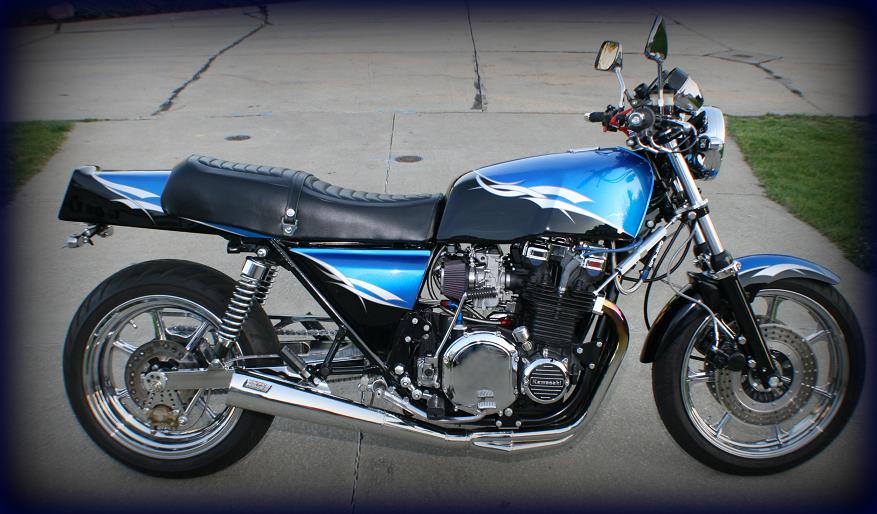

Current set up:

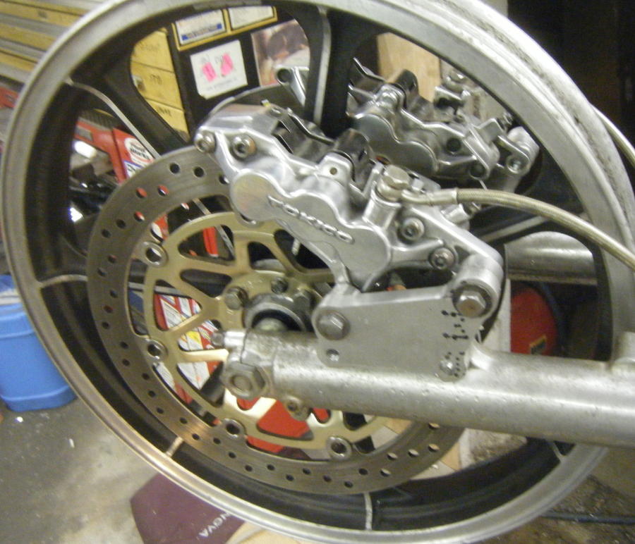

there is a member here that goes by "the fish" on here. he was building and selling conversion kits.i don't know if he could just sell you some brackets or what.
here are a couple pics from his threads.
if you could make some mockup brackets out of cardboard i could whittle you some brackets out on the mill.they don't look to difficult to build.
hth,

Thanks Leon. Fish is who I talked to. His kits start at $1000. He's not willing to sell individual components because he wants to be sure that everything works well together. I like his stuff but just can't spend that much cash right now.
If I can come up with a way to mock up a bracket I'll let you know. Thanks!

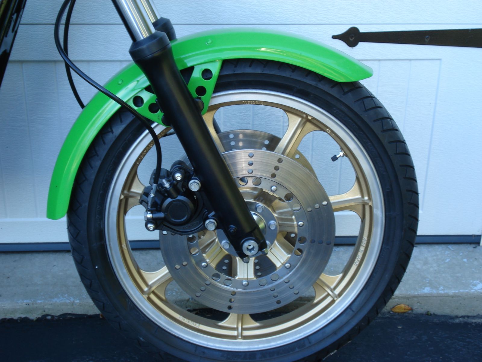

1000 Police forks/calipers with KZ1300 18x2.15" wheel and 298mm rotors, all stock Kaw parts w/no machining,on a 550. It should stop well

Those look real nice! I have to find something that will bolt up to my Z1-R wheel though...I have way too much money in it at this point.
How did you paint the centers? Did you just mask it off or is there another trick?

79MKII wrote: Those look real nice! I have to find something that will bolt up to my Z1-R wheel though...I have way too much money in it at this point.
No tricks, just lots of masking. Paint is base/clear catalyzed urethane. I have a Z1R wheel kicking around that I'm waiting to use on something. The 1300 wheel is tubeless. I can't wait to get the rest of the bike done so that I can try the brakes out.
