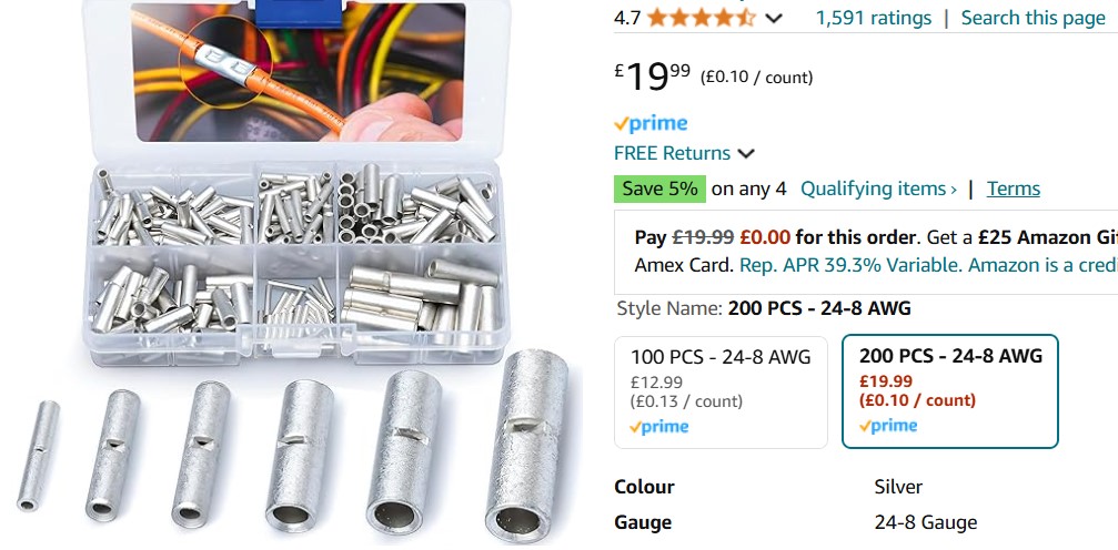

- Posts: 6778
- Thanks: 4269
Re: General help, building electrical harness
01 Dec 2024 11:34

- Posts: 6778
- Thanks: 4269
01 Dec 2024 11:45 - 01 Dec 2024 11:46If you choose a sleeve that is just big enough for the 4 cables, then if necc twist and fold the stripped back single cable to be a nice fit in the other end of the sleeve (I prefer to solder these but you can crimp) the cover the whole joint with "heat shrink" sleeving ( you can get it with an "adhesive" coating internally) once shrink wrapped it should be weather-proofAhh okay, but how to get it water resistant?

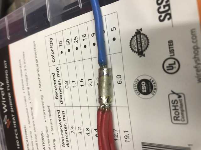

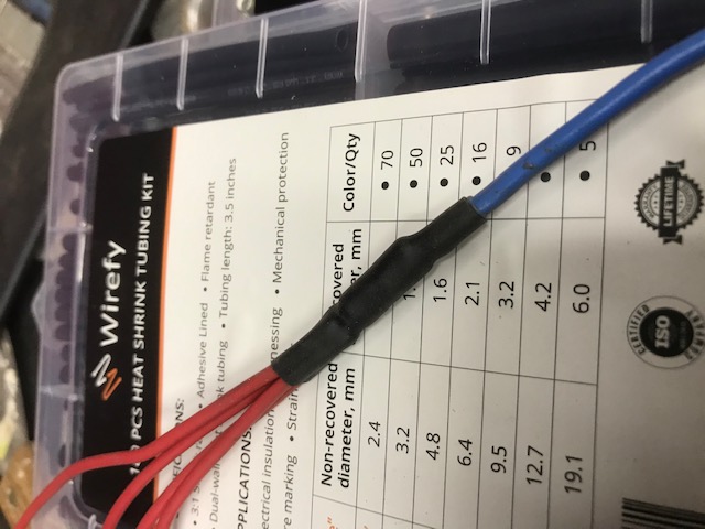

- Posts: 6778
- Thanks: 4269
02 Dec 2024 11:48
I have put a sample together after work which might make it a bit clearer (4-1) if you choose to solder then apply the heat to the centre of the tube until the solder will melt and get drawn into the tube while heating the tube (not melting the solder with the iron)
