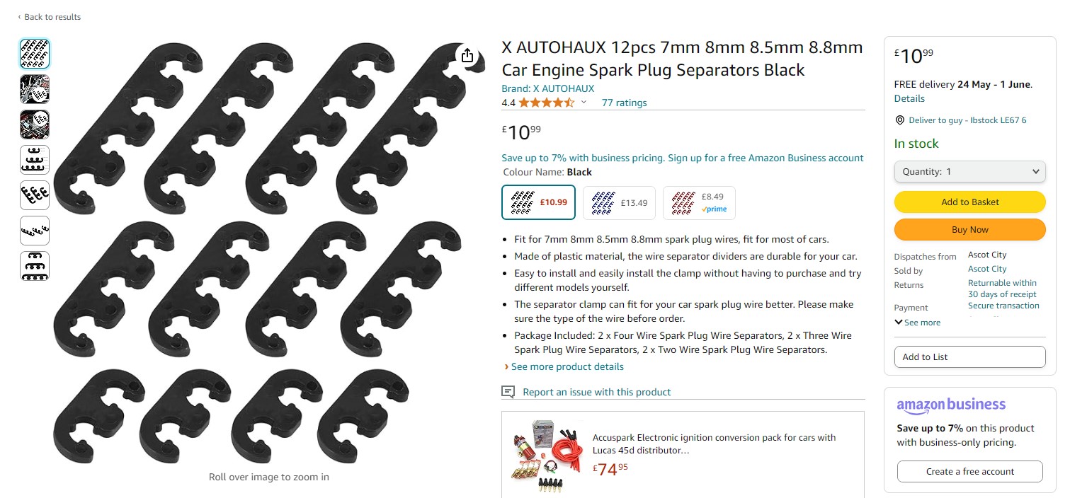

How old are your plug leads, many years ago I had a KH400 that "ran like s^*t" on wet days (plug leads were arcing out)

They are new .bought new coils from z1 enterprise they are marked emgo.The plugwires are a little long and is not tidy placed so they are in contact with eachother and laying on the valvecover

Thanks Wookie i saw those some years ago but dont remember why
. So it is then not good for the plugwires to make contact ?
. So it is then not good for the plugwires to make contact ? Please Log in or Create an account to join the conversation.
- Posts: 6477
- Thanks: 4081
Re: Very frustrated now bike runs bad again
13 May 2024 06:35Better if they don't (especially if there is moisture)Thanks Wookie i saw those some years ago but dont remember why. So it is then not good for the plugwires to make contact ?

This winter i bought 4 clamps at z power that is suposed to sit on the valvecover and hold the plugwires.I forgot to install them maybe that will help.
