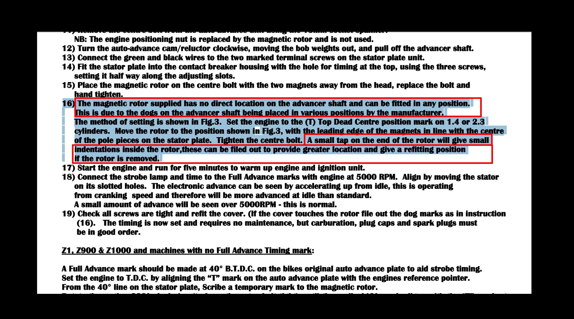

18 May 2024 15:21I don't think you need to extend the slots, the rotor isn't pegged so you can loosen the 13mm and adjust itYour picup plate need extended slots or the right rotor.
Your ignition tiiming @ idle approximately 10 degrees delayed.

I read the instruction manual and it is really confusing. Rotor has no slots and can rotate in any position, (it´s okay).
But why the hell they couldn´t made two locating markings for TDC or F position only onto the rotor and the #1-4 picup (base plate)?

It really isn't written very well

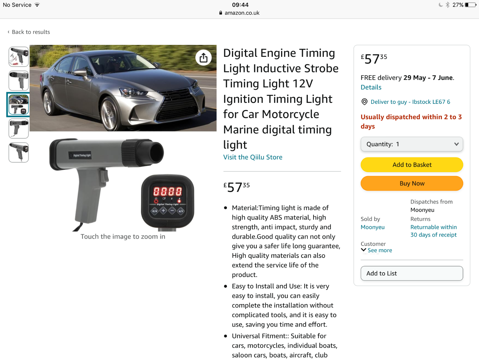

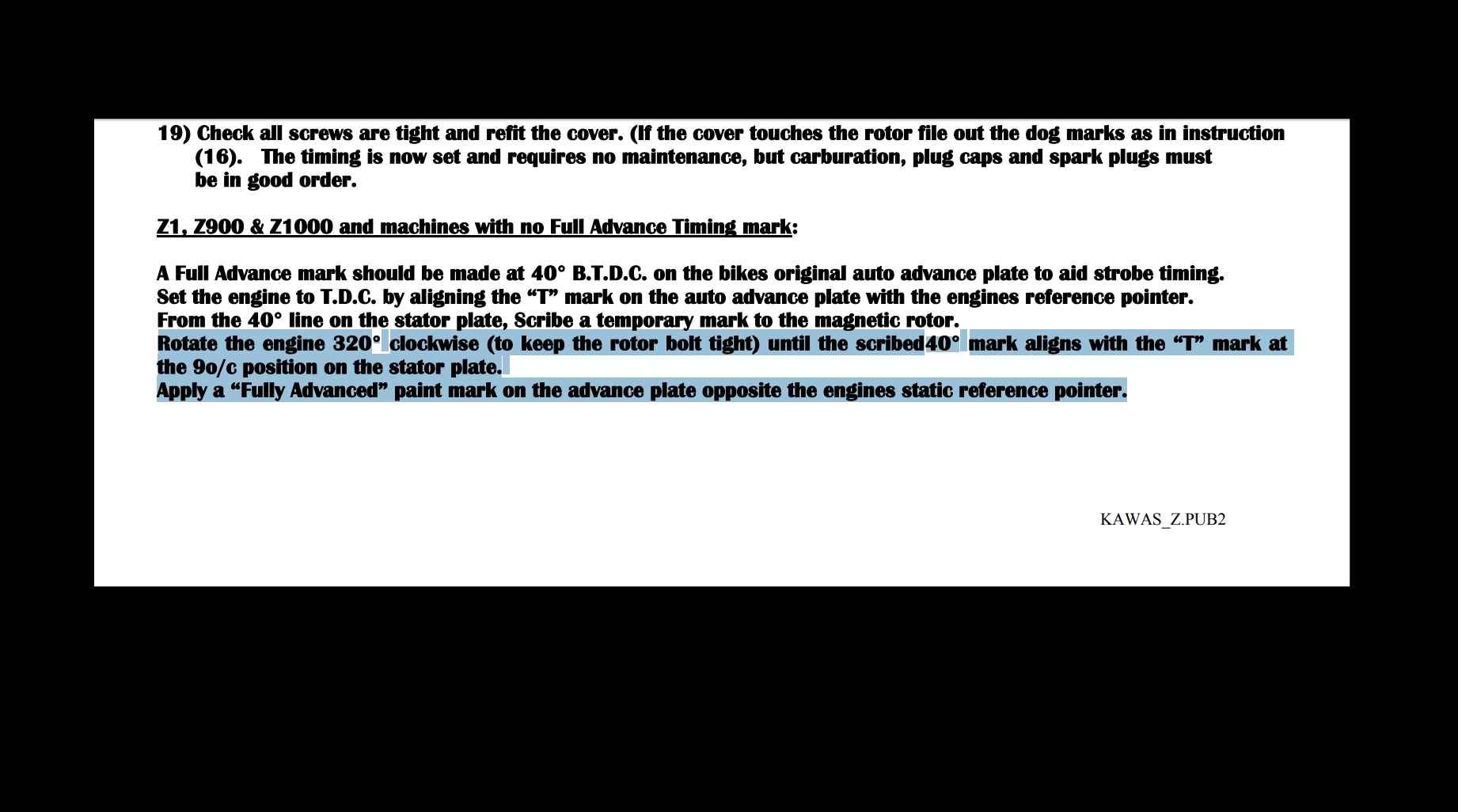

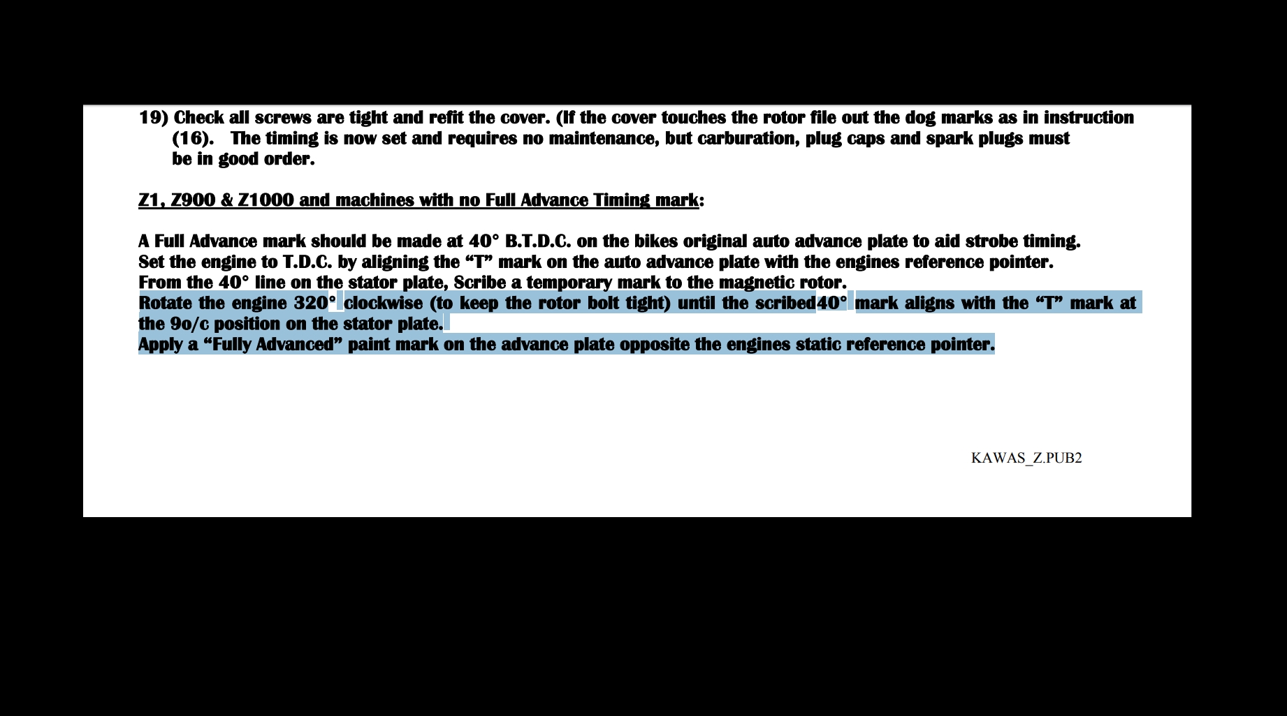

Ok Rolf I have given this some thought and have a much easier solution if you don't mind spending a little money. The set up in the instructions is long winded and "how do you rotate the engine 320 degrees exactly" without a timing protractor set up on the crank
- Firstly set the motor to TDC using the factory mark on the advancer
- Set the new base plate in the slots as stated in the fitting instructions
- Align the new rotor as per Scirocco's post ensuring the line through the magnets is the same as the line through the pick ups.
- Use an adjustable timing light with 40 degrees dialled in, run the motor to 5000rpm then use the light and adjust the base plate until the factory TDC mark is aligned
The following user(s) said Thank You: sf4t7, Rolf1976_KZ900

Thank you guys for the help. Wookie that timing light and instructions is the way to go i think. Scirocco : i think you are in to something that i need to maybe file off a little on the slots.Warren : i watched the videos but i wish he had made a vid of using the timinglight .The timingplate in the video is not the same as i have i and the box is red mine is blue. I think i misunderstod the instructions making the scribed timingmarks.
I think it is supposed to make a white mark on the advancer unit .notb the marking on the case? But not sure that helps because the scribed mark moves anticlockwise. If i had made a 40 degree mark on the right side of the timingplate oposite of the gold ingraved 40 degree mark that is on the left side of timingplate maybe i could time it with the mark in the casing. Anyway now im going for a ride and check some more how the bike runs.

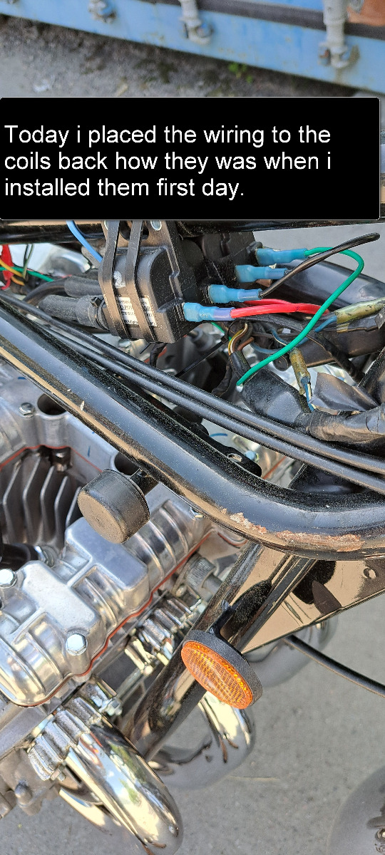

What a mess just discovered that the way i connected the wiring at the coils is still wrong.The red wire from battery should be placed at the +connector on the coil when looking at the picture it is connected to a - connector same is for the green wire from the pickup coil that is connected to a +positve connector at the coil. How did i manage that????

But now i just discovered that i never had the wiring to the new boyer coils mounted the right way.
The boyer instructions is confusing because of the drawing on how to connect the wiring to the coils ,but i see now that it must be wrong because it is stamped + and - at the connectors on the coils.Now i have the red positive wire from battery connected to the - on the coils and the green wire connected to + that should be connected to a -. Not sure how i managed that mistake but did se the + and - markings on the coils now . About the hot starts it is backfiring into carbs and makes a loud mechanical noise and feels like the starter engine blows up like the engine tries to run backward
