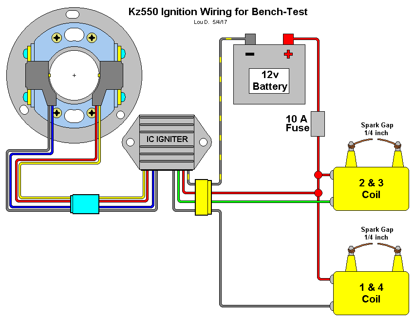

Igniter failure is rare but can happen.
You can test it by simply tapping lightly on the pickups with a screwdriver where the rotor point passes by. That's the pole-piece of the pickup. That should create a spark.
You can test it off the bike to verify the wiring.
