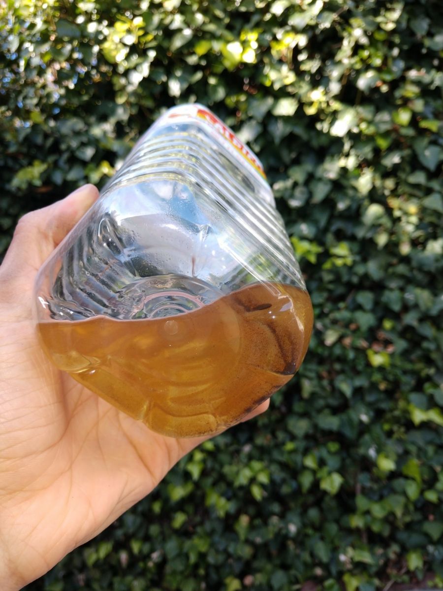

used some Valvoline starter fluid.
tried one time, didnt spray good enough, kinda hard to spray into the carbs from the airbox when the can has no straw nozzle.
second time, tried my best to get a little bit in each carb and it fired up for like a second and a half.
3rd time no luck
this is what the gas looked like from the bowls
not sure if it carried gunk from the drainage lines, or from the bowl, or a bit of both.
what do you think?

Prob a combination of both.
Once it starts, you should be able to keep it idling with periodic spurts of ether into the airbox. But it does take some experience to get it just right.
If it just absolutely won't keep idling, then you might need to do some electrical troubleshooting.

Looking at that rust looks like you might need to clean out your carbs and fuel tank . You need to install those intake manifolds anyways .

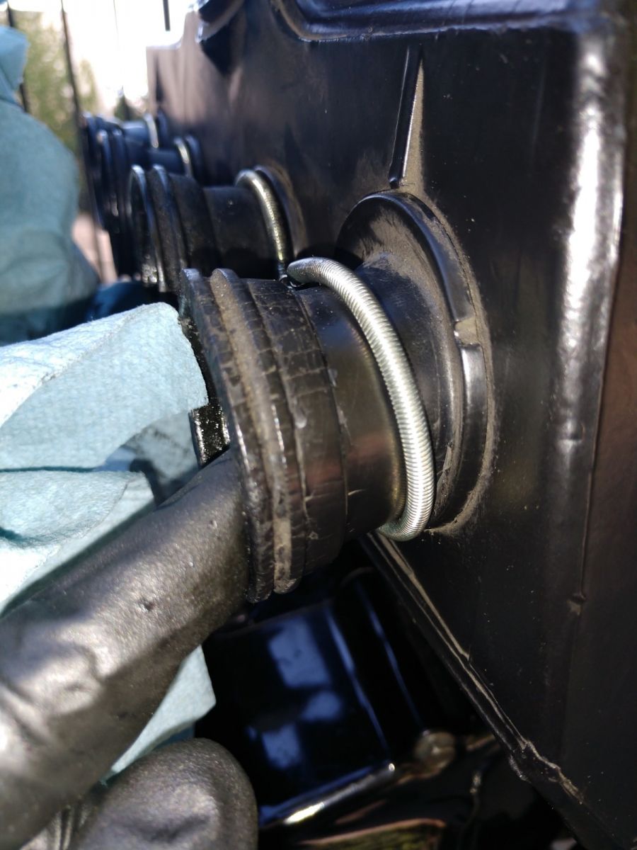

will check after the carbs,
how do I wrestle the carbs off. seems like I'm making progress at the same time not.
possible with the airbox on?
1981 Kawasaki GPZ550 (KZ550D-1)

You have to loosen the battery box bolts and remove the small brackets holding the airbox. Also loosen anything else that might stop the air box from moving. The airbox stays in place but you have to try to push it rearward as much as possible.
Loosen the carb clamps all the way... Not just loose, but almost off completely. Roll the spring clamps off the boot rings.
Take the tank off. Put bike in center stand. Sit on the seat and put your feet on the ignition housing and alternator housing. Pull back hard on the rack into the airbox and tip the carbs out of the intake. Sometimes I tip up, sometimes down.

Managed to get it off without messing with the battery box.
turns out if you ask it nicely it will just pop out.
my airbox boots are fairly hard. if I manage to clean the carbs today could I reuse them? or should I just order new ones. are the Z1 ENT. ones good?
