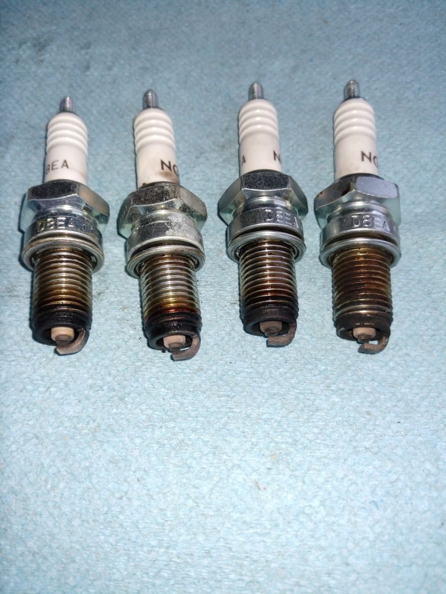

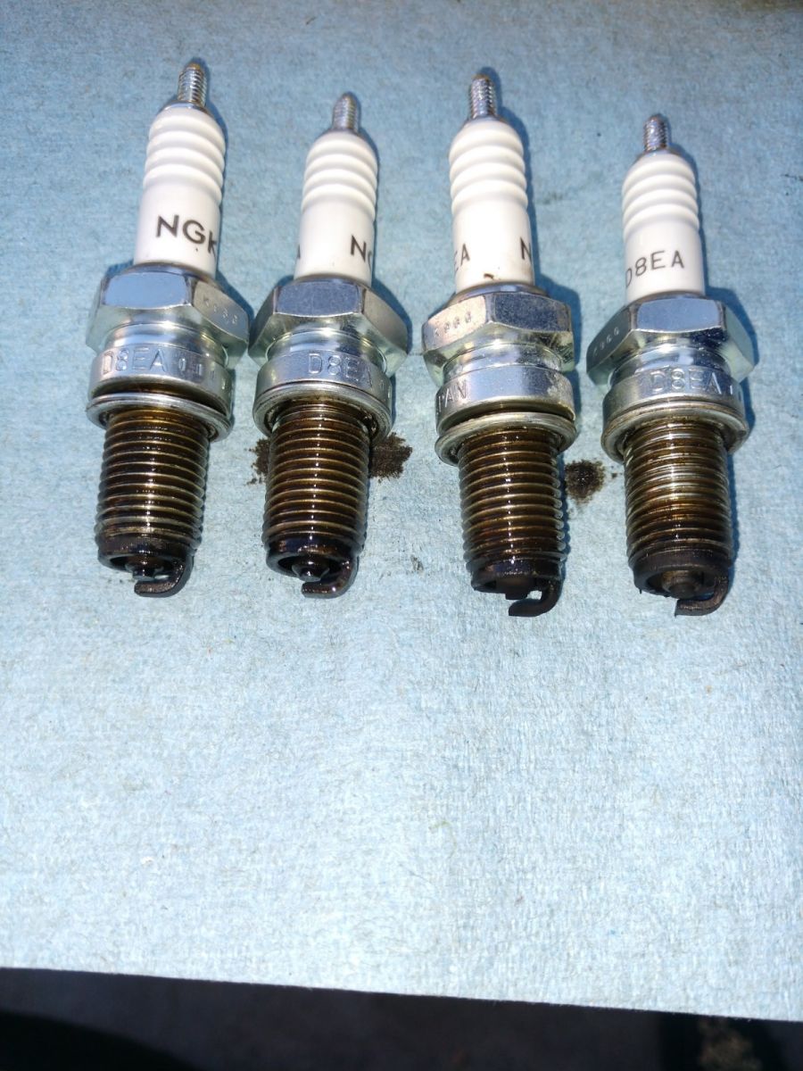

So I've flooded my engine, I was going to replace the plugs and try again. but realized I should probably give time for the chambers to clear out and maybe try again tomorrow.
Should I just replace the plugs? even worth trying to clean up? luckily I have a spare set.
before
after
no luck today, maybe tomorrow will be a better day.

Well, definitely getting some amount of fuel.

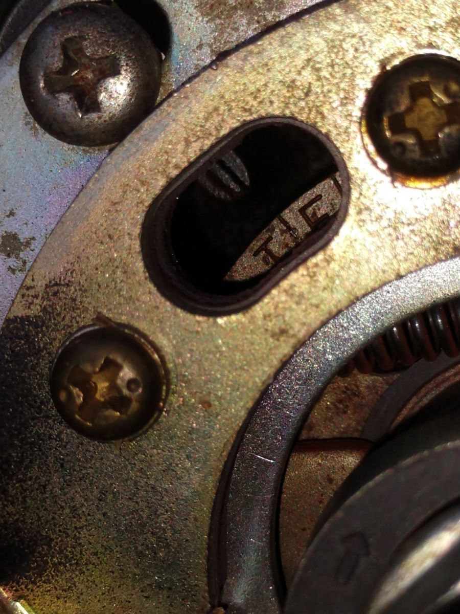

So using the spark plug hole as reference, when the first cyl (far left) is at the top of the stroke, the rotor (I also assume you mean the little tick above the plate that spins)
indicator will be at the T which I assume that's correct but at the same time doesn't aline with what you said.
when the indicator is pointed at the TEC logo, the intake valve is open, hard to see how far the piston is on the stroke tho.
does this seem correct?

From what I can see, the ignition rotor appears to be correct.
When the "F" mark lines up, the point of the rotor should be pointing toward the pickup with the blue and black wires.
