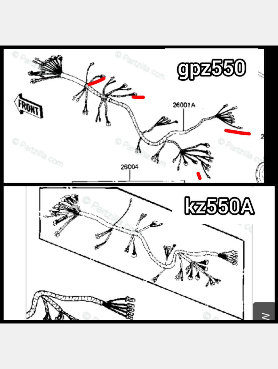

does anyone know the cross compatibility for the 81 gpz harness?
I think there might be an KZ550-A2 one on partzilla. here's a side by side with some of the differences I see, not quite sure what the extra connections are for
also found a new wiring harness made for the z400fx, another similar bike.
Making my own harness might be way out of my skill range, might end in a disaster, but that is probably the best option. Might even have to get someone to make me one, don't know where I'd find that person lol

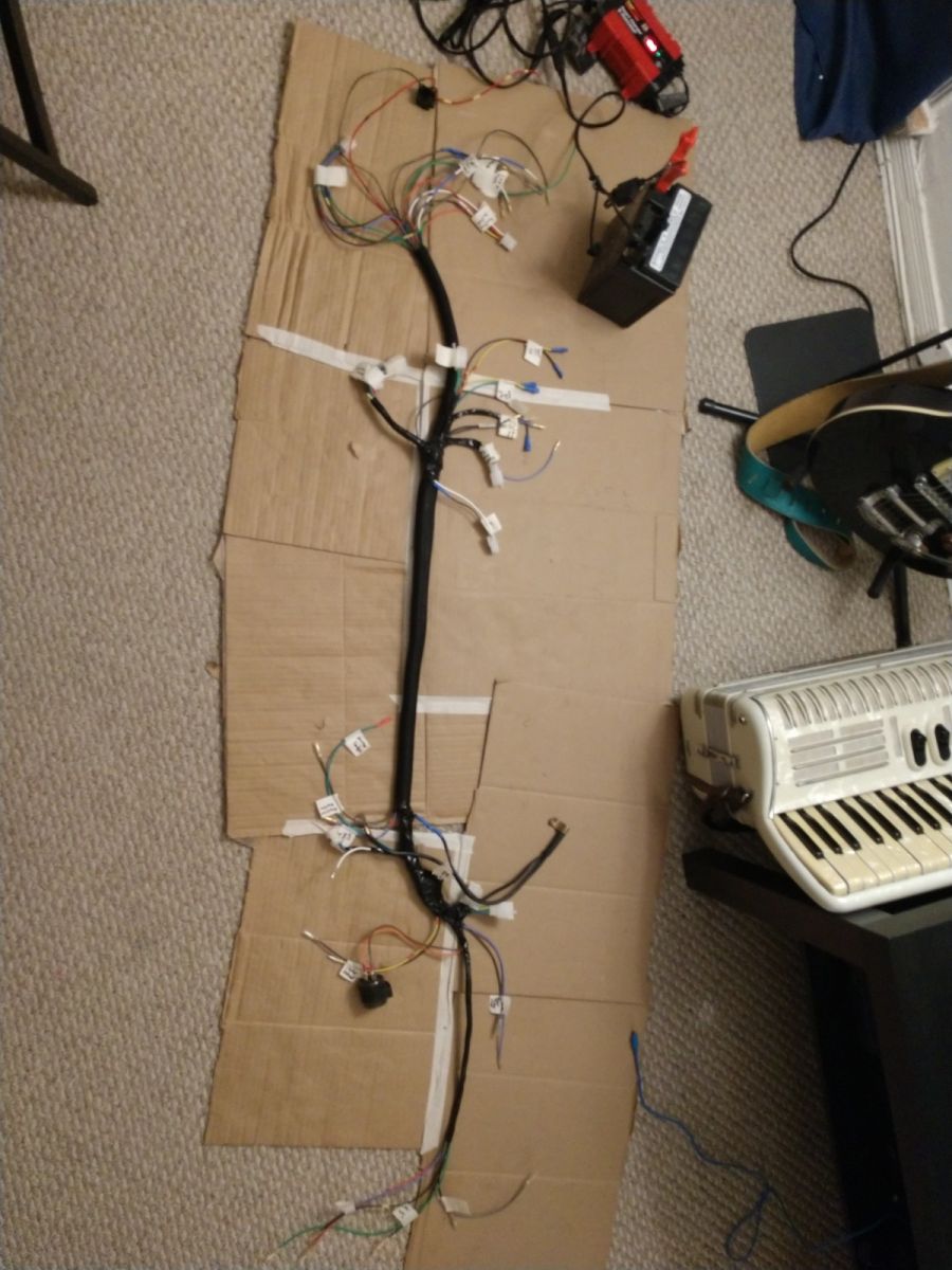

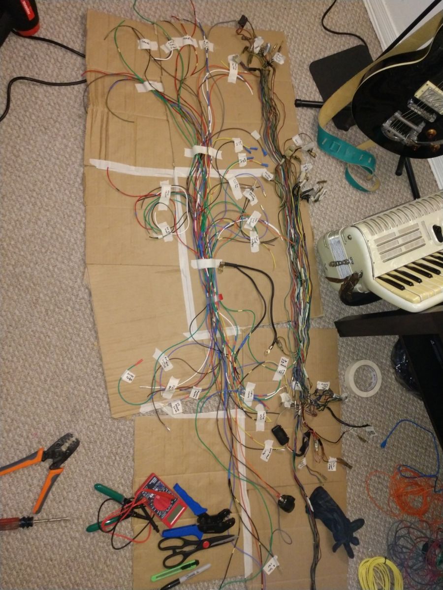

So I took the route of making my own wire harness, came out pretty decently I would like to say. Used 18 gauge AWG for almost everything, and reused the old negative and positive terminals. Tested each wire after finishing using resistance (my crappy multimeter doesn't have a continuity tester). and all seems good.
bike has been sitting for almost a month now.
I get everything plugged in, and my new harness fits better than the old one. used heat res wire loom, which looks nice. also replaced the old starter solenoid with a new one.
I finish up, turn the key, and no power.
I am sad.
the battery I put on my fairly cheap charger/ maintainer (everstart or something like that), reads 90% then after a minute will give me a fault code F01. which some say it means dead battery cells.
I'm just surprised I'm getting no power at all? Can a battery just crap out like that?
I'll try replacing the battery, then check all the connections. after that I have absolutely no idea what to do next.
I am sad.
