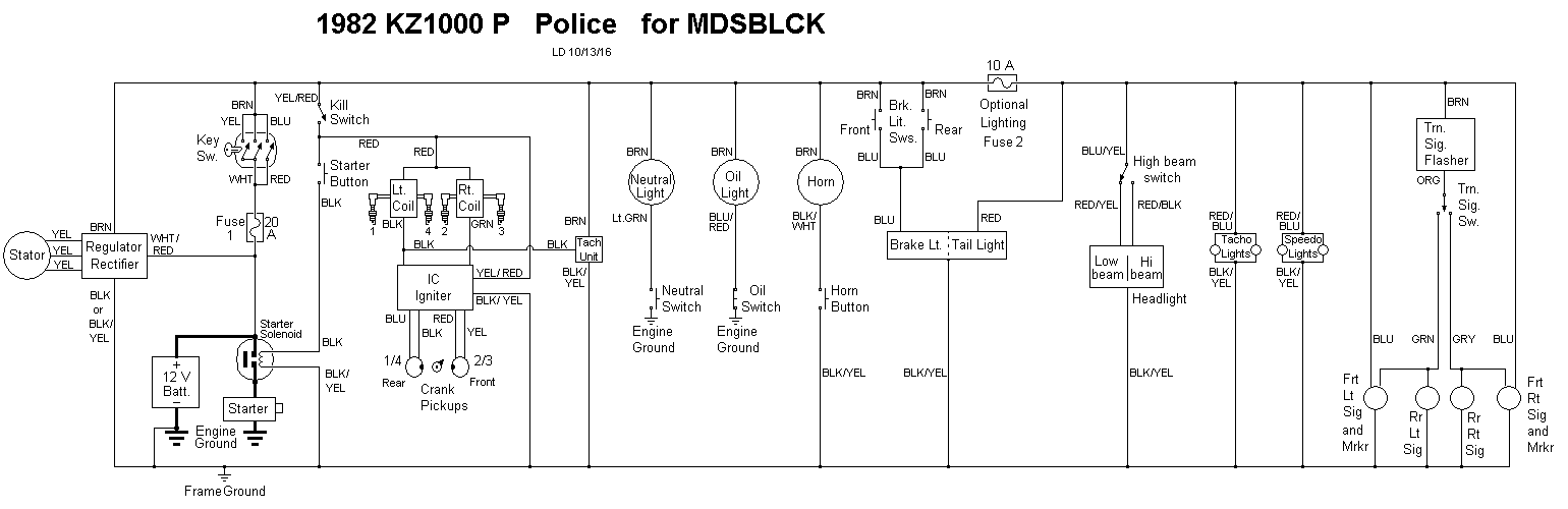

15 Oct 2016 07:39 - 15 Oct 2016 07:57MDSBLCK wrote: Oh, was just thinking - will the odometer work as-is or would that need some sort of wiring? I took apart the gauges to look at the wiring and currently it looks like a light green and a red wire goes to my odometer, is that right?
Also, where would be the best place for a light circuit fuse on this diagram, if I were to decide to do that?
Thanks again. Really appreciate all the help here!
According to the factory diagram, that light green wire and red wire, in the speedo, are for the self cancelling turn signal unit. They detect distance traveled to automatically cancel the turn signal. (It must be some combination of distance and speed, actually, since turning from a stop, you'd want to cancel it after a short distance, and on the highway, for a lane change, you'd want to cancel after a much longer distance.) You can just leave them unconnected.

Here is an optional fuse for the lighting. I think 10 amps should do it.
The horn is not fused since it might pop a 10 A fuse.
You don't want the brake lights fused, for safety reasons.

As always, many thanks, sir!

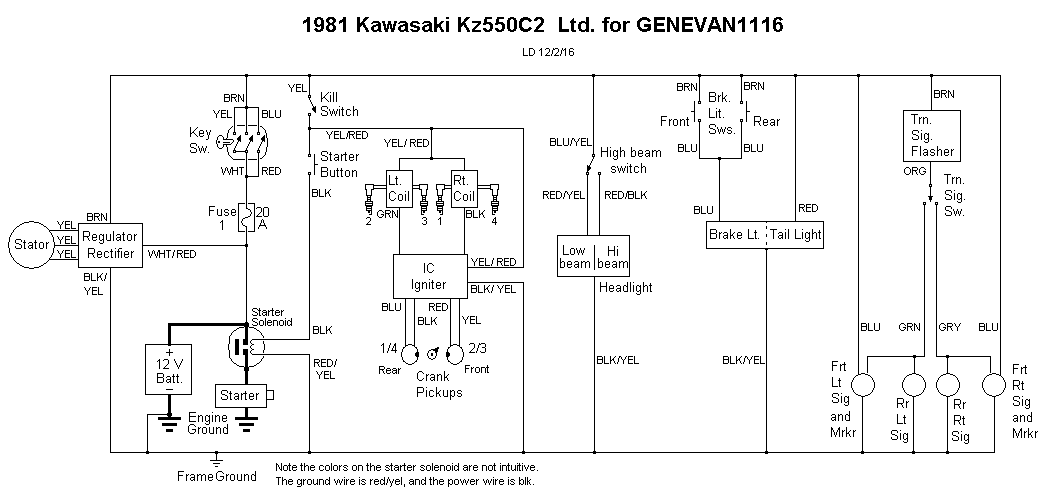

1981 Kawasaki Kz550C2 Ltd. for GENEVAN1116
LD 12/2/16
