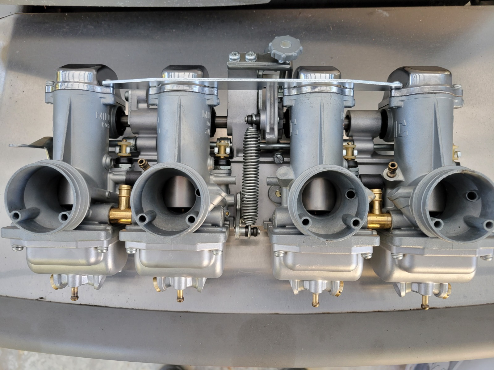

I bought two sets within an hour this week. I was actually searching for carbs for a member here, but when coming across these two sets, I couldn't resist (and no, the member here wasn't looking for VM26's.)
The first set to arrive were these. -1 on that purchase (although it's all good as a parts set, after price reduction.)
Set two are some early VM26's, the version with the plate that joins the carbs across the top caps. '77 I think, or close. This set is one of the cleanest I've ever purchased. The O-rings were crumbling, but there was NO varnish inside whatsoever, and very little corrosion. I just finished bead blasting them, and it was a MUCH easier job than most other sets I've done. Stay tuned for photos in a few days.

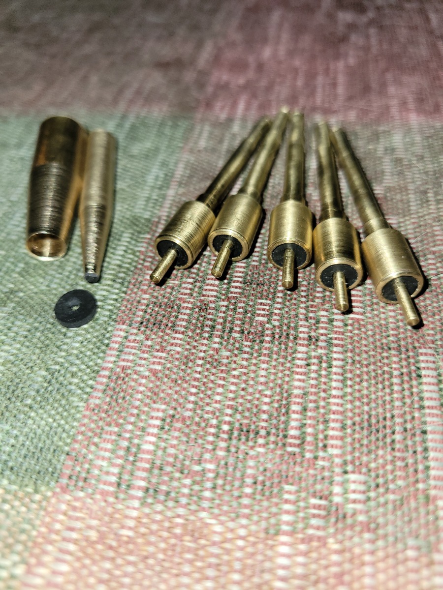

Oh, and I'm working to make the appropriate tools to replace the choke plunger rubber seals. I bought a sheet of Viton rubber per Kaitit's led, and next I need to make the punch tools. Looking forward to growing my skills on this detail.

1976 A4-A5 & LTD Also the 1977A1 had VM26SS with the top carburetor connection plate. They need to have air pilot screws to be correct.
