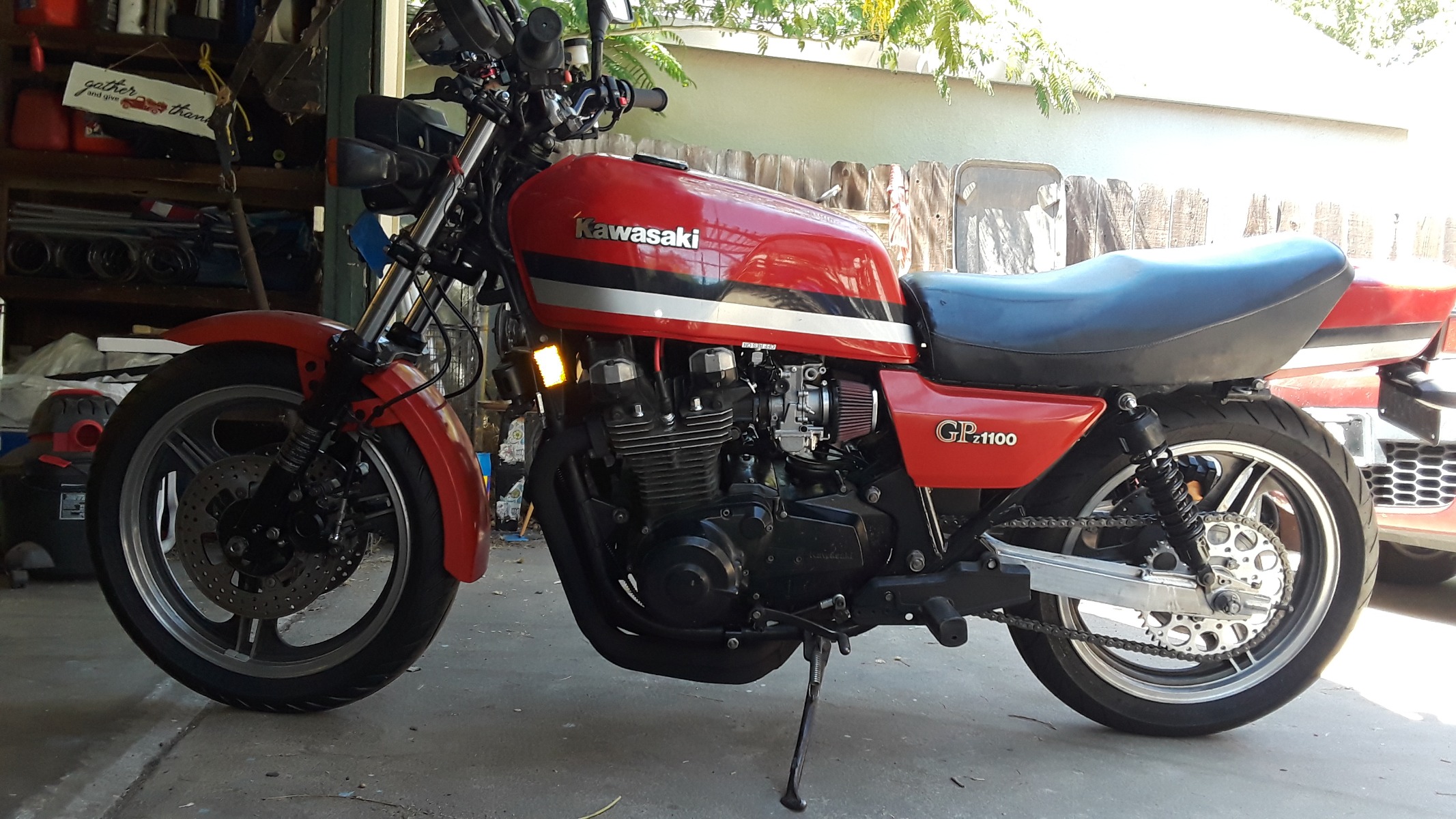

All,
I'm currently running Mic RS34 FS on my 81 GPZ1100, and find them to perform fine, however, they are extremely heavy/stiff in operation. I find I can't really blip the throttle fast and without heavy return springs they stick open. I also get wrist fatigue after about 45 minutes and it just makes for an unpleasant experience. I have adjusted them, reduced the spring tension, lubed the cables, routed the cables as straight as possible but it still is just too stiff. What I'm thinking (and hoping) is that the CR's are less stiff and easier on the wrist. I haven't used them before so I have no experience to go on, and would hate to buy them and find out they suck/are super stiff as well.
Performance wise the RS34 are great, easy to adjust make great power. I've even thought of making a servo helper or some kind of vacuum assist. I know CV's are far lighter, the BS34, and I might eventually have to go that route. There is noway I'm reverting to that lousy FI system though.
My question is anybody running the CR's could chime in on their operation and extended ride use.
Thanks
577Nitro
Thanks

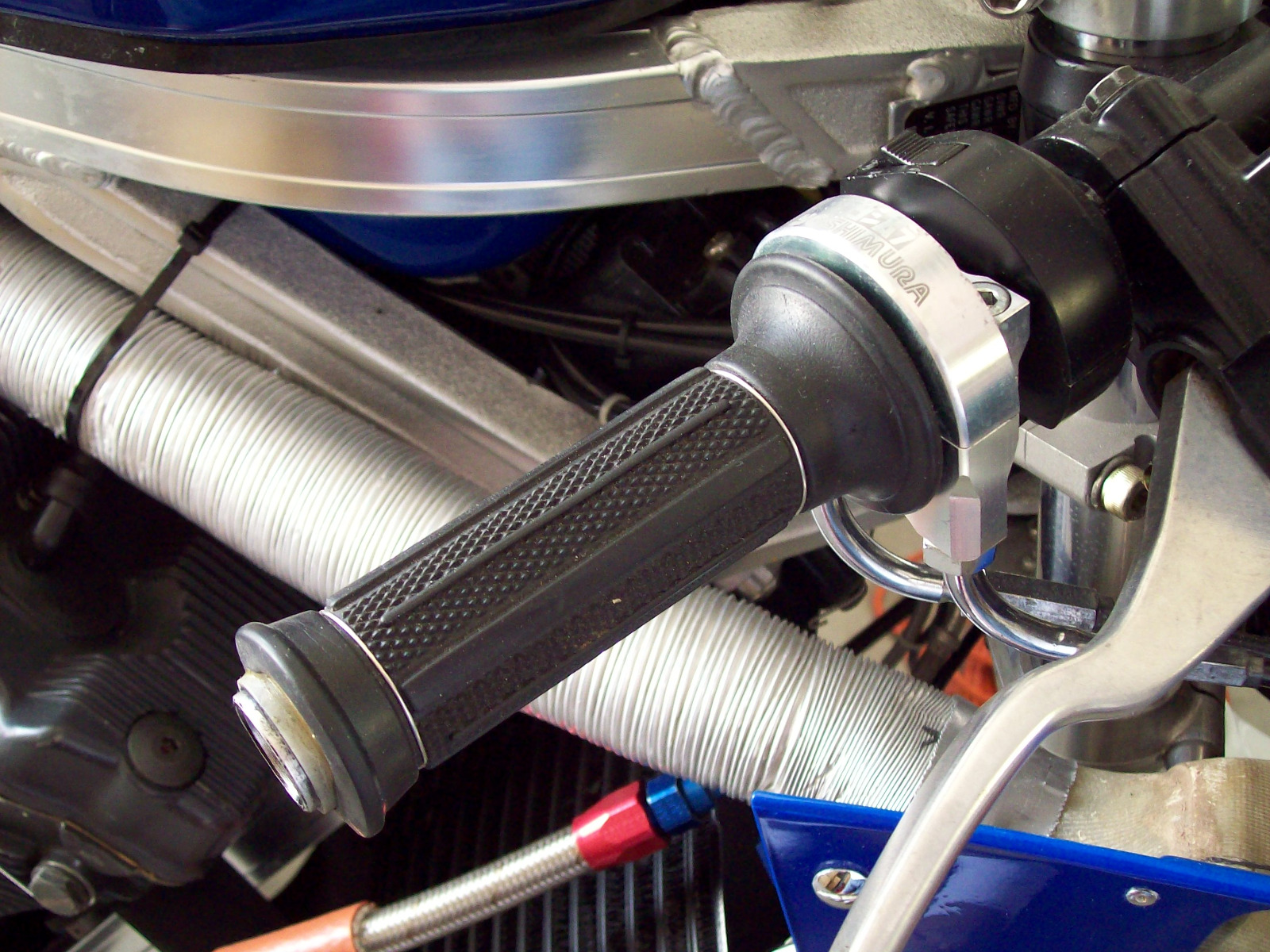

I have a set of Mikuni RS36's on my early model GSXR750 and a set of Keihin CR33's on my Kz1000 Superbike. I just went out to the garage and checked to see if there was any difference in the amount of effort it took to open both sets of carbs. I have the very same type of 1/8~1/4 turn throttles on both bikes. There is very very little difference between the two!!!
The RS36's take a tad more effort to open them. I am talking a very minute difference between the two. I never had to deal with any type of discomfort on long rides on the GSXR750 with that throttle. I use O.E.M. Kawasaki cables on both bikes. The GSXR750 uses Kz1000D1 (Z1r) cables 54012-1018 and 54012-1019. The Kz1000 uses Kz1000S1 cables 54012-1030 and 54012-1031. I must have tried 5 or 6 different length cables till I found the perfect length!!!
The GSXR750 uses the billet throttle from Yoshimura they offered for that bike many moons ago. I had a Motion Pro throttle on the Kz1000 at first. WHAT A PIECE OF JUNK!!!!! I even reworked the Motion Pro body to except O.E.M. type thread in cables. The Motion Pro throttle was like opening a bear trap. I scrapped it after I found an early billet prototype Yoshimura throttle. Both Yoshimura throttles use the very same throttle sleeves. As soon as I installed the Yoshimura throttle on the Kz1000 it was as easy to open as the GSXR was!!!!
My suggestion is if you are using a Motion Pro throttle and their cables I would scrap them. Find yourself a high quality 1/8~1/4 throttle and a pair of correct length cables. I have seen copies of the billet Yoshimura throttles for sale in a few places. When I say correct length cables what I mean as you move the handlebars from lock to lock they do not get get tight in one spot or put a sharp bend into the cables. The Motion Pro cables are no where near the quality of the O.E.M. brand cables. I don't want to tell you what I paid for a NLA O.E.M. Kawasaki Z1r closing cable and clutch cable!!!!
The GSXR750 with the Yoshimura throttle and Z1r cables.
The Kz1000 with the Yoshimura throttle and Kz1000S1 cables.
