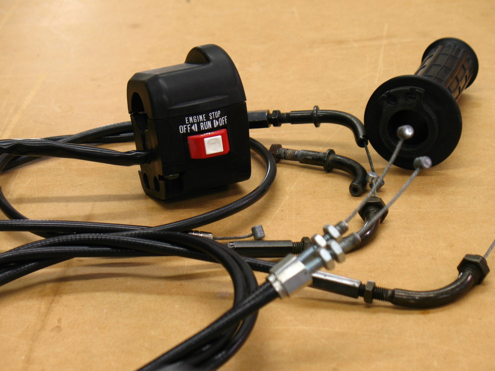

Ran into that difficulty in 2016 while searching for cables for a ZN1100 dual-cable control housing which I chose to use with my RS carbs.
Nothing was (and nothing yet is) available for that setup...only option was to custom build them.
I'm still dumbfounded by how well they work.

What cables did you use? Is there some sort stock that can be used to fabricate the cables??

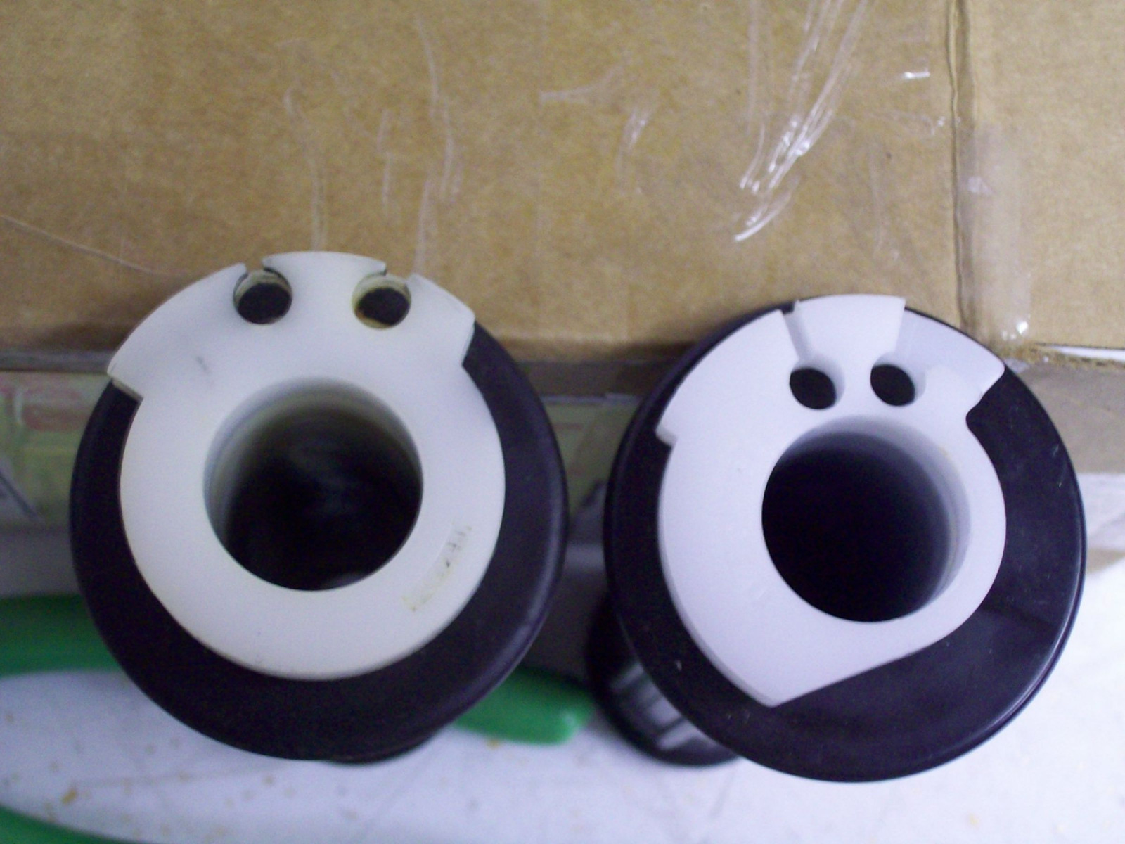

What throttle tube did you get with the Yoshimura throttle???
Mine came with the one on the left.

I would say the throttle tube design on the right side is the Yoshi part.....
