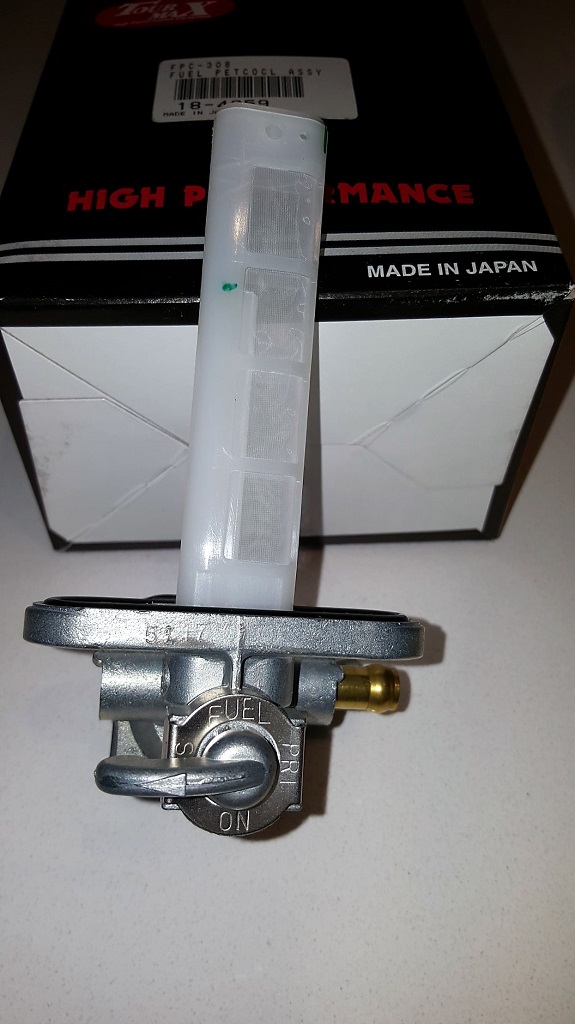

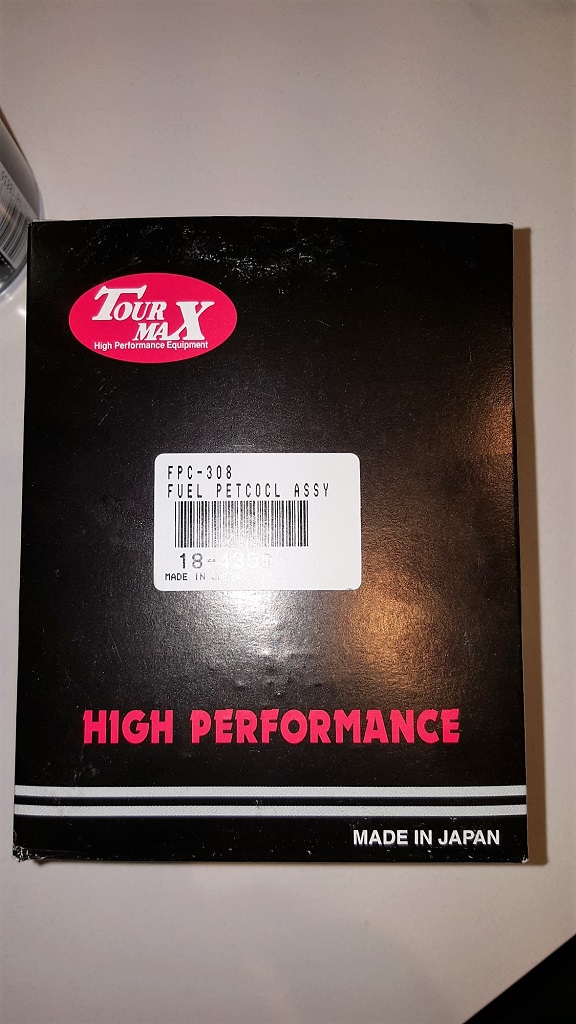

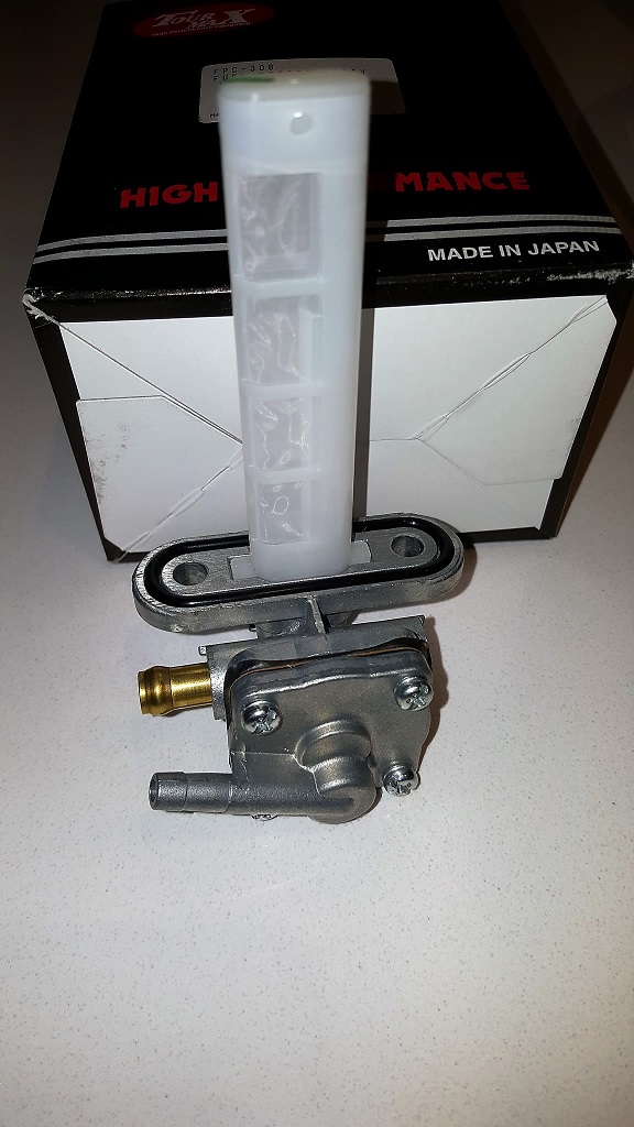

Hey Steve. Pics? You want pics? Well, I got pics for ya:
Made in Japan even! Nice!
Pretty much same thing as what I had but handle is a little smaller which I actually like more anyway.
The vacuum port is apparently an interference on some models with the frame but it can be (and has been) rotated to different positions

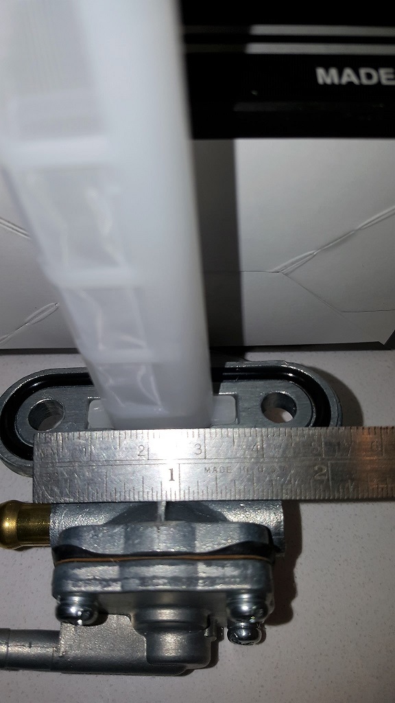

Crappy photo but it is actually 44mm c/c on mounts so should be a straight shot onto tank.

Looks good. Made in Japan no less, not in CHINA. :woohoo:

Yes. That was the first thing I noticed too. Sigh of relief!
The operation of the valve/handle is snug but smooth and given that others here on the forum have been running it for months to years without problems, I'm pretty hopeful that I'll join the ranks of functional petcock that works as intended.

Yep that's the one remember the box now... couldn't remember was thinking Japan but couldn't remember for sure so I kept quiet... rear facing outlet works out great with a approx a 9 inch to one foot piece of line gently angled and looped around and straight into a filter then into the carbs with no kinks.

Maybe a filter with a 90 degree angle would help from kinking the line for your application
