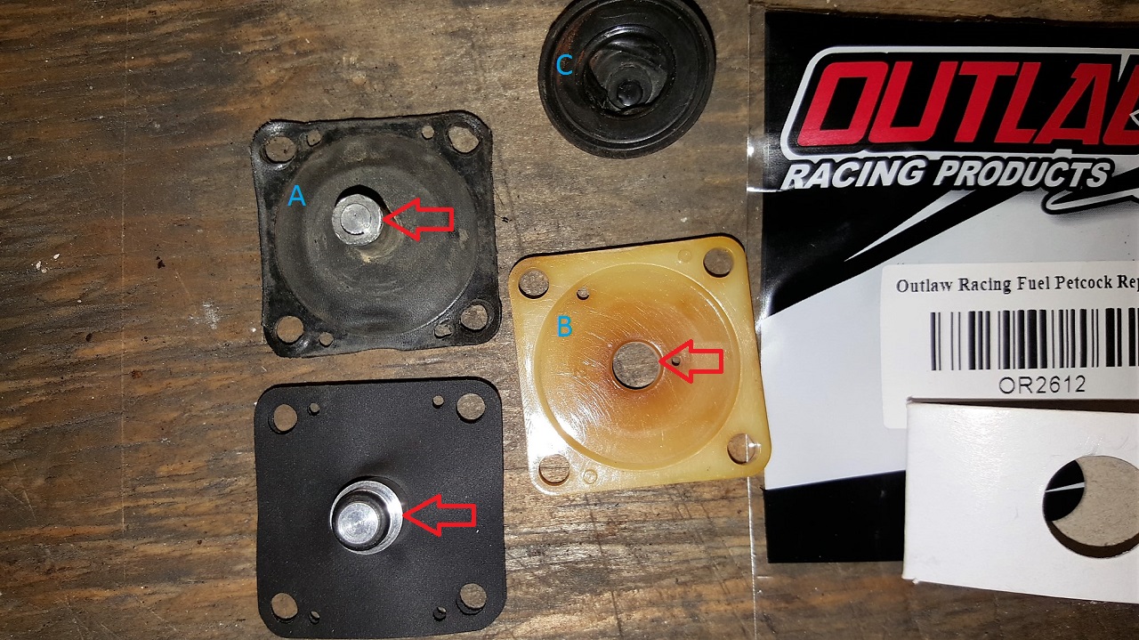

Well, my mail box was literally over-flowing with parts deliveries today and among them was the parts for the petcock rebuild. Yay!
Then I opened them all up and laid them out on the workbench and ran into a snafu:
Diaphram (A) is original. It fit through plastic part (B) and then into rubber cup-like piece (C).
The new diaphram doesn't have a part (C) but it does have a rubber O-ring. I guess, I can see how this would still work by replacing the (C) rubber cup part with a simpler O-ring, however, the shaft diameter of the new diaphram is larger than the original and so the new diaphram will not fit through the plastic plate's hole. If I slip the O-ring off, I can just barely get the tip of the new diaphram to fit into the plastic plate's hole.
I'm further confused by another issue which is not shown.
On the backside of the plastic part it is smooth-flat unlike the front side where there's a recess for the metal plate of the diaphram. The backside fits snug up to the body of the petcock but the petcock has a recess for that rubber cup (C) to fit into.
So, I envision that rubber cup seals fuel from the plastic plate and petcock body but with the new diaphram, there's nothing but that O-ring on the "backside" assuming I could press it through the hole in the first place. Thus, I believe that if I were to have assembled it, the plastic plate would leak around the perimeter because that rubber cup isn't there.
Maybe I should just consider that Suzuki part?
I looked back online and every single diaphram I can find, has this thicker shaft section with the small O-ring instead of my KZ's design.
Is the new diaphram supposed to separate? I noticed that it has two layers of rubber and they're separated by a fraction of an inch space. I can't measure it though. But it made me wonder; is this new diaphram supposed to somehow unscrew or pull apart of something and be installed sandwich-style to front side and back side of the plastic plate and then compressed together? This would seem to seal-off the backside of the plate against the petcock body.
At least the new air filter fit and my new fuel lines and vacuum lines fit.

On my 750 petcock the plastic part B fit between the different layers of the diaphragm. Those parts don't look like OEM though so good luck to you.

Your bike has what I call the hat diaphragm --- that rubber piece looks like a top hat.
The diaphragm plate hole is too small for the later diaphragms.
The replacement diaphragm is one piece --- the o-ring plunger is supposed to fit thru the hole of the later diaphragm plates which have a bigger hole.
I would get a replacement petcock or manual fuel valve.

Okay, so the the original petcock will only work with that "top hat" style plunger part then?
That is, if I replace the diaphram with [ This exact diaphram ] would it work or no?
All the diaphrams I can search for look like this style but that one includes the plastic plate already sandwiched between the rubber. I just don't know if that small rubber O-ring will function the same as the older style top hat plunger?
It's a shame, that people can advertise this crap as fitting my bike and then be totally wrong.
Or is the problem my petcock is not OEM? Is that what you meant Ness? In your list of parts above, the diaphram looks like this one but it's just a small picture, not a link to the actual part, so when I searched for that part number I found lots of these diaphrams and they all look exactly the same and pretty much all cost the same (within a a couple of bucks anyway)...

If the Suzuki one will work I'd go with that. Sellers will be more than happy to take your money if it fits or not.

I don't know, but I'd guess not. just a guess. someone over at the KZ650.Info site may know. there's a topic over there somewhere but I couldn't find it. doh.

Did you try test fitting the new diaphragm to see if the plunger would block the fuel flow opening? test fit without the plate or cover. just curious.
