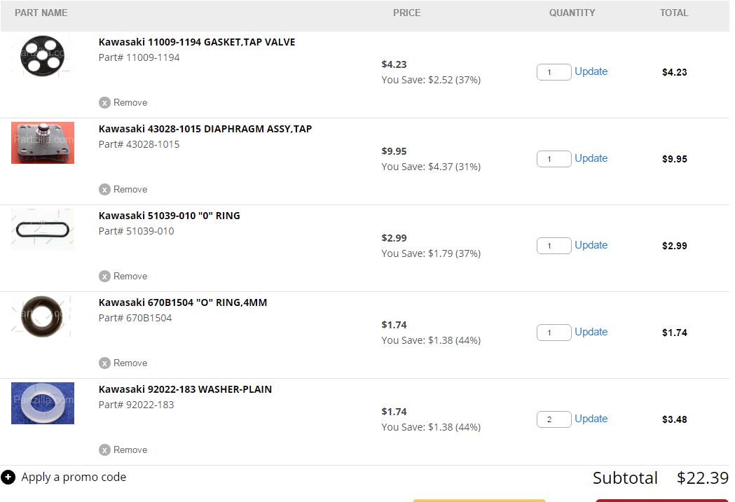

Get that spring that Ed linked from ebay and everything else from your favorite dealership source: Diaphragm, O-ring, tap valve gasket/seal, drain bolt gasket, and don't forget new seals for the screws and a new main petcock seal. Renew all the rubber in other words.
OEM parts are vastly superior to crappy K&L rebuild kits that often don't fit.

- Posts: 7684
- Thanks: 3066
Re: '79 kz650c petcock parts
16 Jun 2016 12:38
