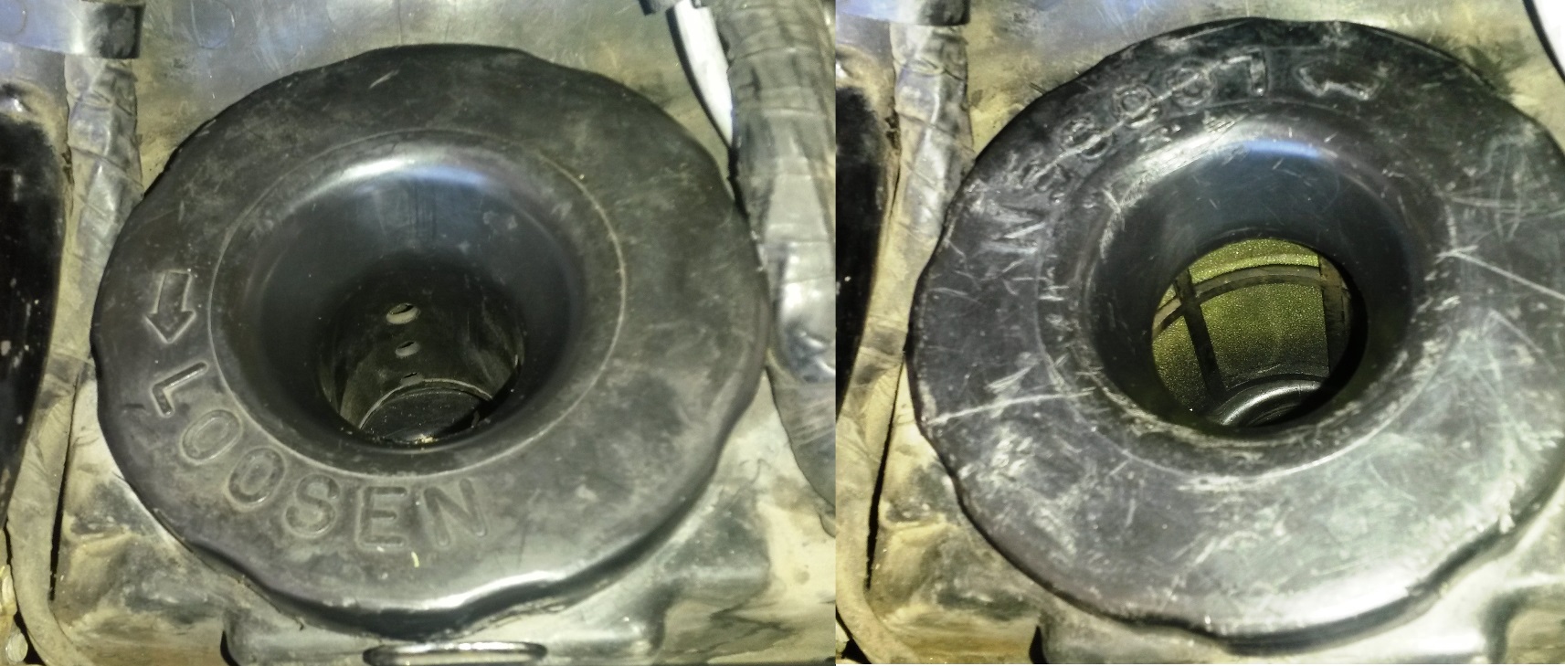

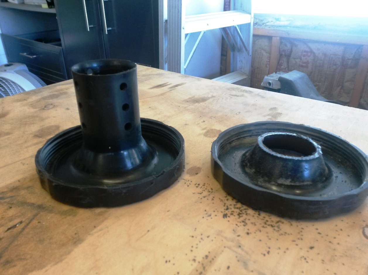

I cut the cap.
Before/after
I took it for a 25 mi. spin and it worked great. I got the snappiness it had before I put the 4-1 on and seems to want to just get there! I think I need to make some pilot screw adjustments but i think we're golden otherwise. I'm definitely not doing anything else until I get my big old Muzzy mounted.

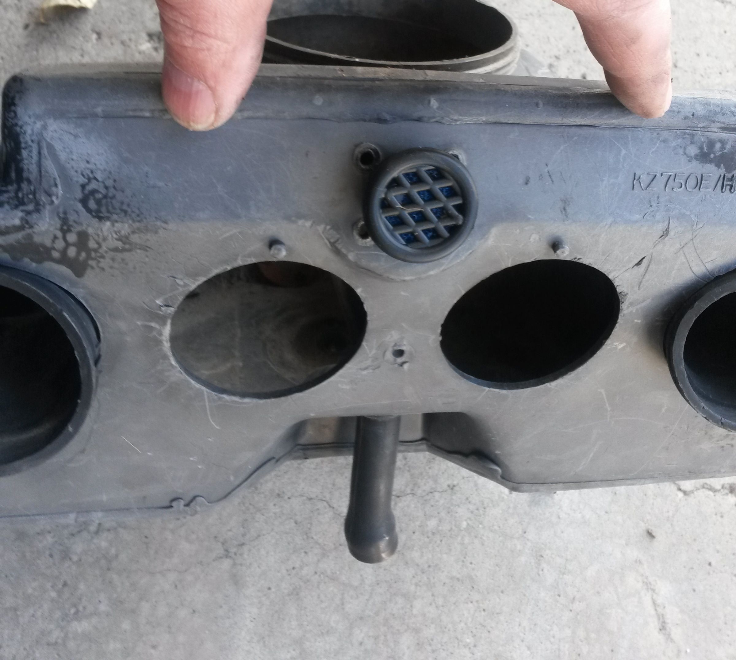

I found the first spot for the UNI vent when the time comes. it just needs to be opened slightly to fit.
And another one could replace the bottom vent tube.
