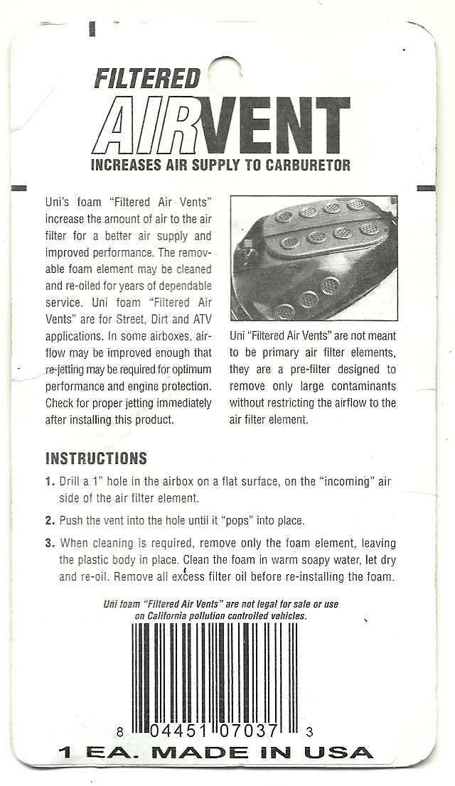

Just got my filters. Small package, they must be tiny. Just got home so I will settle in and check them out. Hot down here. :dry:
- Posts: 23726
- Thanks: 3014
Re: Opening up airbox?
04 May 2016 15:30
These are not filters, they are vents. Being forward of the velocity stacks, the filter should handle most of the air. They will come in when the air box pressure gets close to negative. I bought a can of filter oil so I will clean my filter and oil it but I'm not sure of these vents. :dry:

Yes, they are filtered "vents". They are most commonly put on the pre filter side of an air box. Search around and you will probably find a few examples of installations in the post filter side of a box. I'm going to install them backwards so the screen part is inside of the box, and epoxy them into place. If you are worried about not filtering enough, you could replace the included foam inserts with a higher density foam. I know UNI sells universal foam sheets of varying density.

04 May 2016 18:13JaFlo wrote: Yes, they are filtered "vents". They are most commonly put on the pre filter side of an air box. Search around and you will probably find a few examples of installations in the post filter side of a box. I'm going to install them backwards so the screen part is inside of the box, and epoxy them into place. If you are worried about not filtering enough, you could replace the included foam inserts with a higher density foam. I know UNI sells universal foam sheets of varying density.
I'm not concerned with the filtering. My K&N is porous as well. If I don't like them I can get some snap in plugs. I also have a sheet of open cell foam. It will be fun to see how they work.
