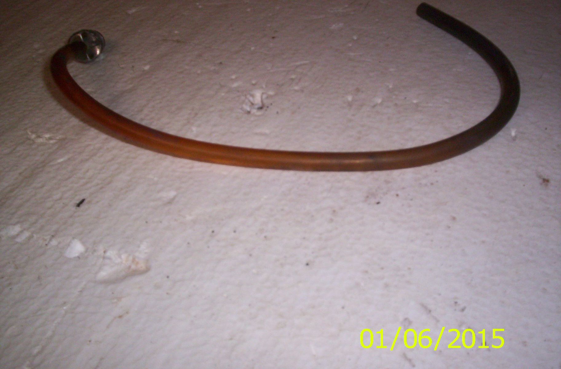

There are two fuel inlets. One on 1 and one on 3. I have floats set all the way to 32mm off base and I tied wire around all four carbs to hold floats in point of contact on needles just barely pushing the springs. Put gas on fuel like and all 4 seat. No leaking. Put bowls on and they run gas out of number 1 and 2. 3 and 4 seem sealed. No floats seem to be taking on gas. I'm about to just replace all needles and seats

Floats are 14.00 at z1. Needle and seats are 20.00. Just don't know what to replace when needles seat and floats float! Gaskets are all there on seats

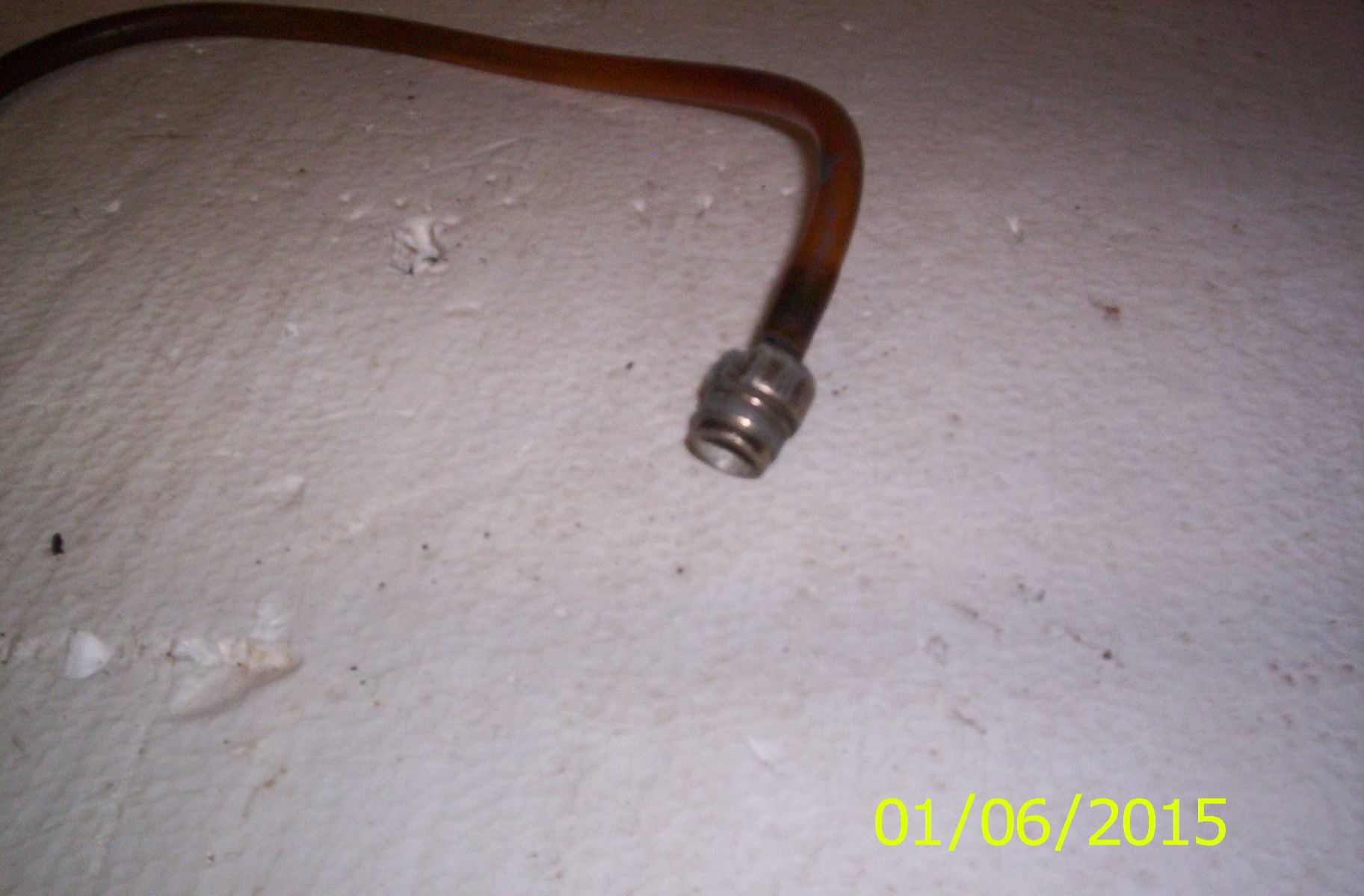

Did you check when there was fuel in the floats? You have to check them with fuel in them to get a acurate reading. I made mine 20 years ago out of a Mini Mag light end. You could get a plastic adapter you can sand down enough to screw in at the hardware store.

I made a clear tube tester from a rubber stopper and weedeater fuel line. I can watch the fuel slowly come up in the line until it runs out of the bore
