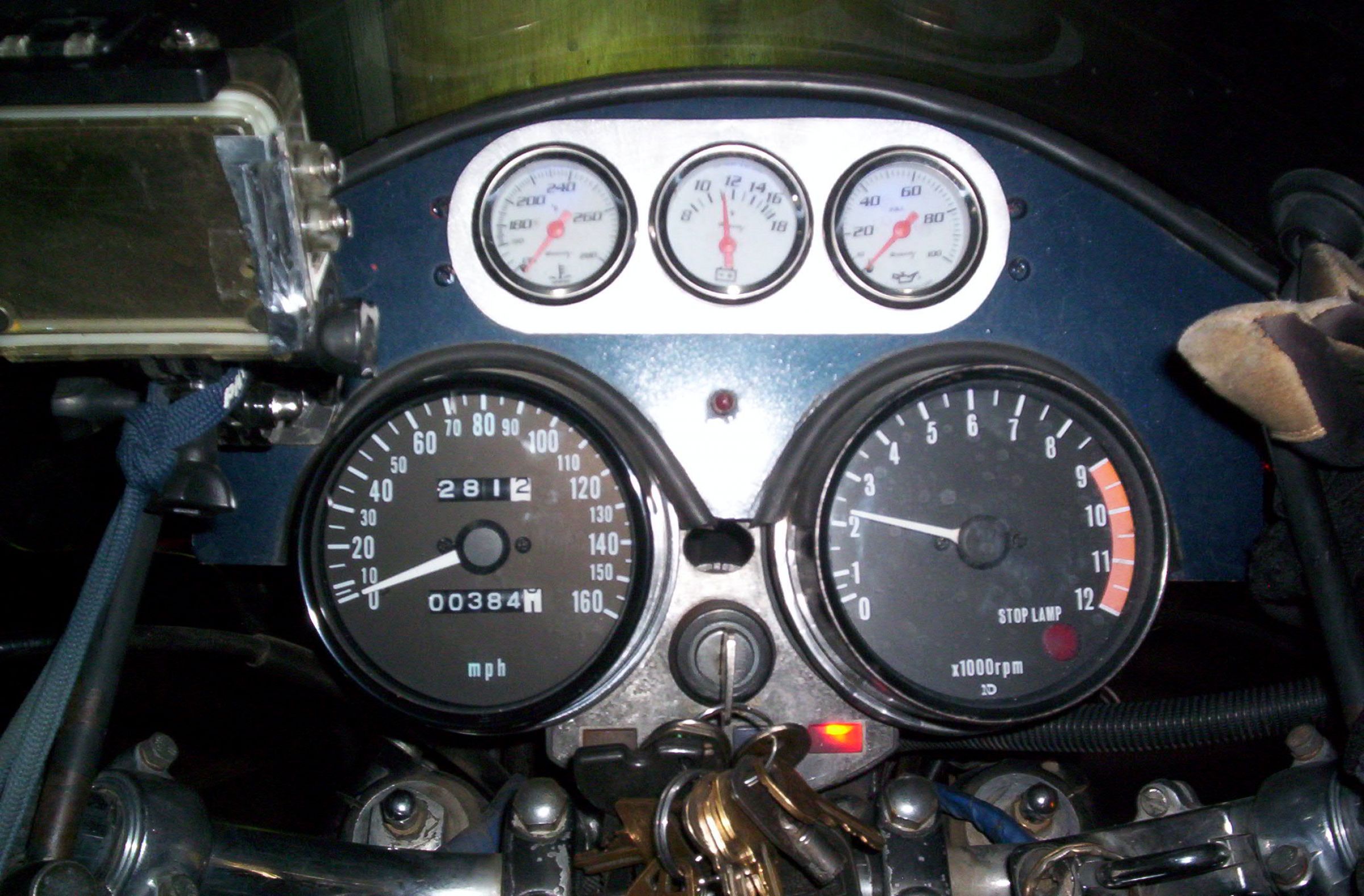

So at work we got these little Slime brand tire repair kit's it's a bottle of green goo
and a small 12 v. air compresser in a cute little bag.
Cost me 12 dollor's so got one plugged it the lighter in the van and hooked it to the air tank
and put 120 psi in the bottle pretty quick it worked a little hard but it did it.
So I took it apart to see what I could cut off the case to make it smaller few min. with a hack saw
it's mounted under the swing arm.
Ya I cut it already.
Used the switch and gauge still need to make a gauge mount but the switch and wiring are done
and the gauge work's. Black switch under the tach to the right turn's it on/off.
Test ride tonight made about 50 shift's and had no issue's about enough air.
