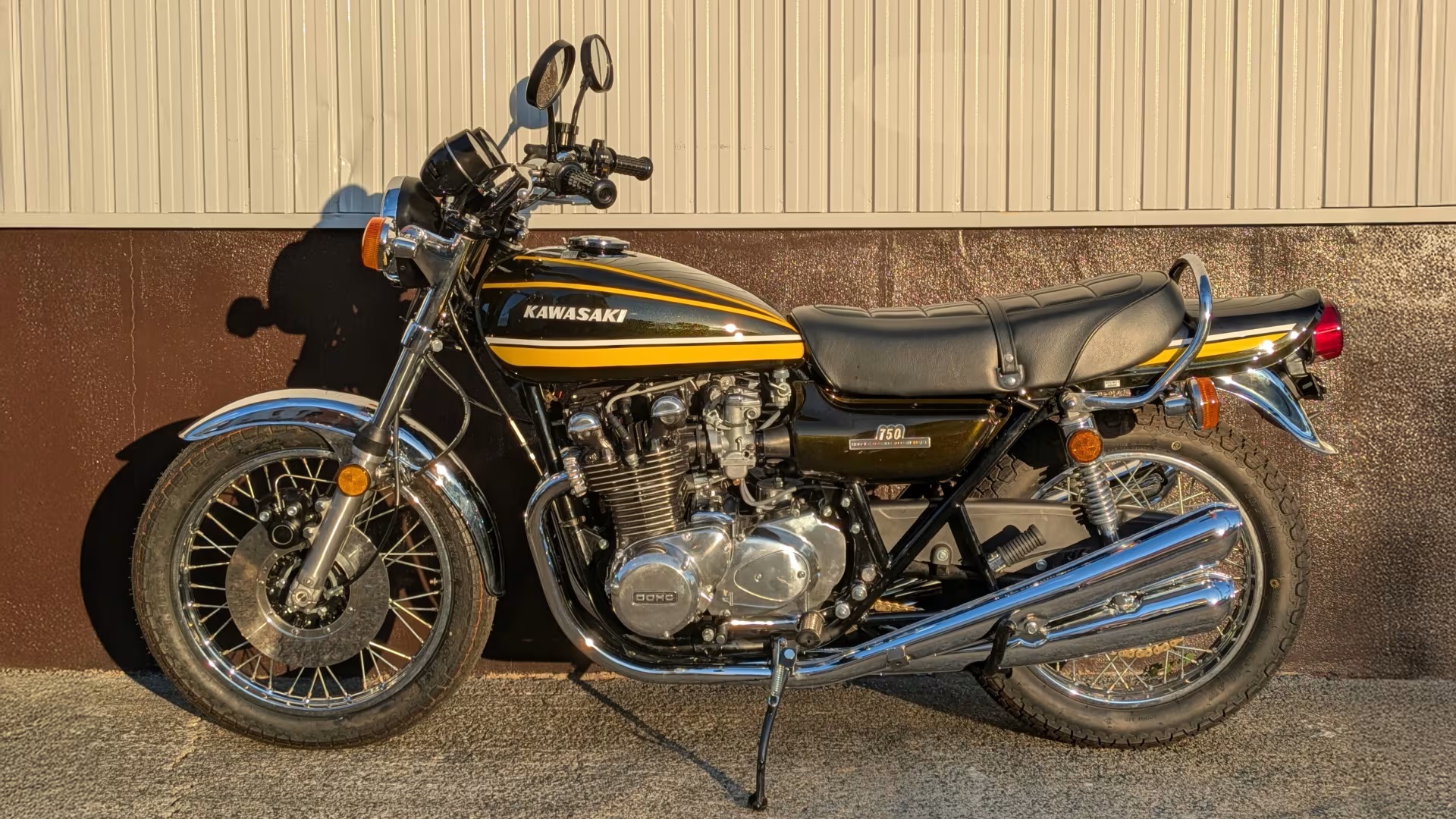

January 30, 2025
www.mecum.com/lots/1137453
Z2F-01161 Z2E-01144

Wrong rear rim and carbs. Drums Don't have MC's

Also wrong front wheel, missing airbox, wrong seat, and so on.......

If they all resemble this one then no way will they get close to the 85K. The one shown is clearly not intended to be original.

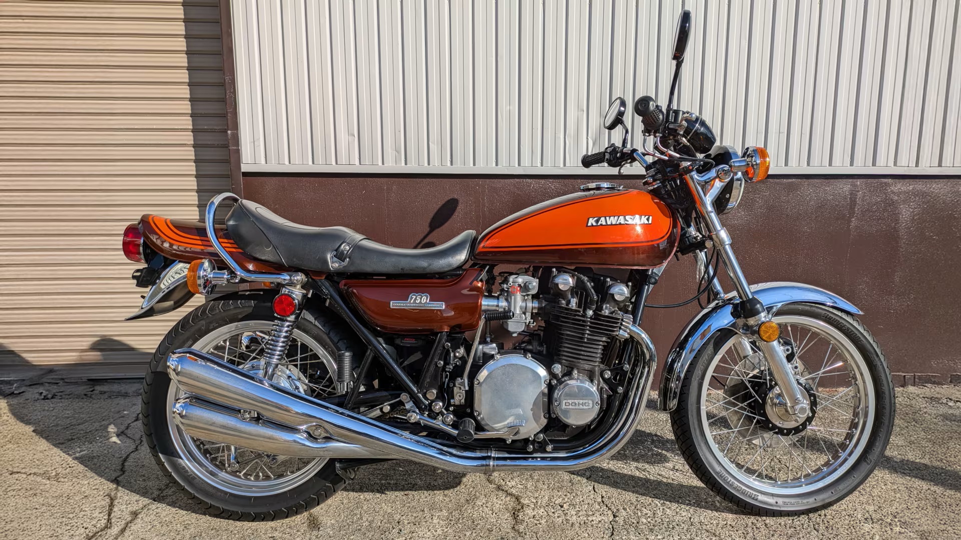

January 30, 2025
www.mecum.com/lots/1137454
Z2F-10195 Z2E-010341

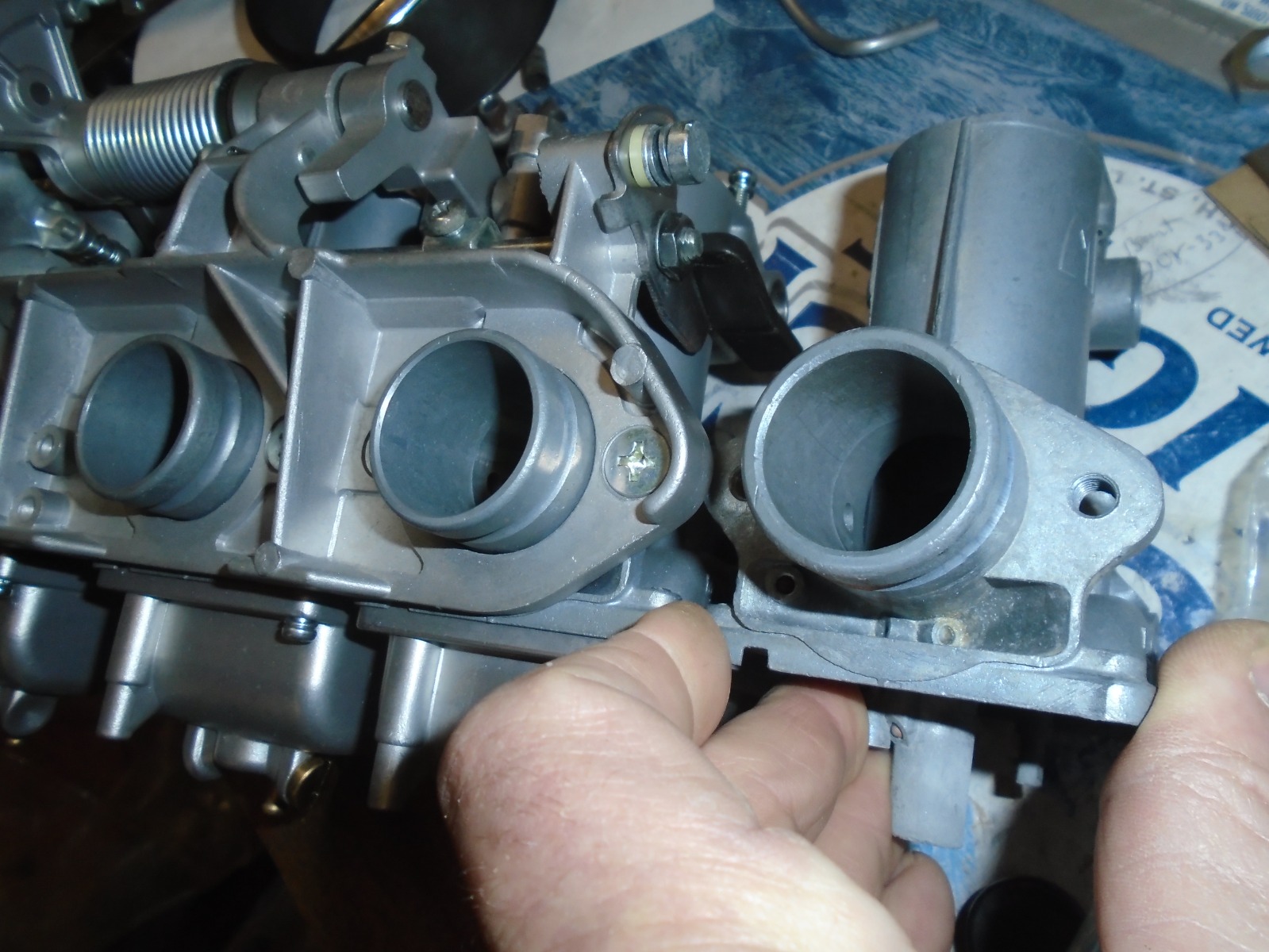

Well 73Z1, getting closer to original but.. Wrong 28mm Z1 carbs, aftermarket gauges/switchblocks/seat/turn signals/etc etc etc.

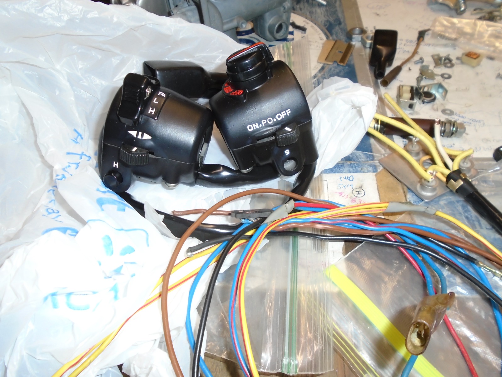

I can't blame the messenger so it won't go on Your permanent record, ha. Note the difference of correct VM26SC while they emphasized the incorrect VM28SC's for no real reason? And what a correct switch set should resemble    .
