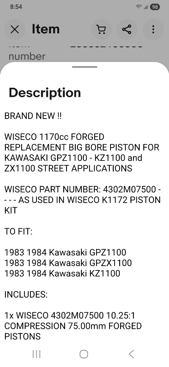

This is the Ebay listing description that lured me in, and hooked me solid in the lip:
LOL!

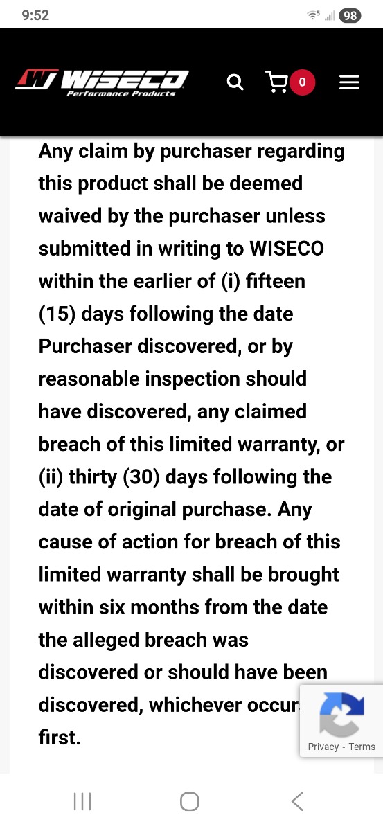

Screenshot below is a brief portion of the lengthy Wiseco warranty (contract?) that I never thought to read until last week...which apparently does NOT apply to my situation:
LOL!

17 Nov 2025 19:41This is what I was referring to.
Yes, and they wanted the pistons to make sure they were made correctly...
According to the tech department, they checked out, so tough tity.
My view is whatever they were compared to is incorrect, and the engineering specs need to be reviewed and revised.
Wiseco is now owned by Race Winning Brands, the same conglomerate that bought Falicon and liquidated it.
WTF!
Sounds to me they are getting rid of the compattion like other suppliers that will remain nameless.

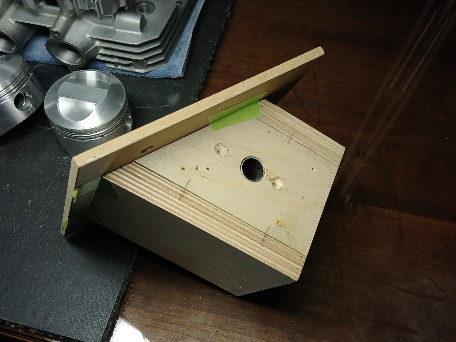

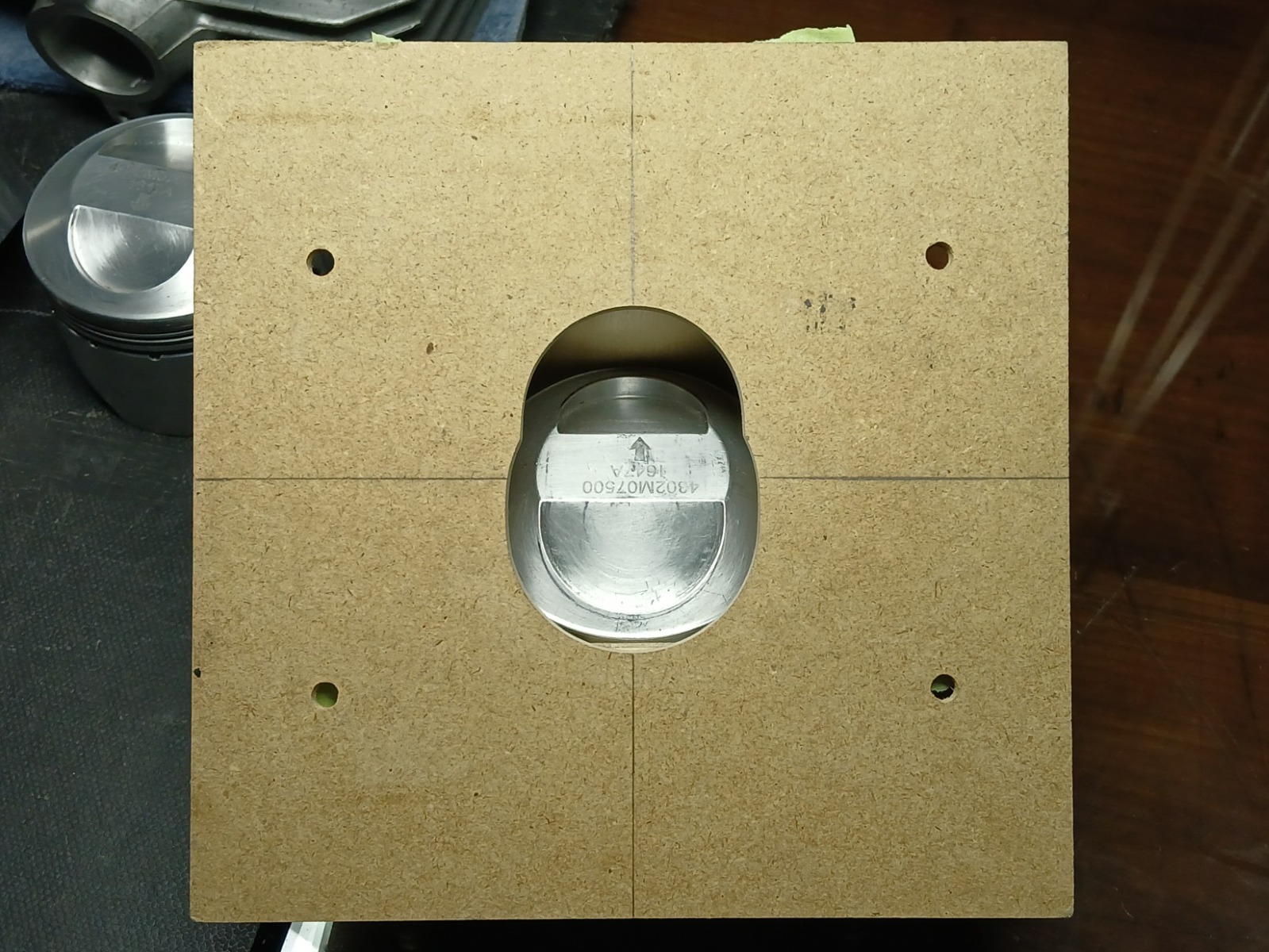

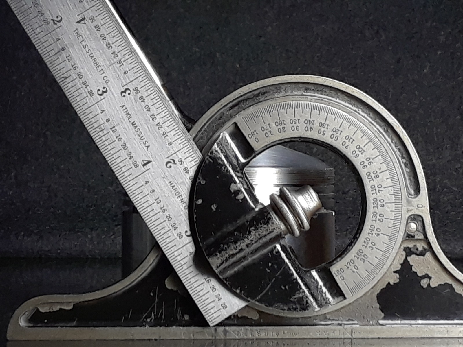

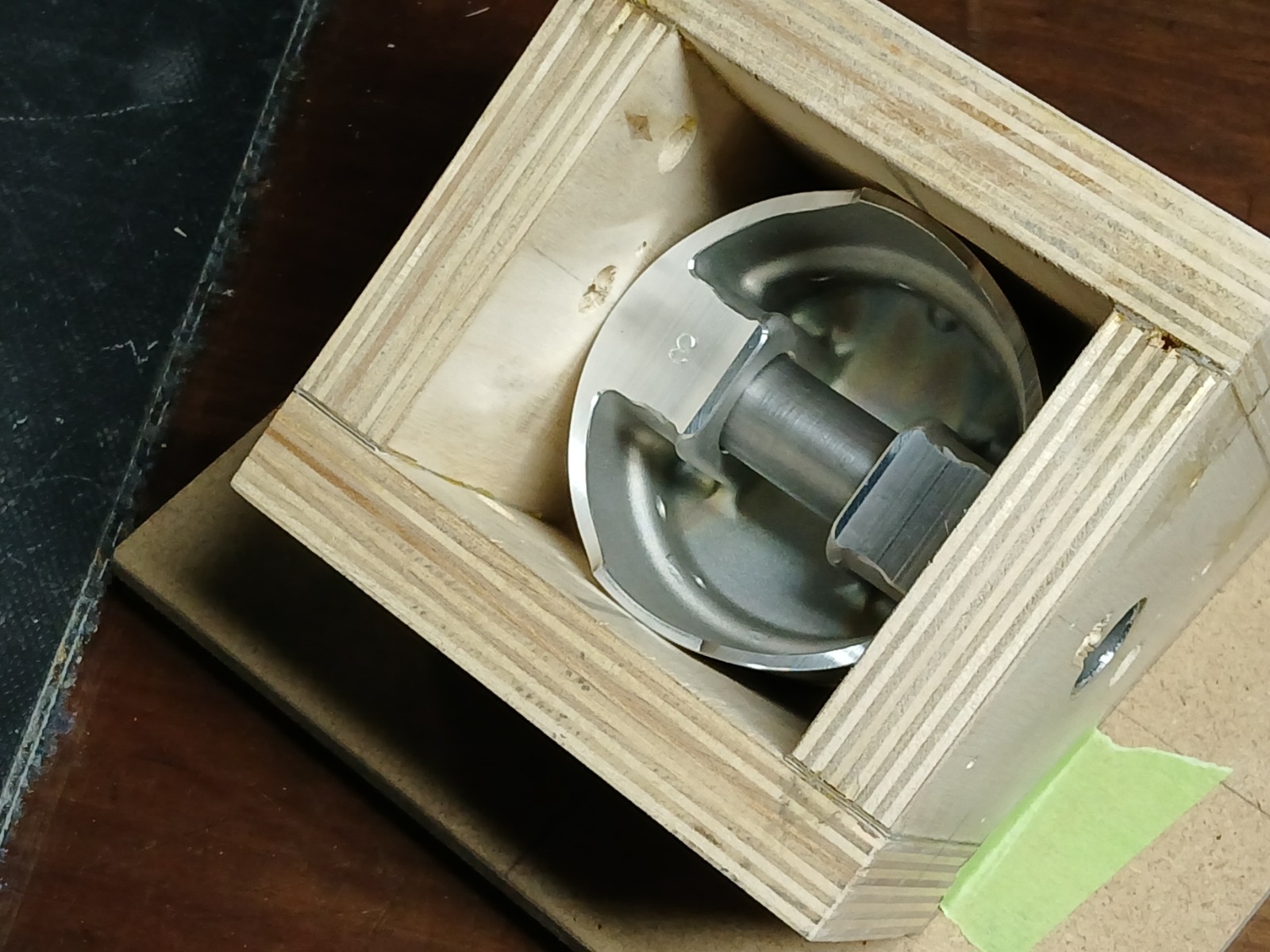

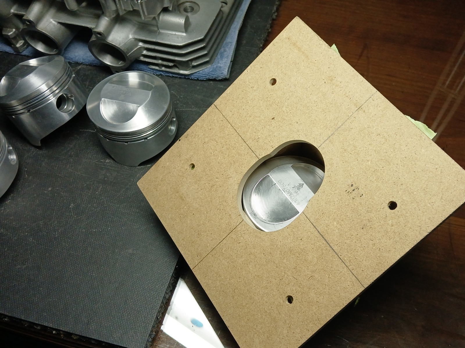

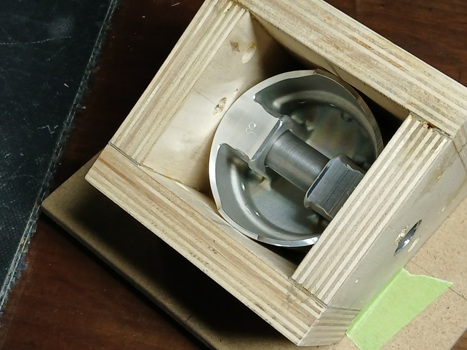

Constructing a jig for my plunge router with a 6mm offset guide bushing and carbide spiral up-cut bit. Pattern is for 1.5 to 1.75mm radial valve clearance, intake and exhaust:

That's an interesting and ingenious way to resolve it - I guess at this point in time they are ornaments unless you want to get into a legal battle with Wiseco so what have you got to lose ?. You might want to check the weight afterwards so you can get them as close to equal as you can

If all else fails looks like a stout wooden finch birdhouse Daveo, ha.
