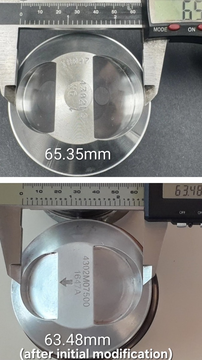

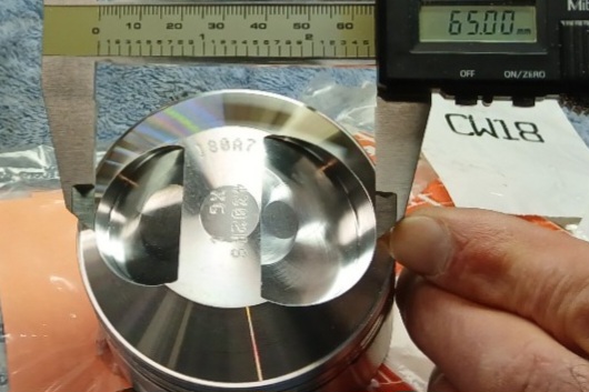

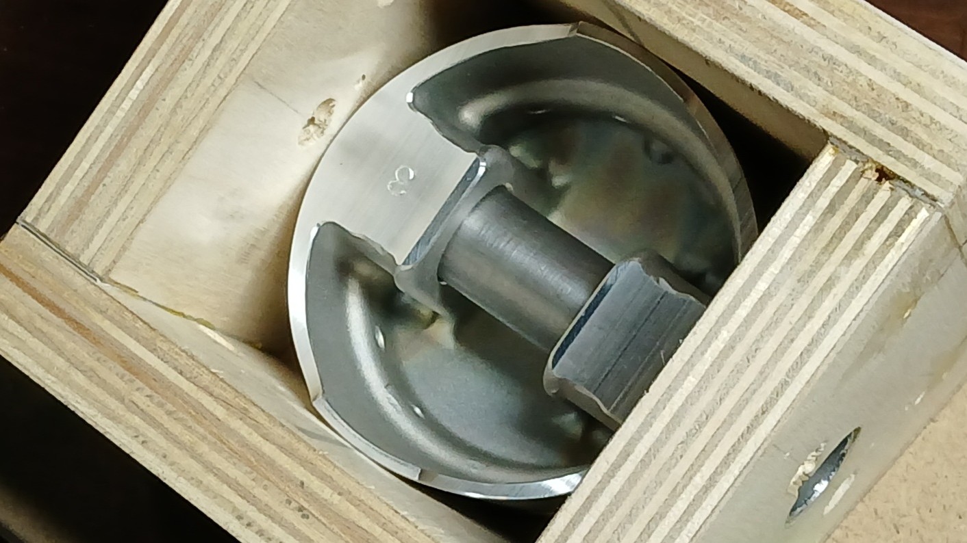

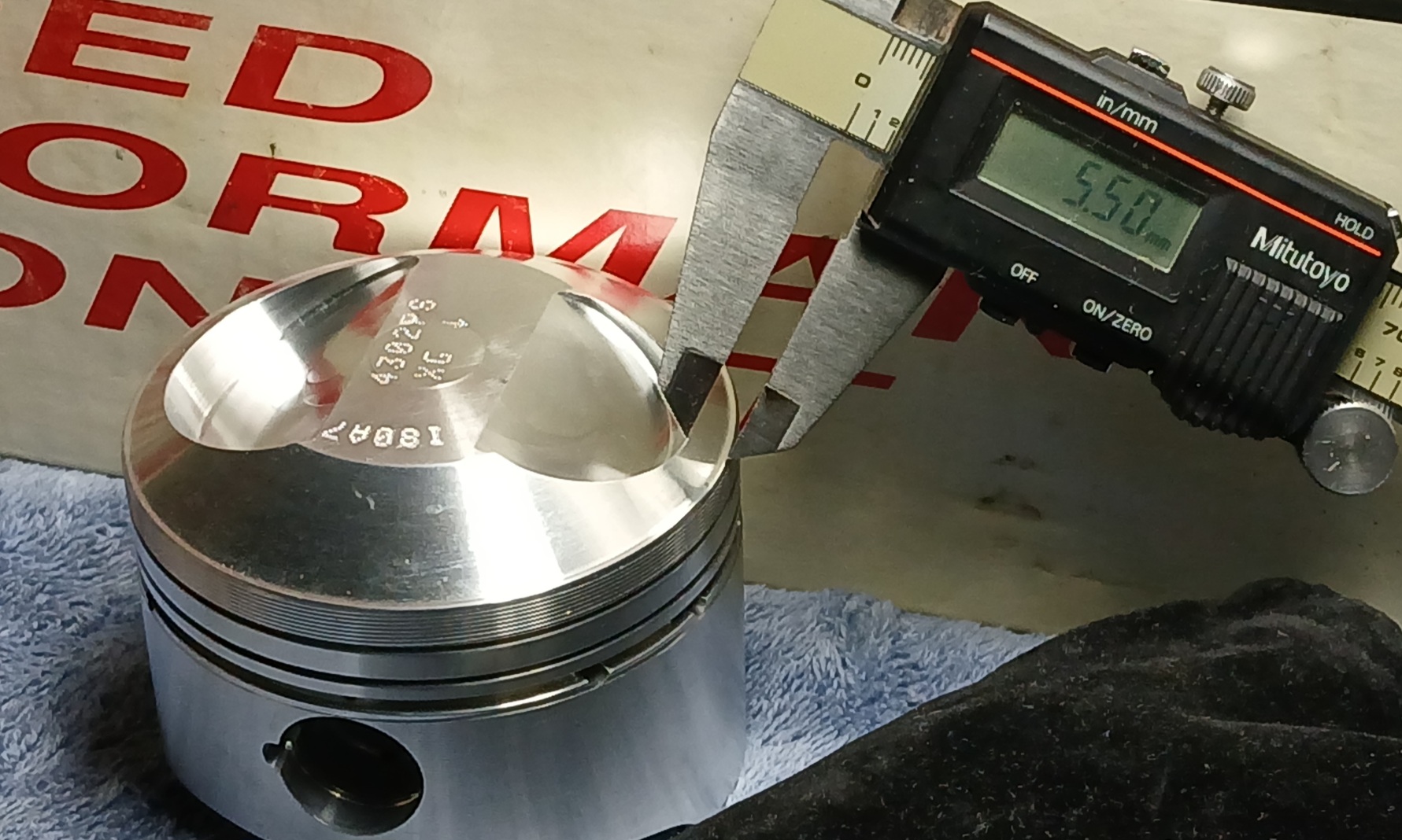

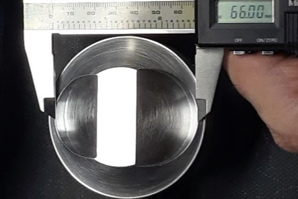

12 Feb 2026 19:39 - 13 Feb 2026 20:28Interior view-old versionOriginal installation Dec.19, 2024
with 62mm pocket dimension:
Original pocket distance from edge.ย Exhaust shown...intake similar:
Both sides modified equal +/-:
Result:
๐ตโ๐ซ

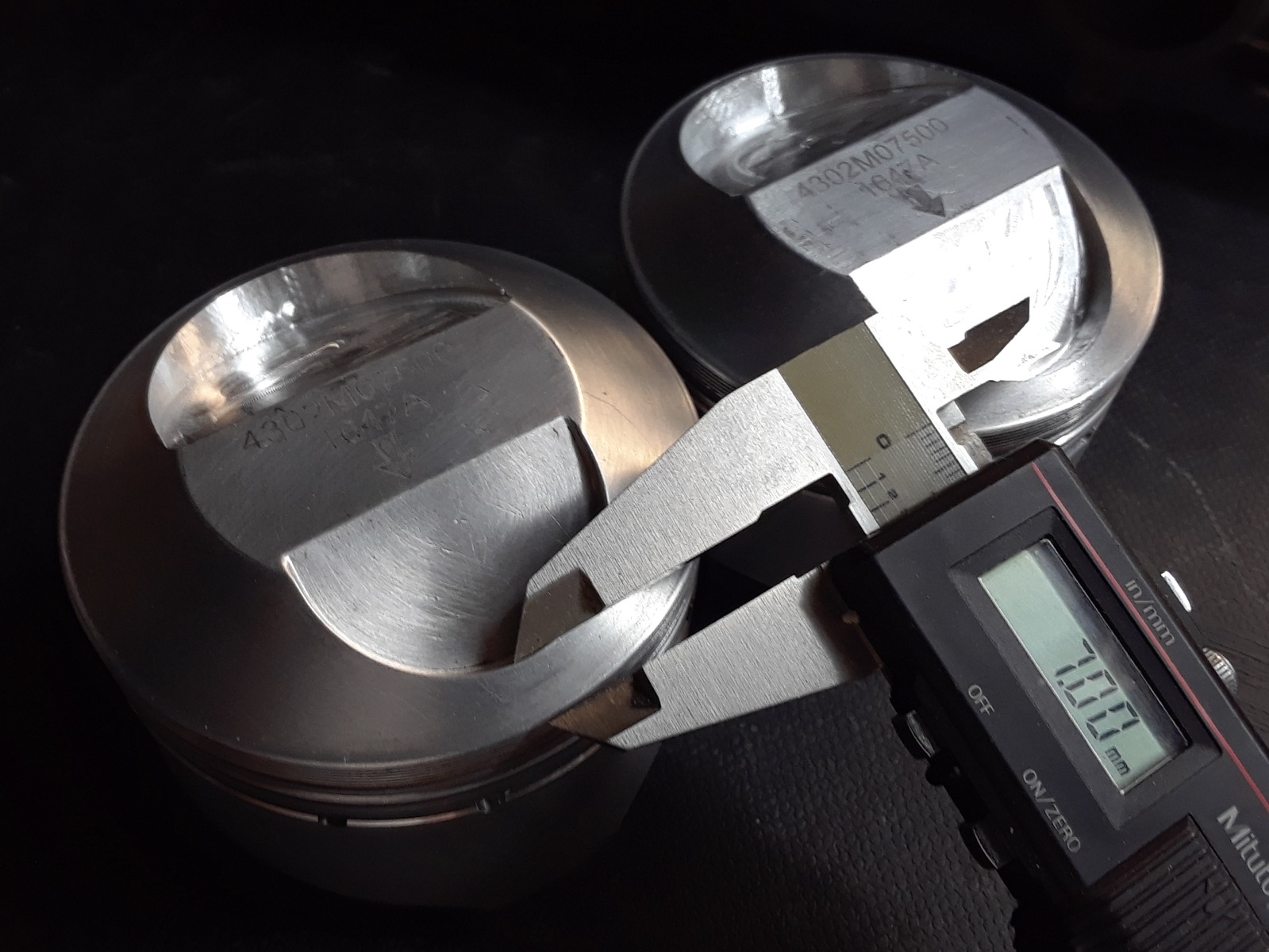

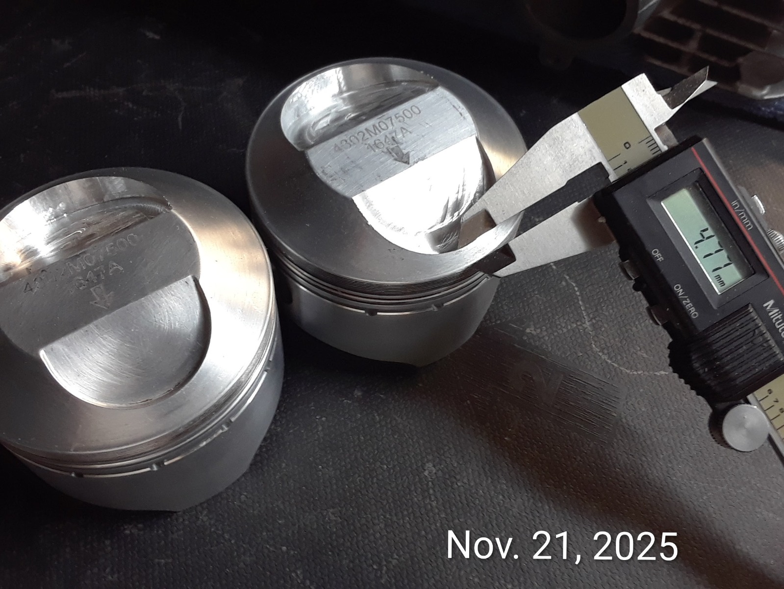

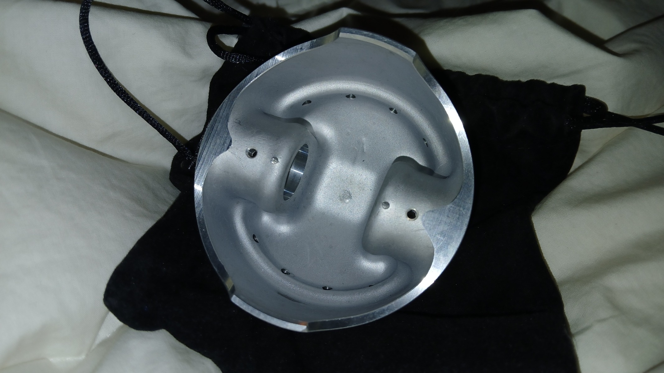

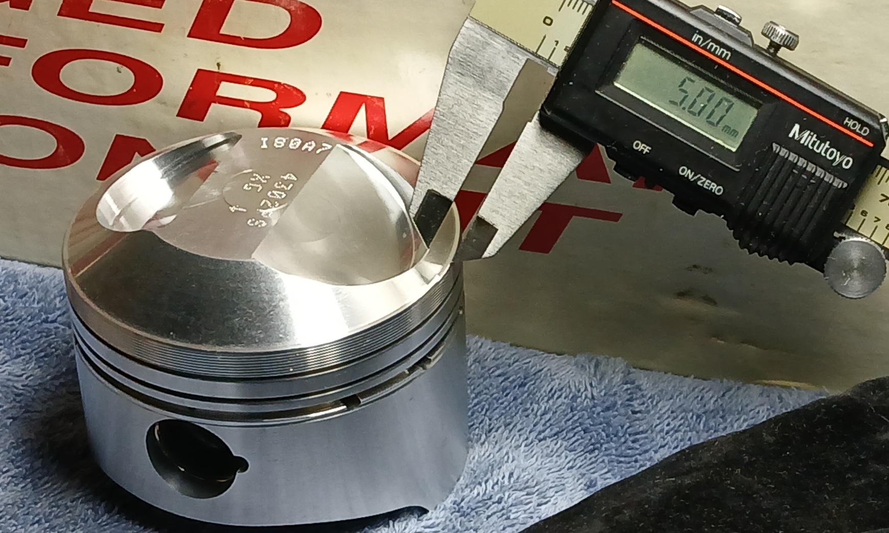

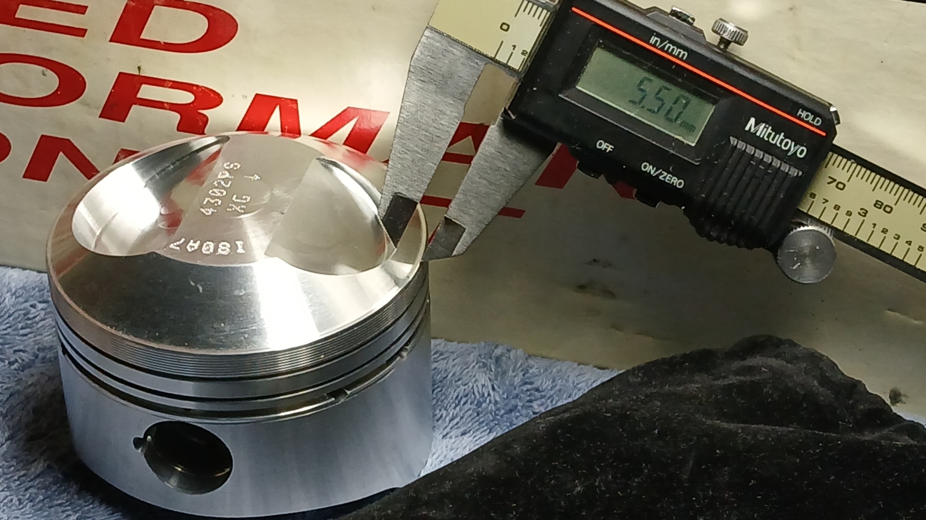

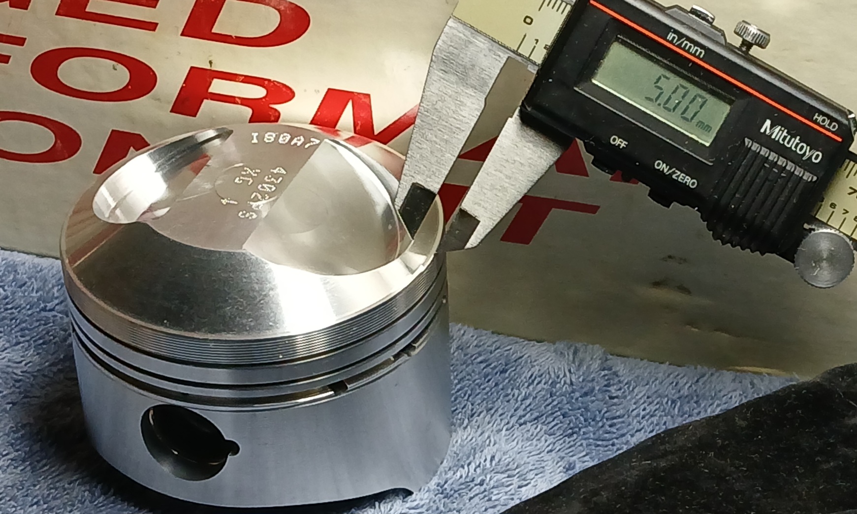

Newly acquired pistons:
Exh.
In.
This old piston set is very nice...
ย
Notable differences
๐
Rings, same part number...

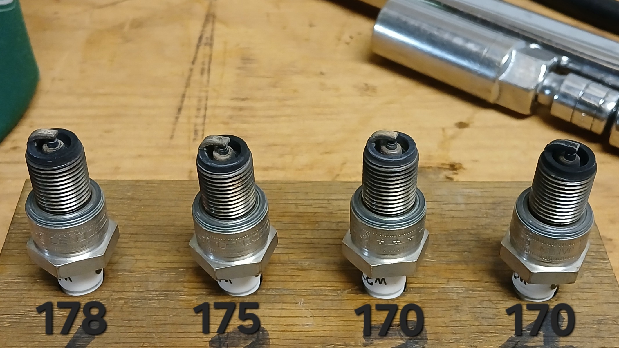

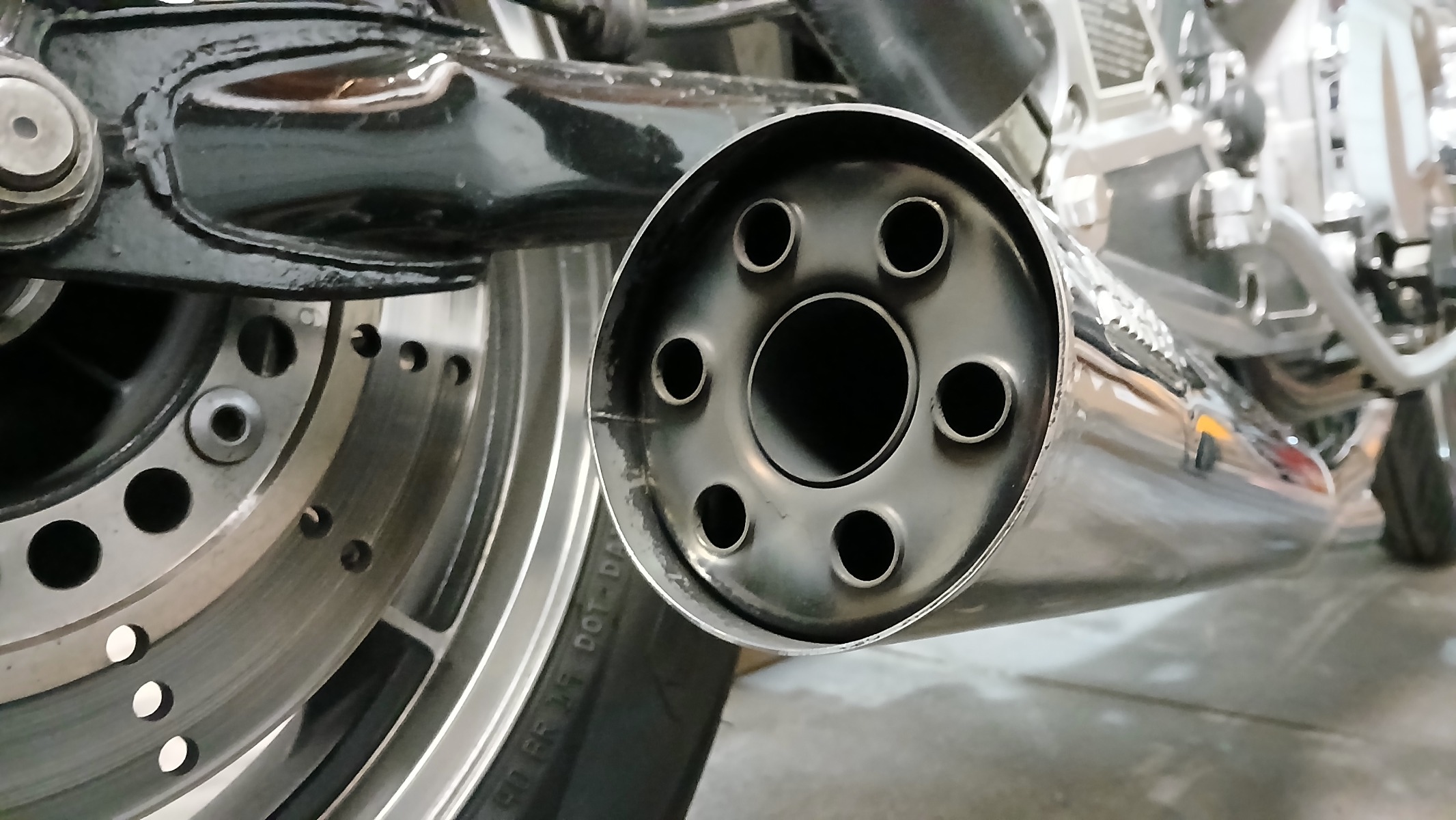

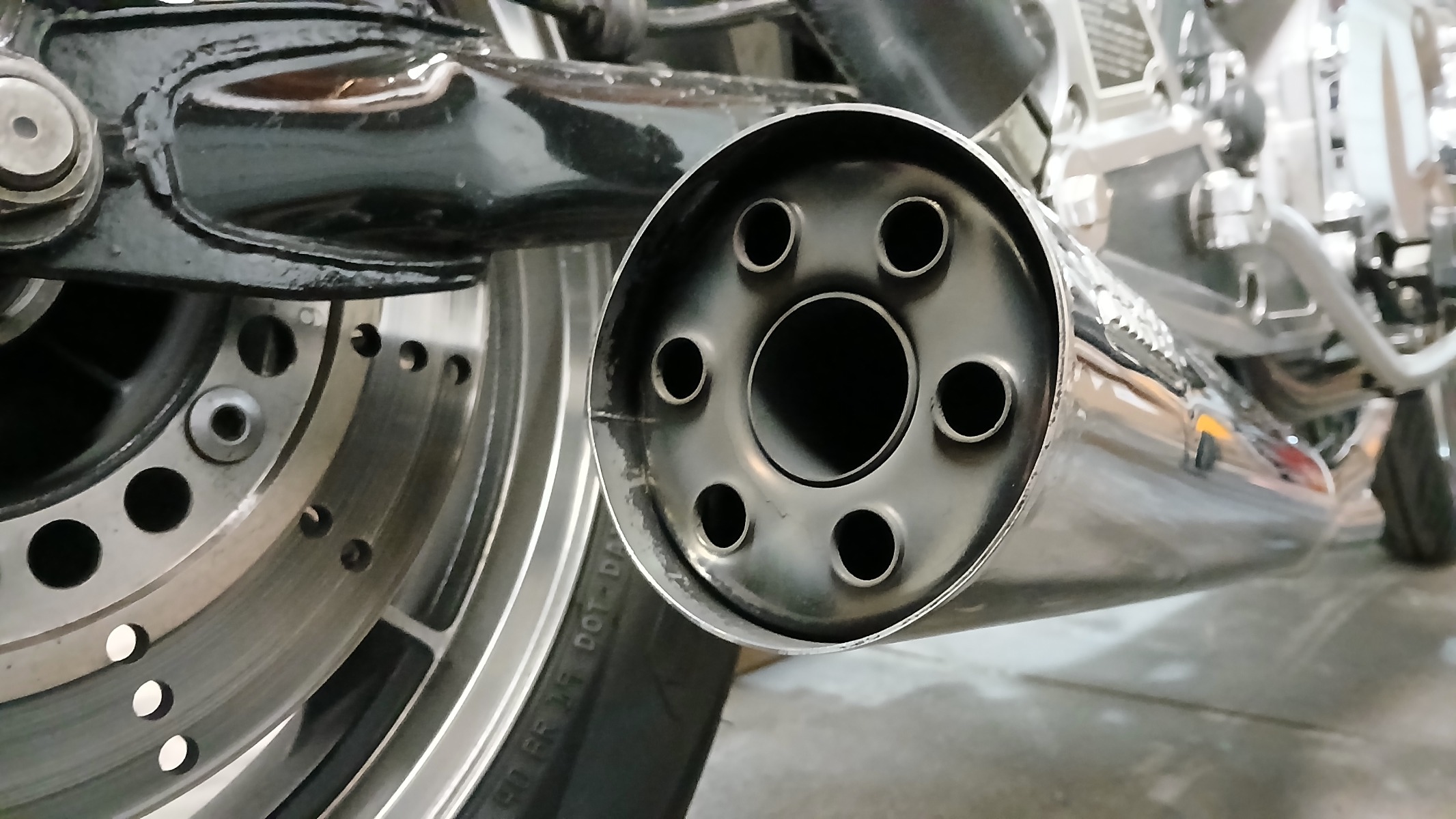

Fired right up, sync was very close, ran with varied throttle for 5 minutes, and went for a short 35 mile ride.
Cleaned and reused spark plug color/psi compression after one ride.ย Using 90 octane no-ethanol fuel.
20 pilot, 125 main, .08 air jets, clips in 3rd slot.ย Fuel screws 1/8-1/4 out.
Baffle was clean when the motor was started, and the pistons were dry when I checked the compression.

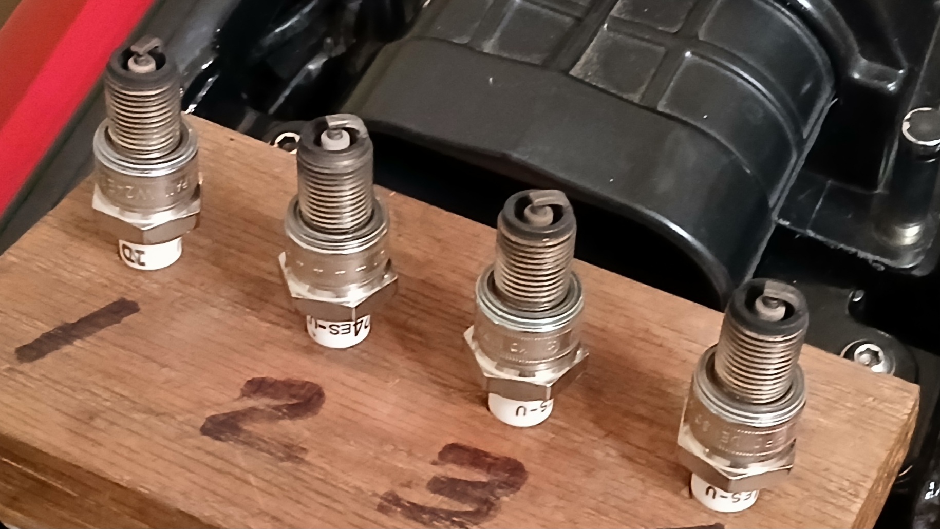

She loves being treated like a lady.
Had a secondย 35 mile ride today that would have been longer, but when the tach went wacky ass bonkers we scooted back home.

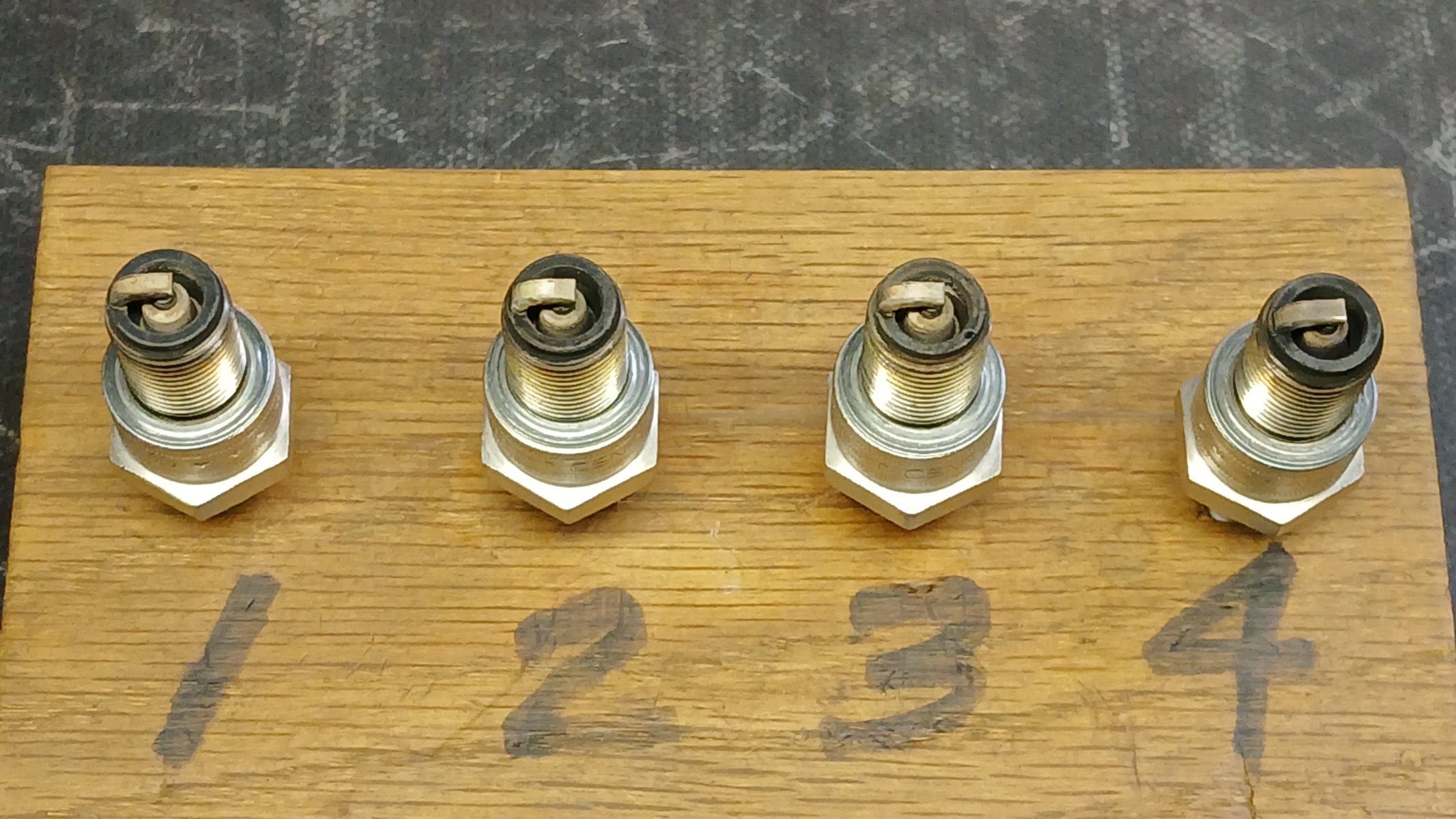

Before the ride I changed the spark plugs from Denso W27ES-U to W24ES-U (hotter!).ย
Also installed 122.5 main,ย and .09 air jets.
This time I adjusted the fuel screws using a Gunson Color Tune.
Seems a favorable result

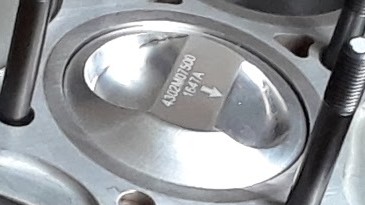

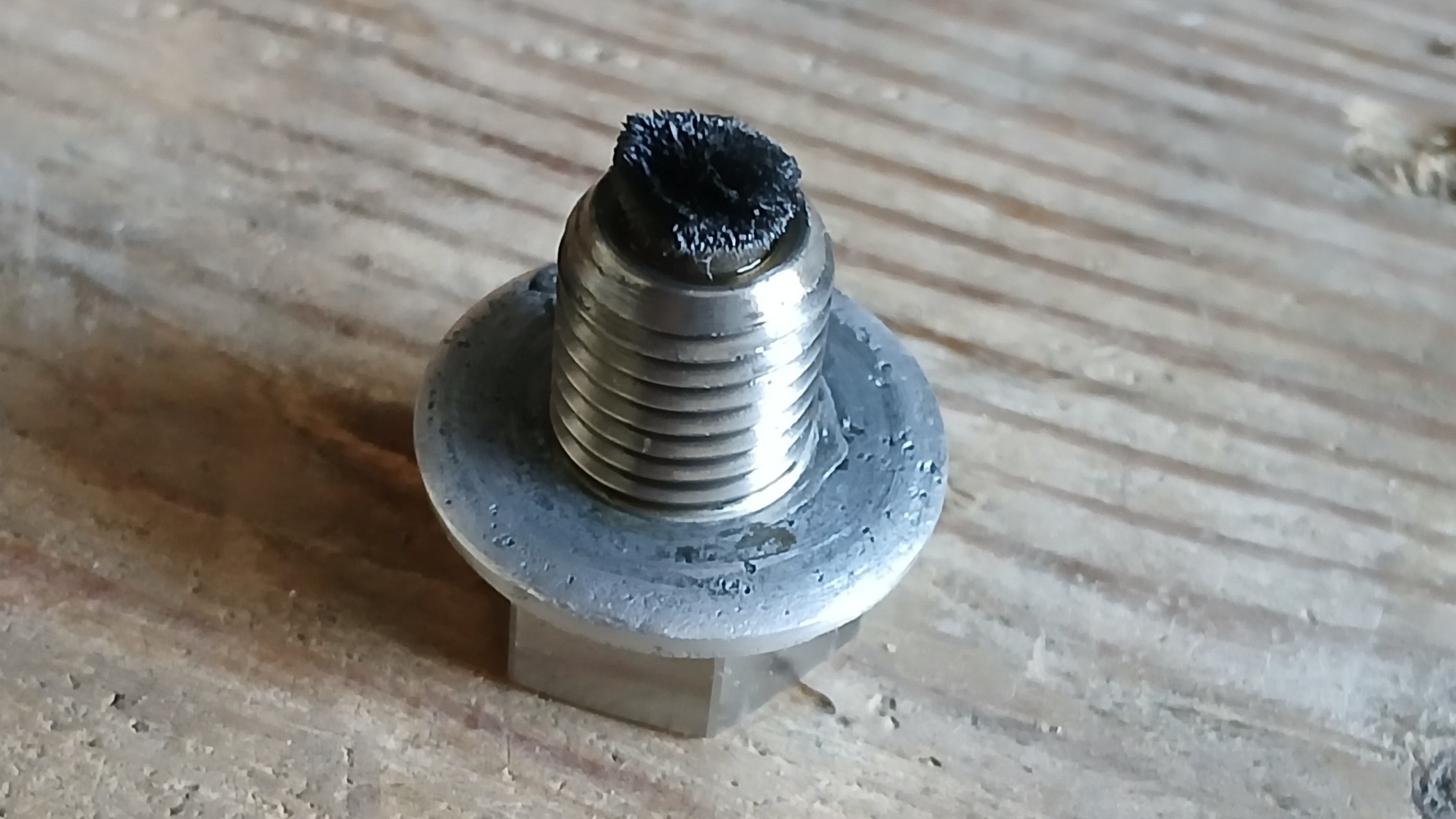

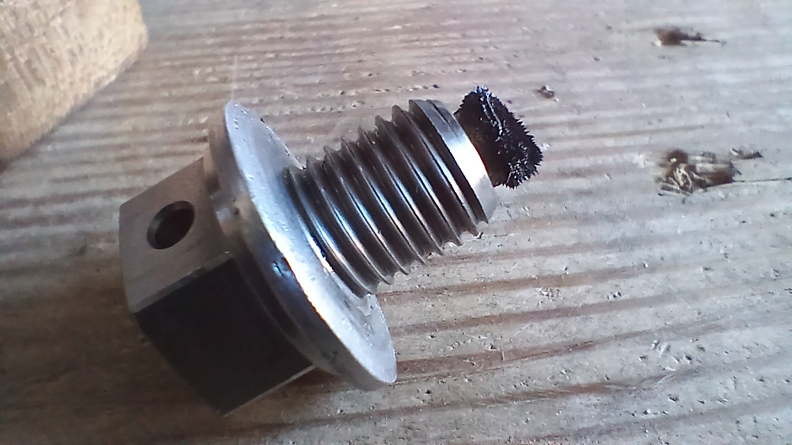

Changed the oil and filter yesterday after accumulating 340 miles.
BTW, she runs fantastic, and the intake valves miss the pistons now...
Denso W27ES-Uย
Liked the Driven BR40 break-in oil, and the drain plug picked up a pile of fine metal shavings.
The motor now has ย Mobil 1 4T 10W-40 Racing Oil installed. ย
