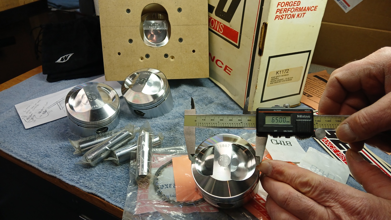

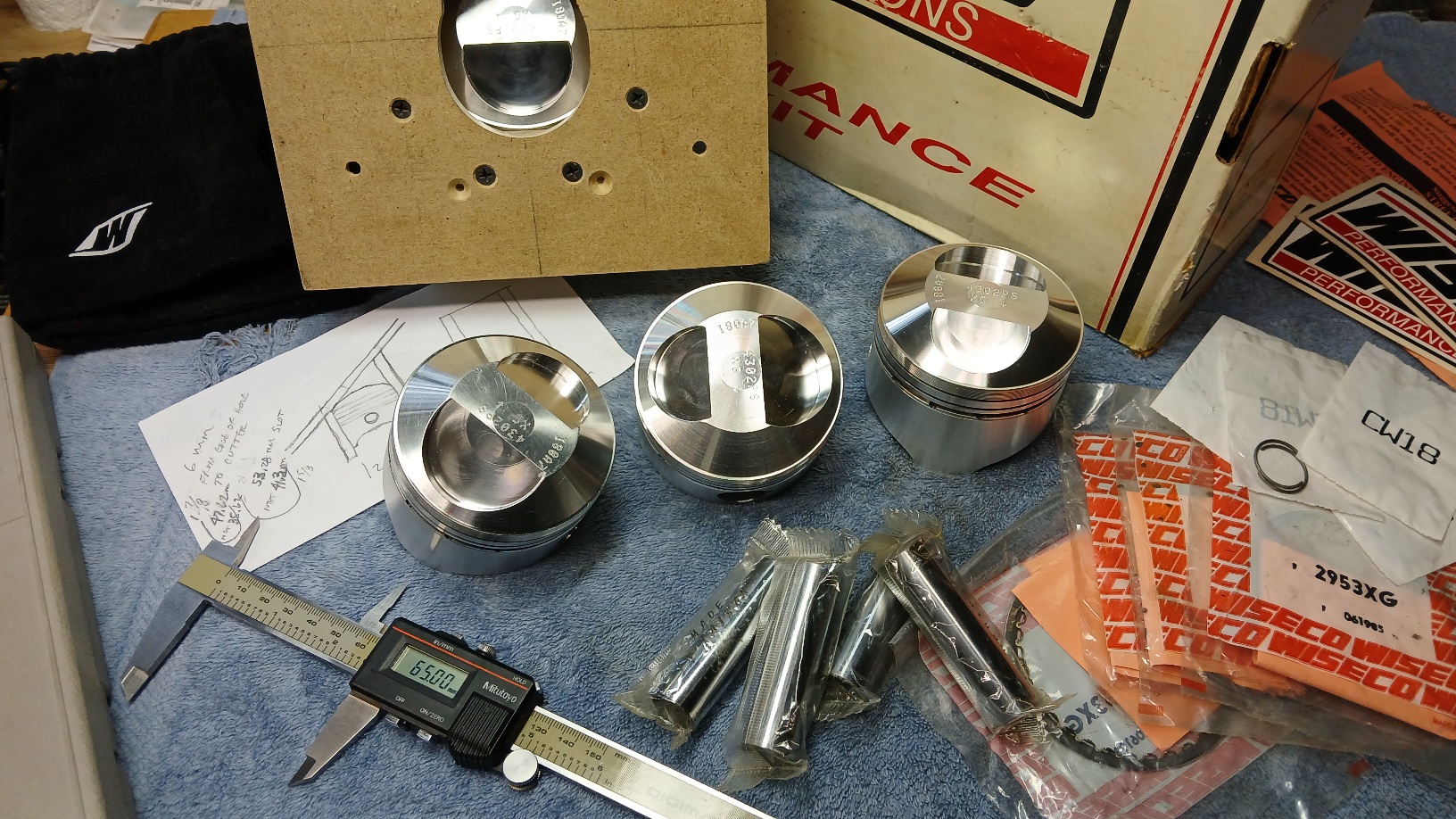

11 Feb 2026 19:33 - 12 Feb 2026 12:39That's an interesting and ingenious way to resolve it - I guess at this point in time they are ornaments unless you want to get into a legal battle with Wiseco so what have you got to lose ?. You might want to check the weight afterwards so you can get them as close to equal as you can
Hmmm...
Found a never installed-unused
Holy cow, man...my initial assertion with Wiseco was that the valve pockets were manufactured too close together...which would not allow the intake valves to clear properly.
Their response was that I must have been running oversize valves (not stock), and there was NOTHING THEY COULD/WOULD DO ABOUT IT, SORRY.
Well...take a look at this:
Huh! 🧐
Note the fourth piston fitted inside the jig in the background.
It's less than .5mm different from the modified set that I just put back in the engine, and these are essentially brand new!
1982 KZ1100-A2/1170 sleeper 😀

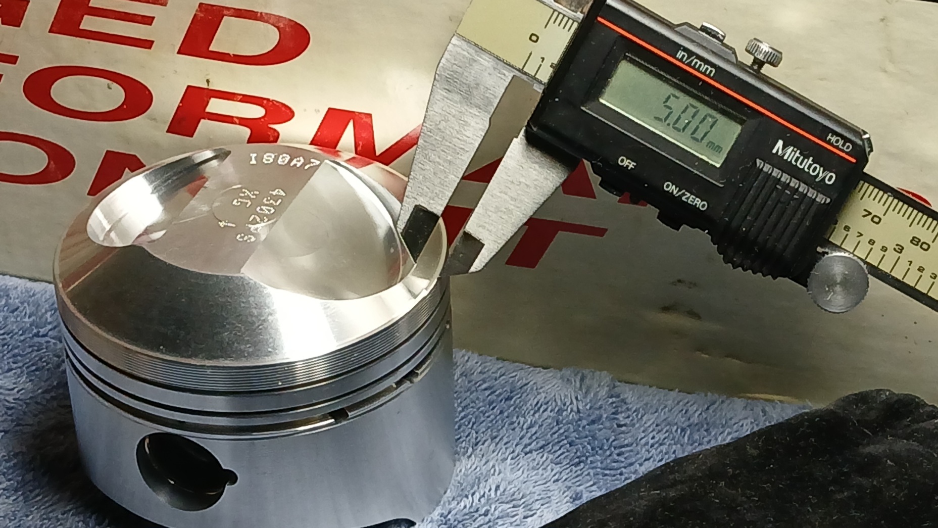

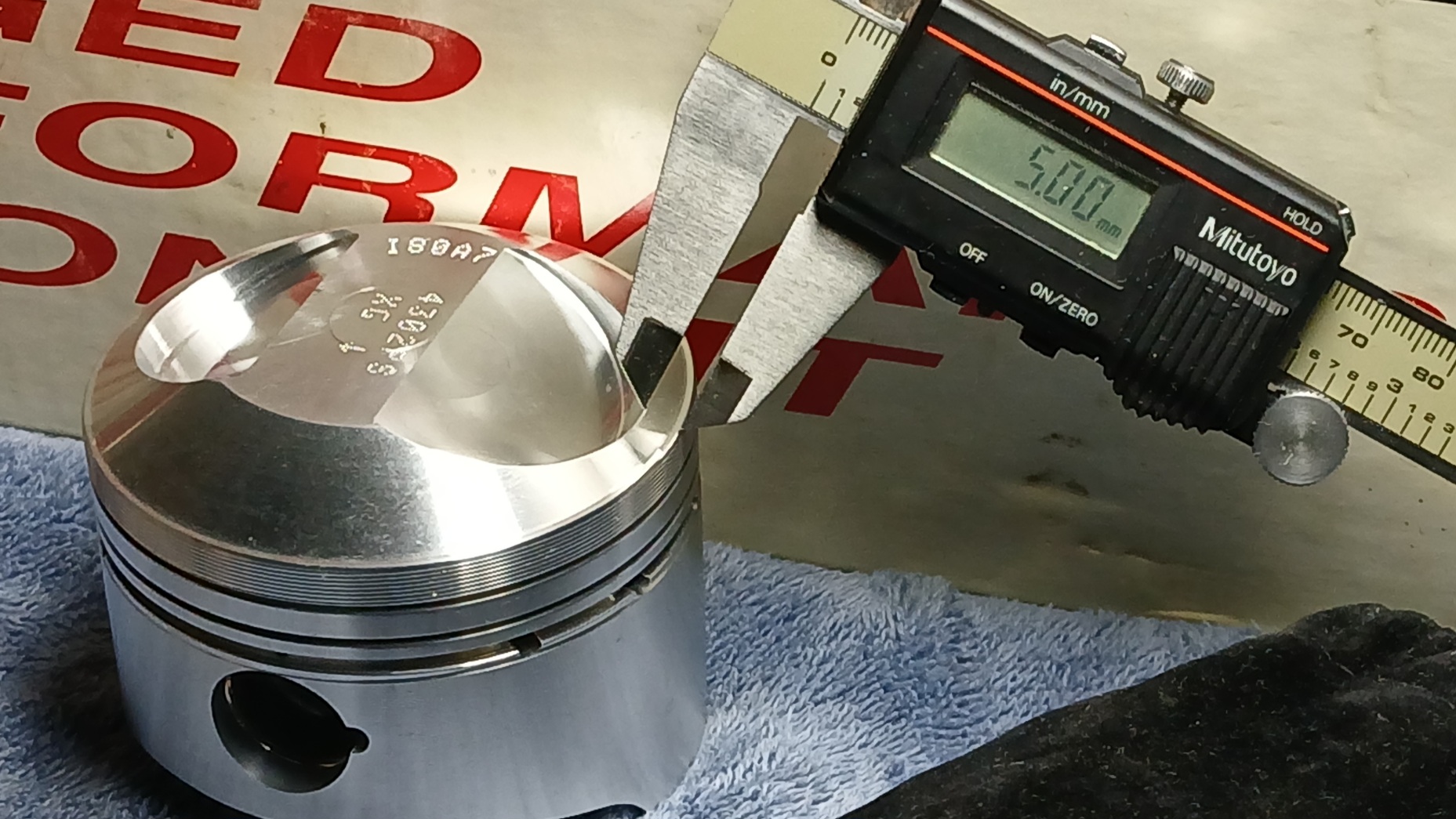

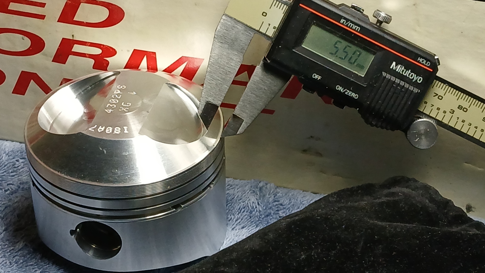

12 Feb 2026 01:39 - 12 Feb 2026 12:45Original installation Dec.19, 2024
with 62mm pocket dimension:
Original pocket distance from edge. Exhaust shown...intake similar:
Both sides modified equal +/-:
Result:
Newly acquired pistons:
Exh.
In.
This old piston set is very nice...
