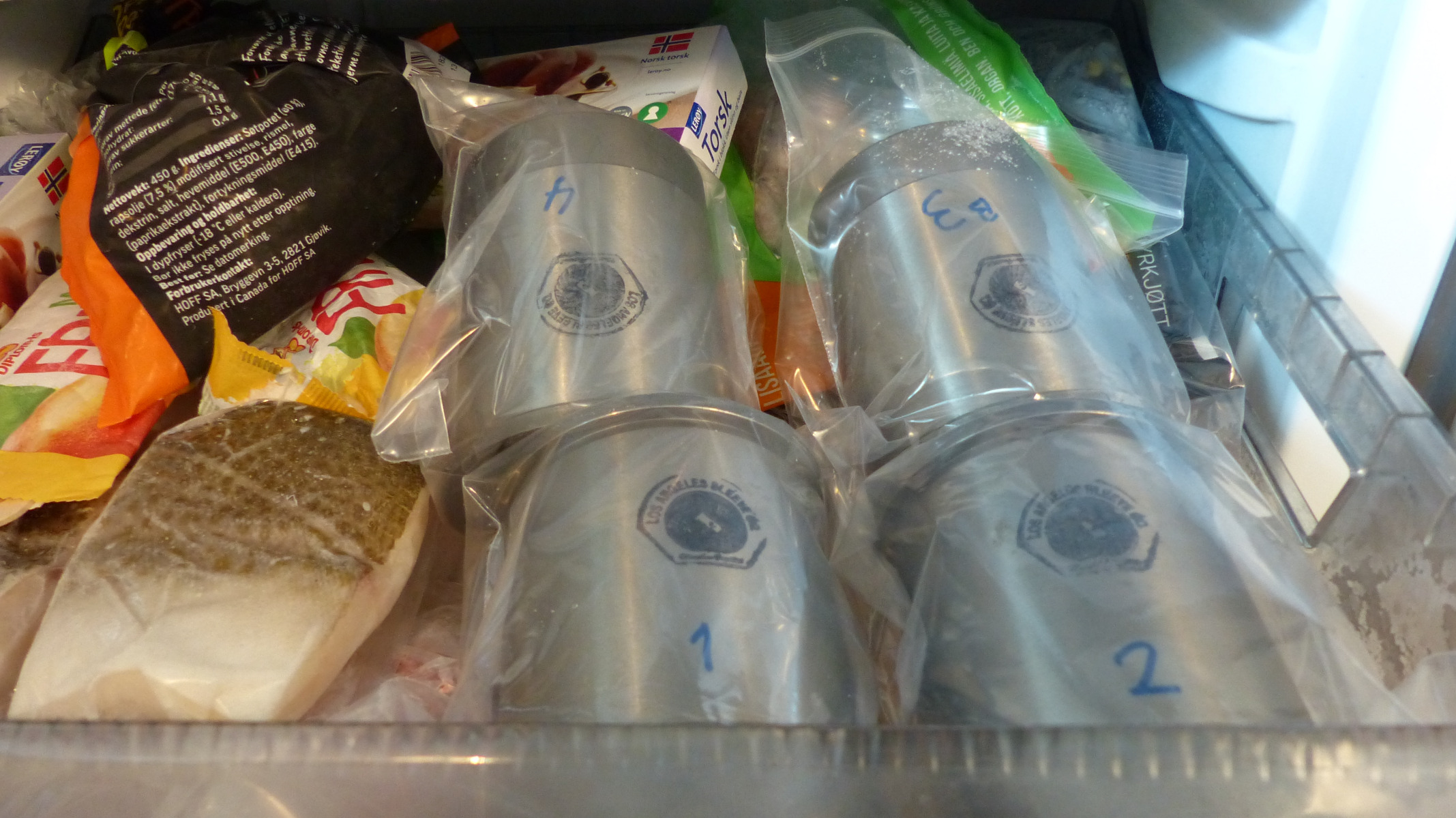

19 Oct 2023 13:43Wait until your wife is out and "pop them in the freezer"

I have used an oven before ,but this time i just tried with an hot air dryer heated for 15 minutes and the sleeve almost fell out.The other sleeve was a little more difficult to get out but after some light tapping it came out.Today after i inspected them some more on outside i installed them by using the hairdryer and had the sleeves in the frezer only 15 minutes.I got problem with one of them that jammed so had to reheat and take it out and after a new attemt it got in place

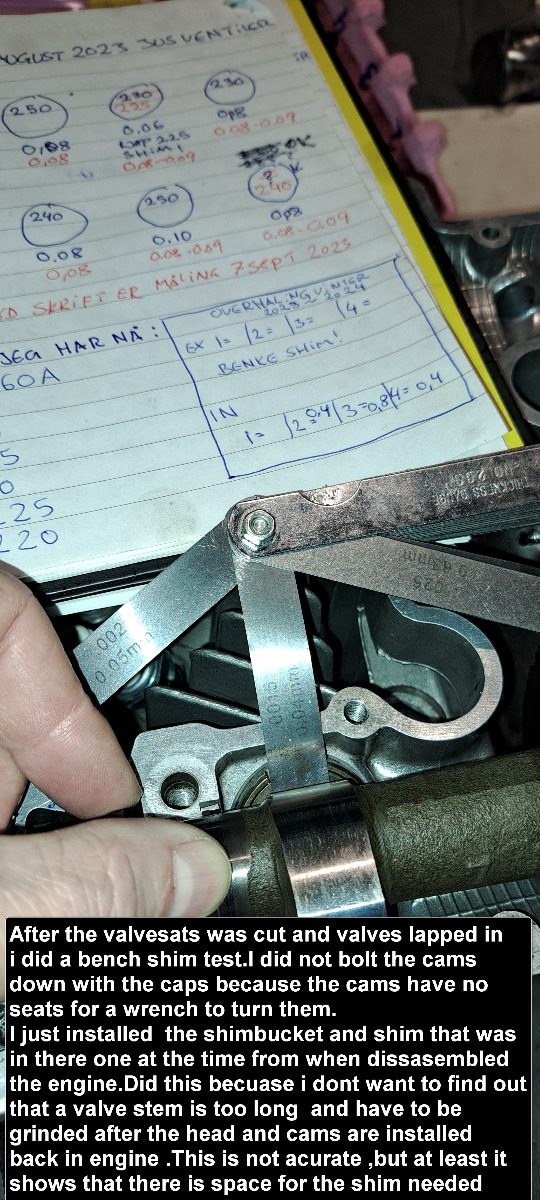

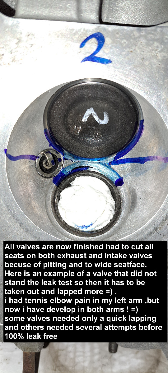

Since im waiting for sleeves i finished the valves .i was hoping that i could just lap the exhaustvalves ,but the seats was to badly pitted and also seatface was to wide on them so had to use my neway cutter again.The valves was in better shape than the seats and none had bad deep pittings after lapping .After that i have bench shimmed the valves to check that non of the valvestems is to long after the seats was cut.If to long there is no space for shim and the valvestem must be grinded shorter.Not fun to discover that after the head is installed back in engine !
