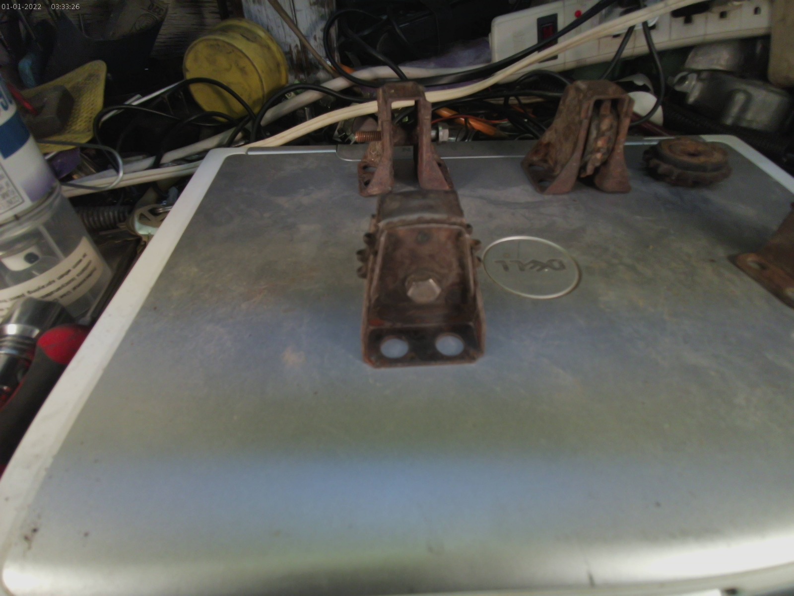

You would need to consider the width of the cam cover hump. Adding an axle with both ends nutted would greatly increase the width. I think the simplest is to drill and tap the OEM axle and add a button/truss head m6 bolt

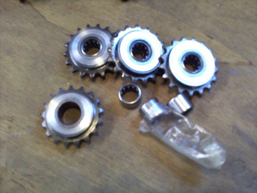

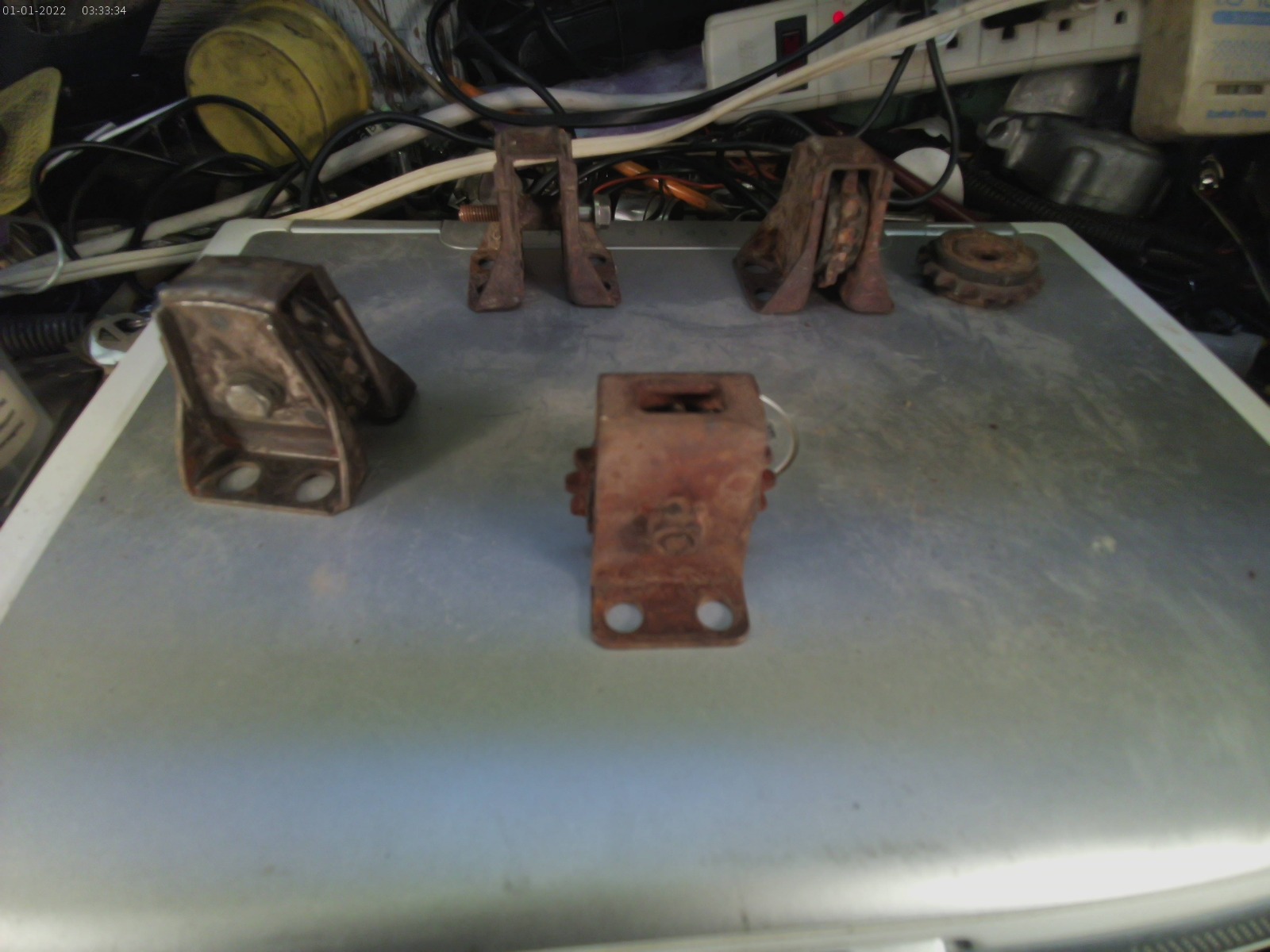

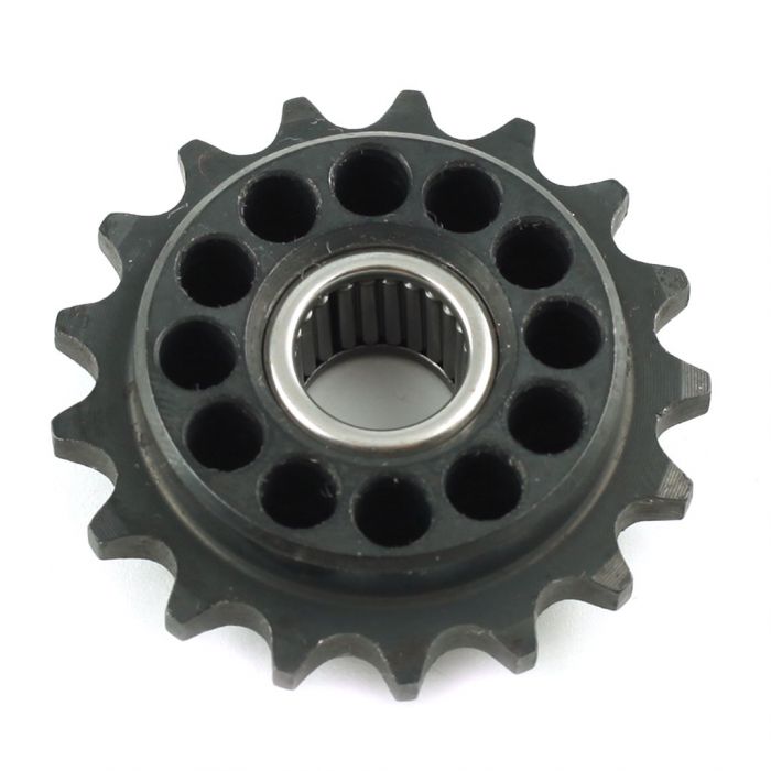

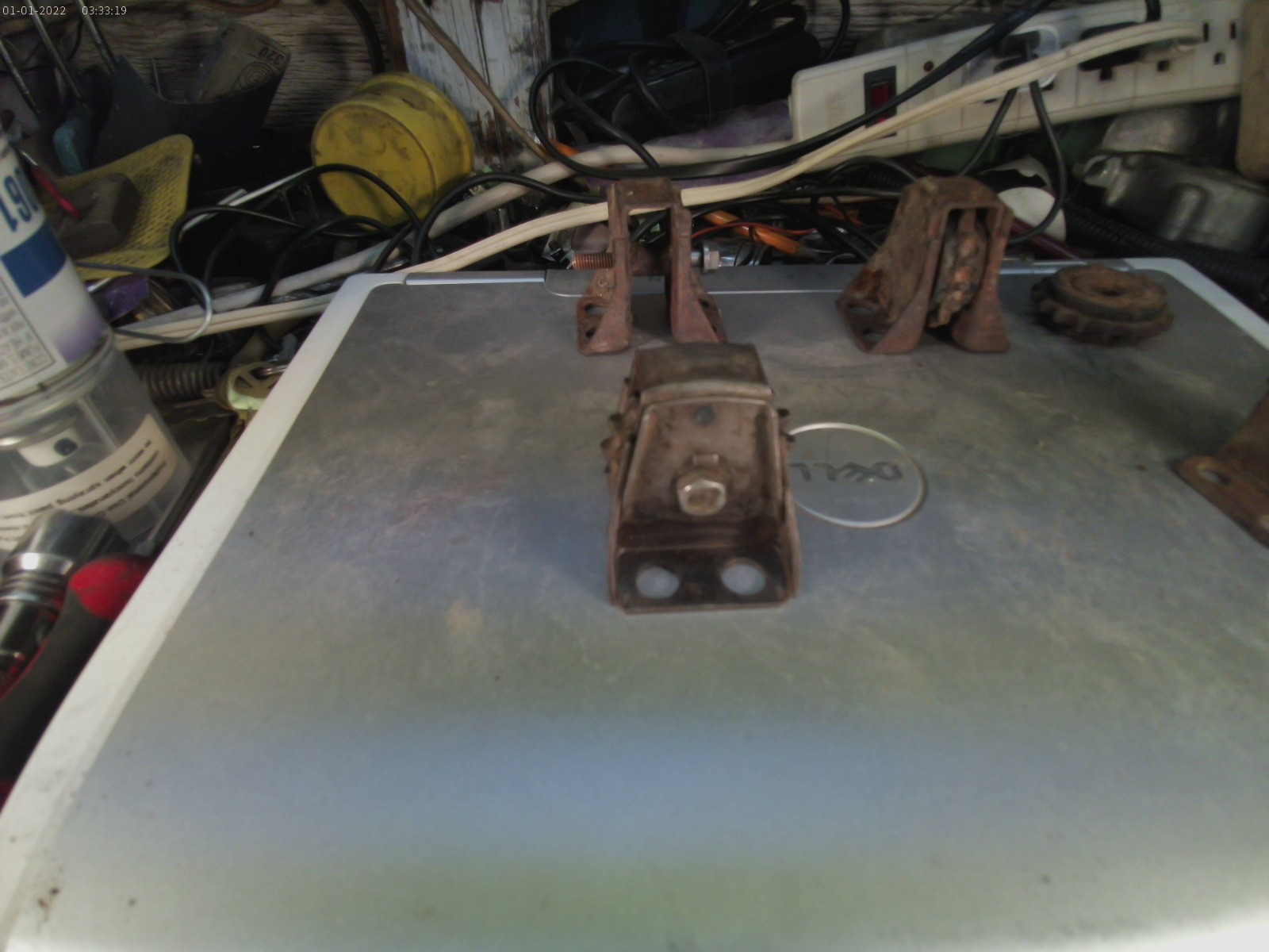

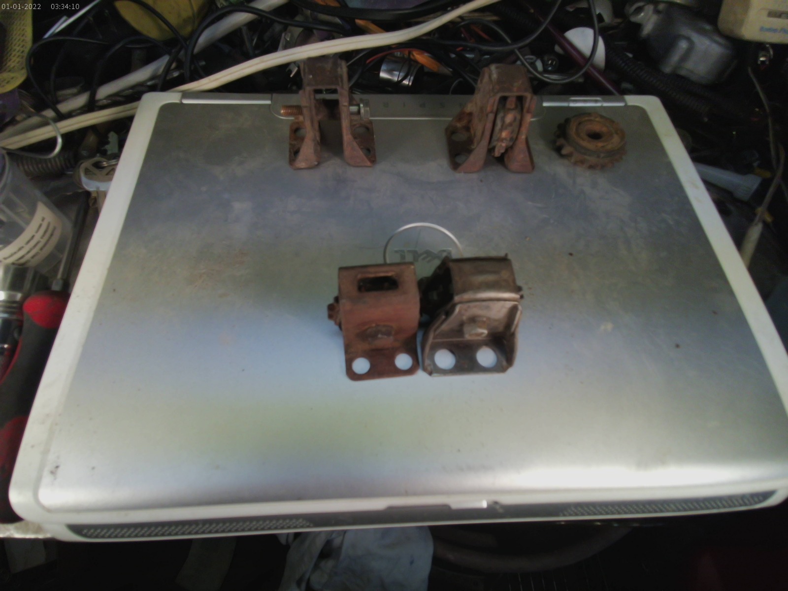

10 Dec 2023 16:08I used to make them like that with the wider original sleeve installed (see pic) but it just introduced the increased possibity of runout due to the stack up of tolerances which resulted in too many rejects..Zed1015, not sure if we should continue here or start another thread, mods?
Have you had any issue with the repaired gears wear on the metal brackets? I had a local machinist make me up some gears, with your guidance. My concern is the full side face of the repaired gear in contact with the bracket. I noticed on the OEM gears there is a second metal sleeve the needle bearing presses into that is .88mm wider than the gear width. 13.23mm vs 14.11mm. This second sleeve would be the thrust surface for the gear and considerably reduced the contact surface between the fabricated aluminum hub and the bracket. I’m thinking of having my gears reworked to have the second sleeve pressed into the new fabricated aluminum. Thoughts?. See photo of inside of bracket. You can see the wear pattern of the second sleeve highlighted with red arrows
I now make them with the one piece solid ally center slightly narrower so that there's clearance either side and they self center and run clear of the sides when the chain is tensioned.
If you look at the solid Liska, PMC ones ( bottom pic ) they are the same.

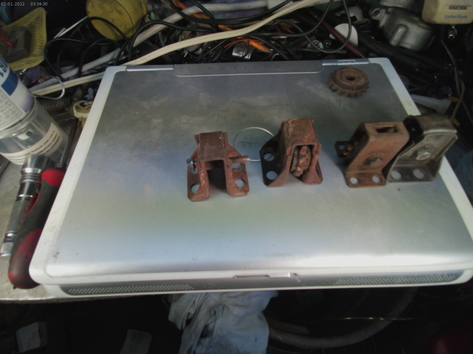

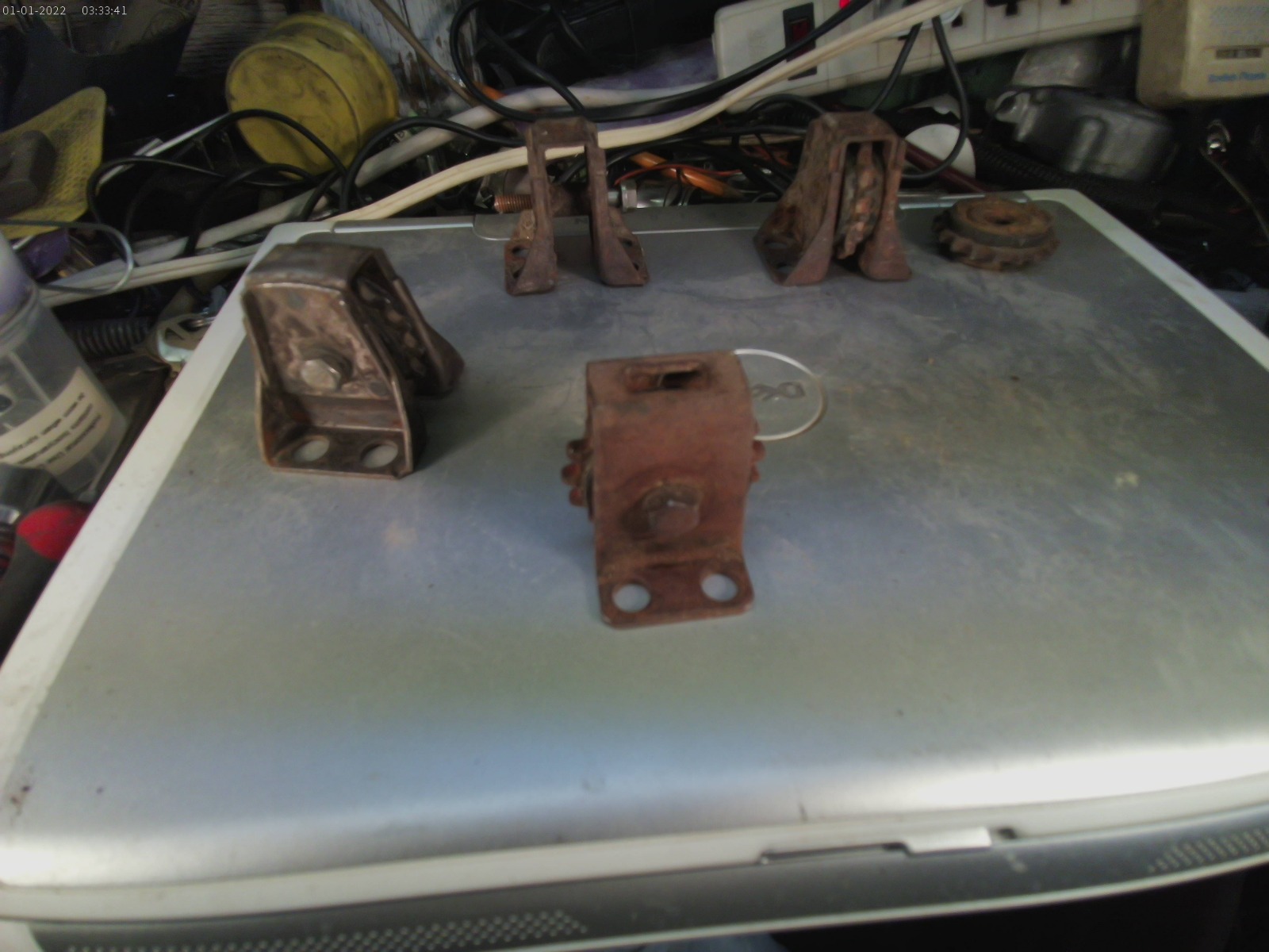

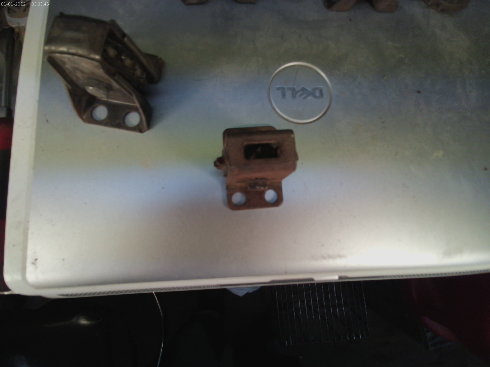

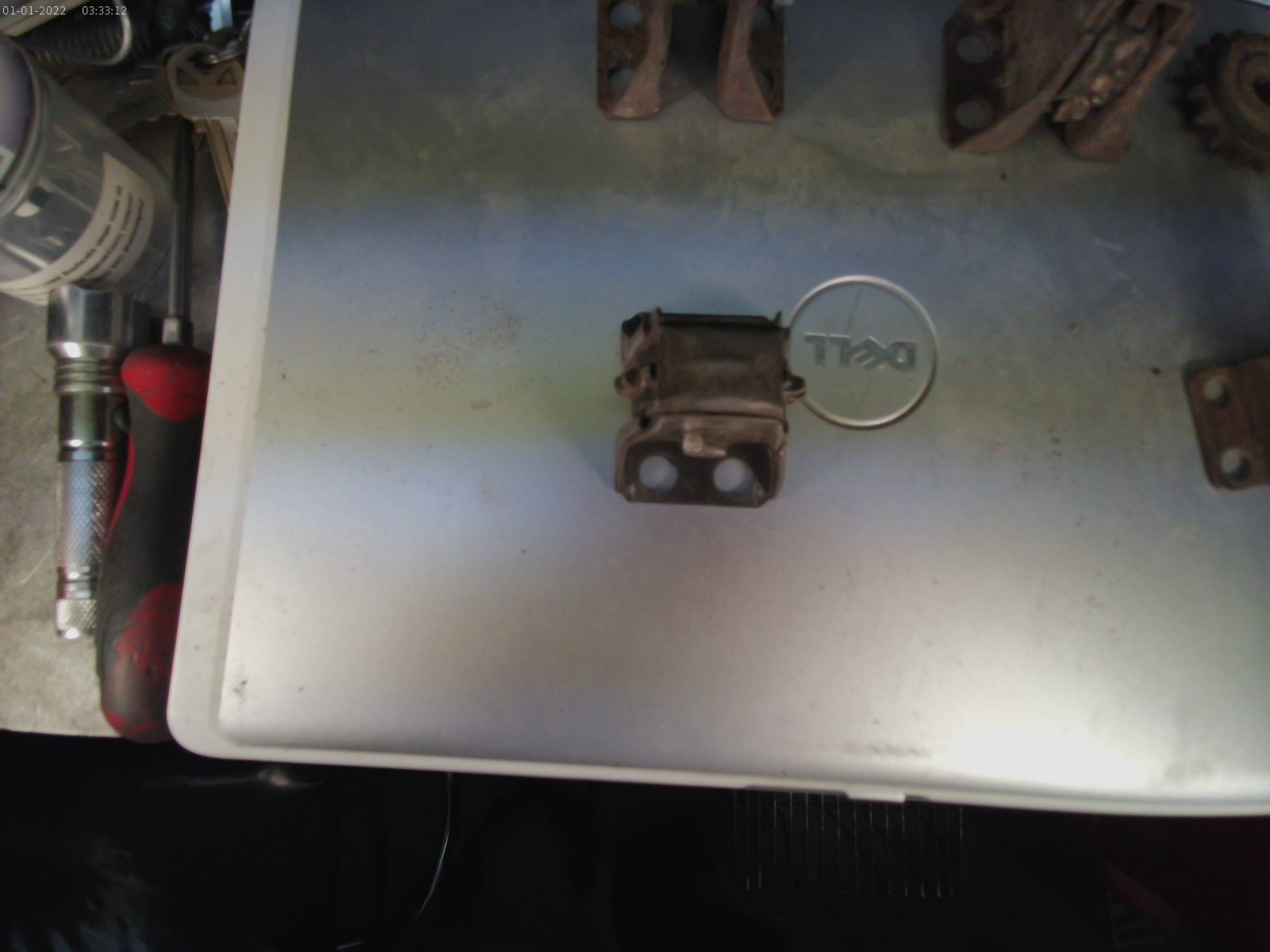

This is the one I modified. The roller was shot and rubbed on the top of the bridge thus the bulge.
It ran well with a used roller until I replaced it with Liska's. Yes I did have to grind the valve cover a bit for it to fit.
KZ1000 that came with the junk head I'm using today
It's shorter than the Z1 so it's easier to remove the cam cover.
I don't throw anything away just leave it in the dirt.

10 Dec 2023 19:25Thank you. Never noticed the Liska design.I used to make them like that with the wider original sleeve installed (see pic) but it just introduced the increased possibity of runout due to the stack up of tolerances which resulted in too many rejects..Zed1015, not sure if we should continue here or start another thread, mods?

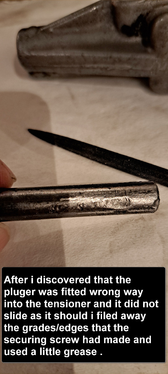

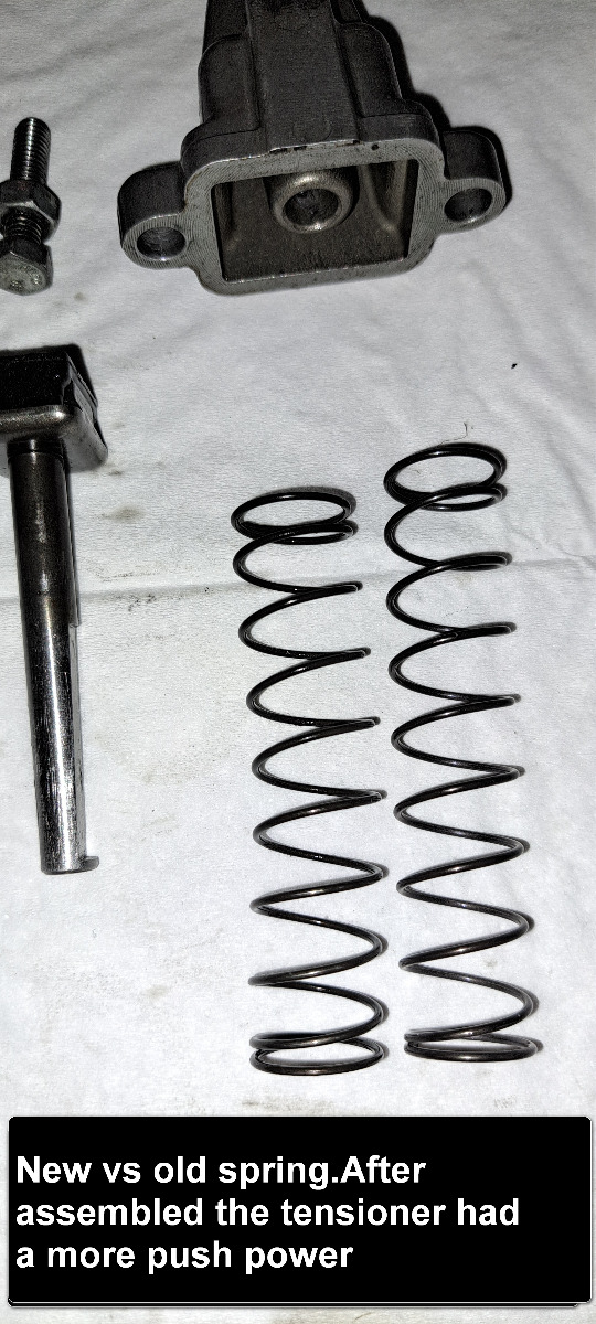

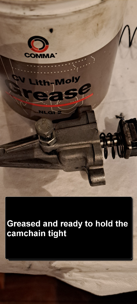

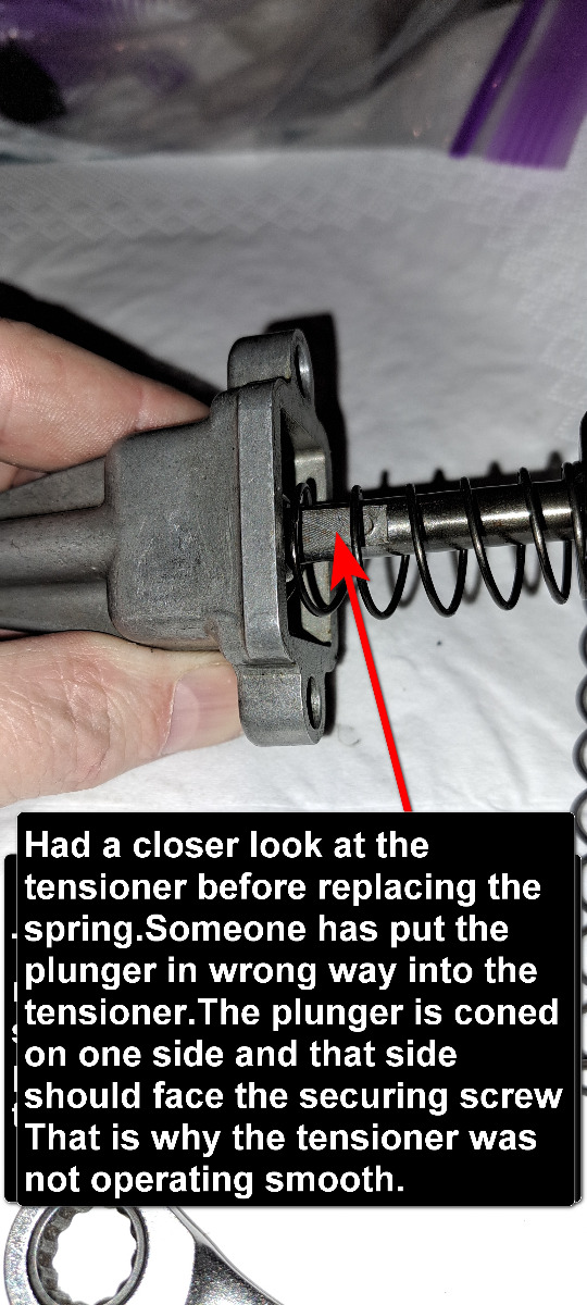

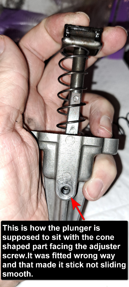

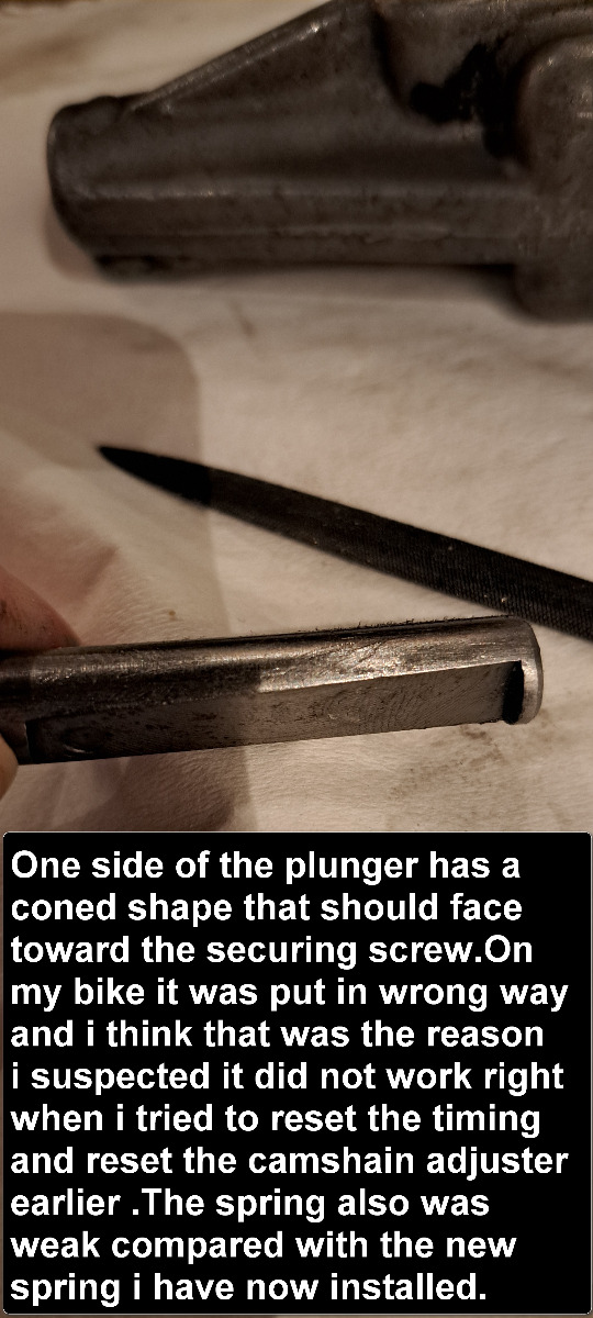

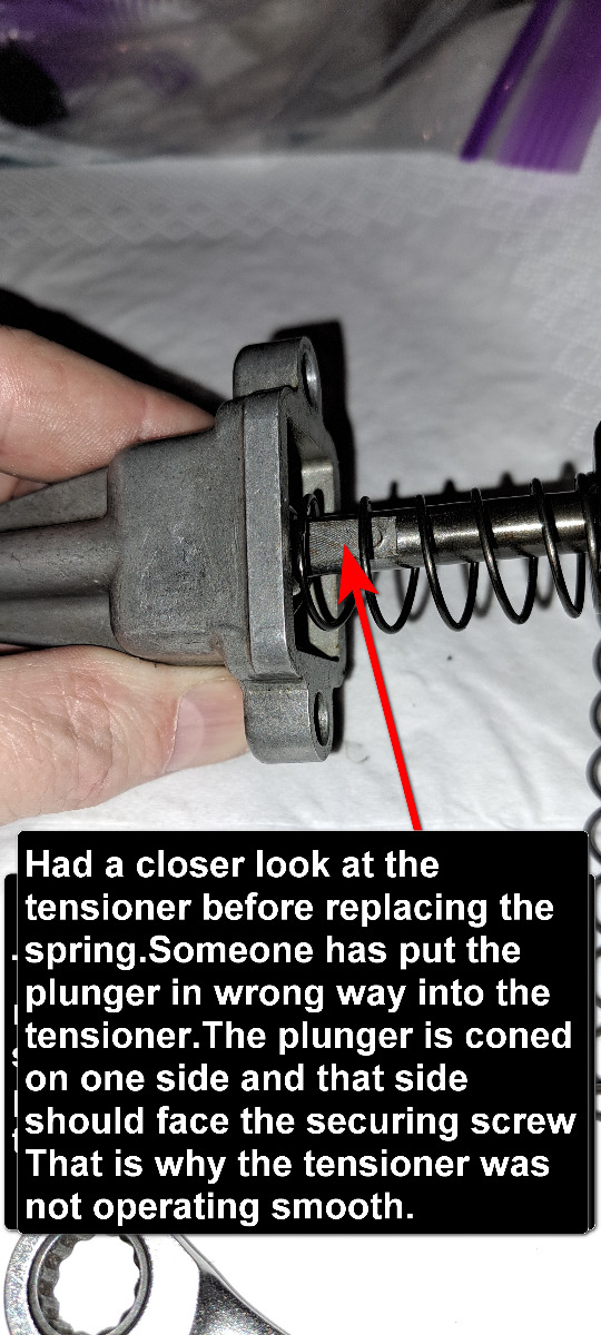

.Maybe not so interesting ,but think i found out why the camchain tensioner acting like it did not work right earlier when tried to set the timing. The problem then was that the chain was too lose.The coned plunger was placed wrong way inside the tensioner .That made it stick
so it did not release right.I remember that when i installed it the way it is supposed to by first push plunger in and then lock the adjusterscrew and install the hole unit.When i then released the adjuster screw it did not make any click noise also no noise when turning the engine on crank. The spring was also weak and had been shorter so have now fitted a new spring.

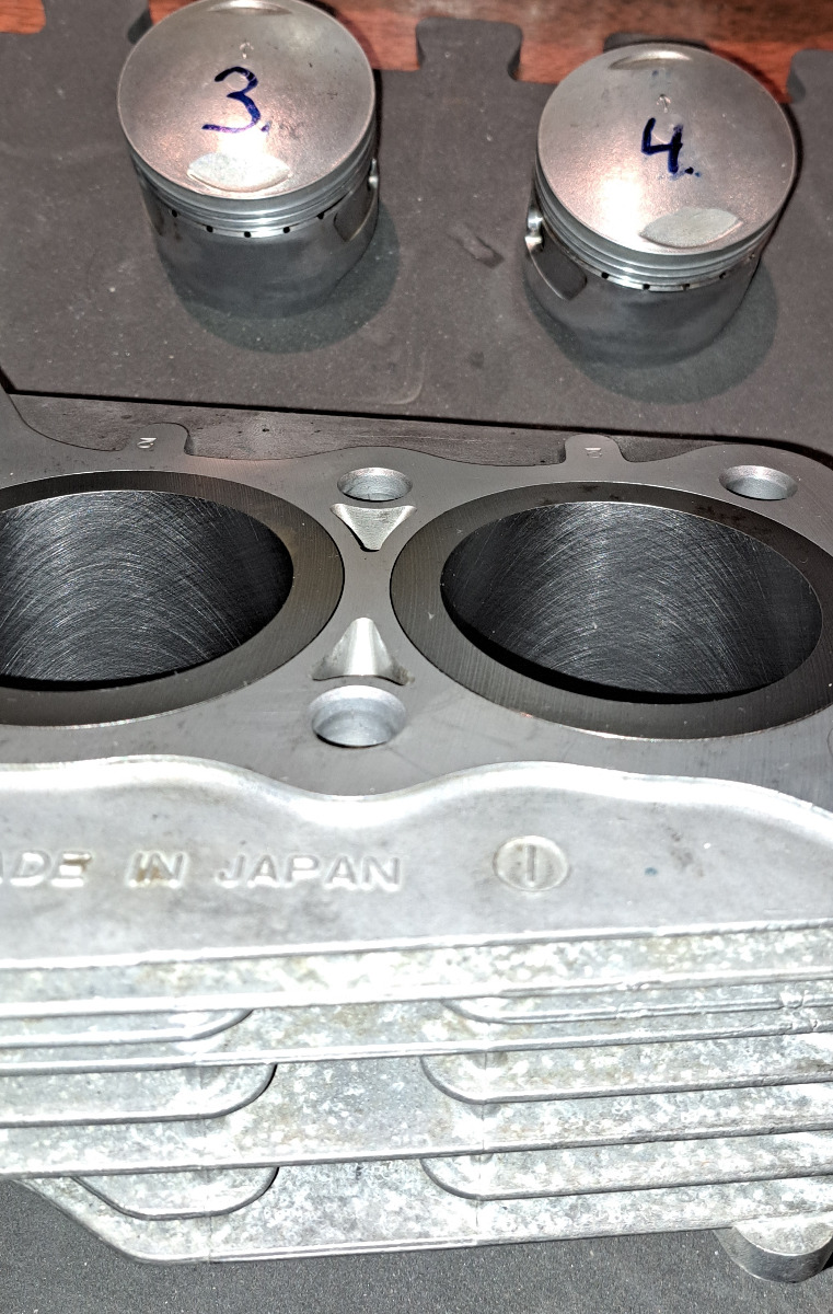

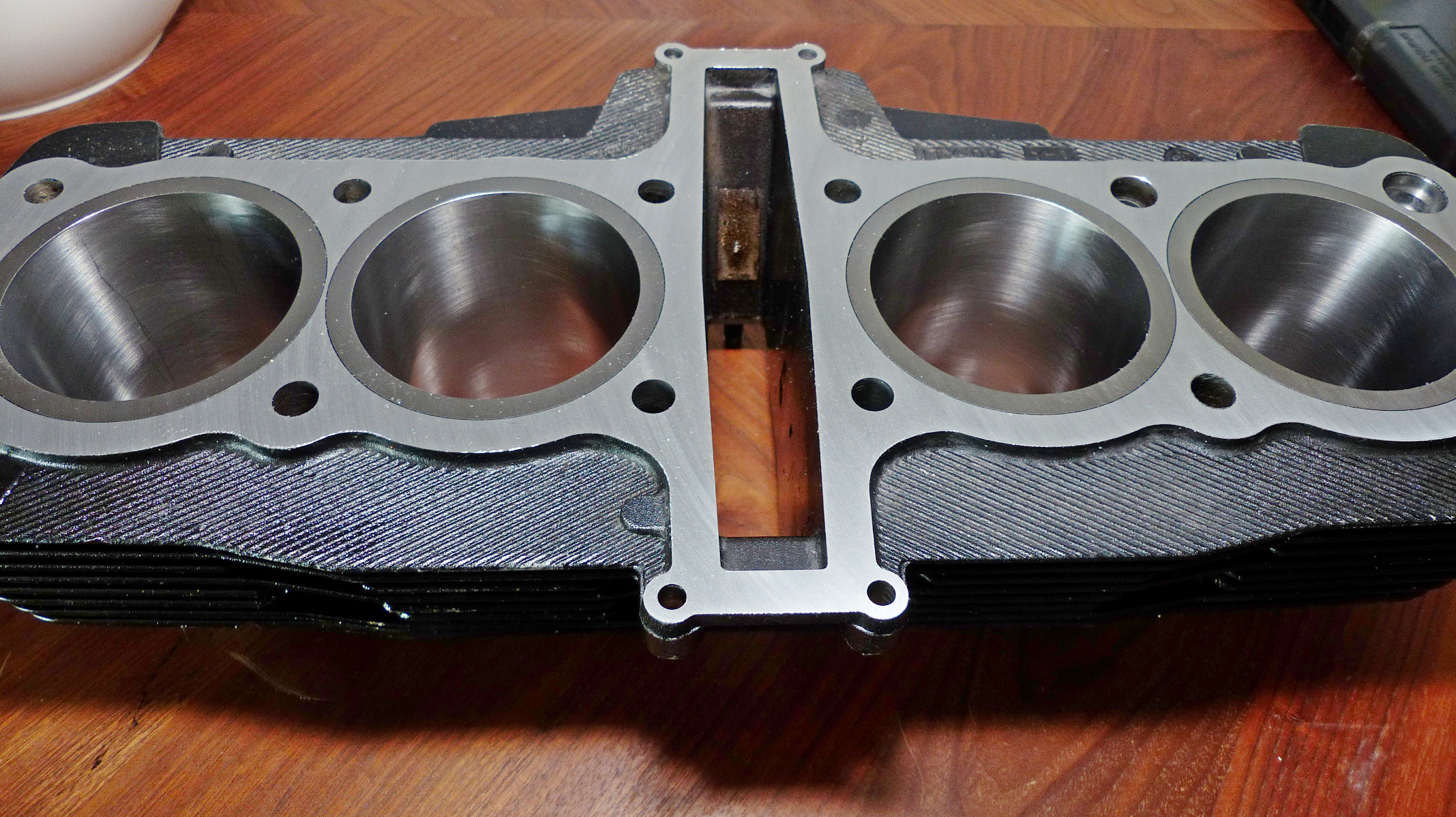

Today i have recieved the cylinders from the Machine shop .I am not so impressed that they have used a ballhone to finish !.The shop is a big professional shop that has been in buisness for many years .
The surface looks to rough .Also the angle is a little steep? Compared to the other shop that bored and honed the cylinders on my FJ1200 they look to rough.the fj cylinders is in the last picture.The price for honing and decking was 930 usd. I have not had time to measure the clearances yet.

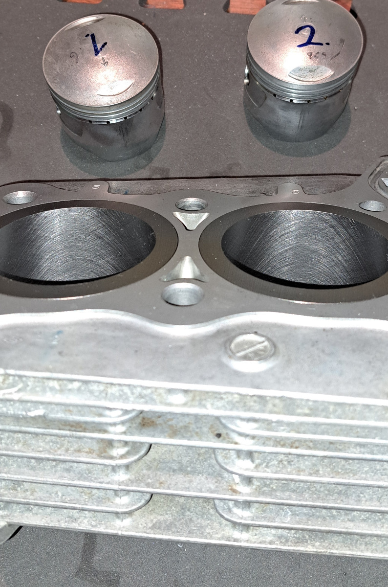

Just did some measurements and it was not as i hoped.Seems they not have used the pistons and bored from there.,but the clearances is on the small size so that is good.I will do some more measuring later and may switch the pistons in their bores .I can also hone a little
