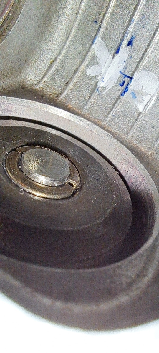

As long as the valves haven't been tipped before you can remove 0.30mm before touching the collets so i would remove the maximum 0.30mm which should at least get you to the 250/255 shim range.
As an indicator the distance from the top of the collet groove to valve tip should be a minimum of 4.2mm after tipping.
If they are already 4.2mm they may have been tipped already.
On all those other valves you should re-shim as close as possible to the upper 0.15mm clearance.
If the next shim size takes the clearance to slightly above to around 0.17mm this is ok .

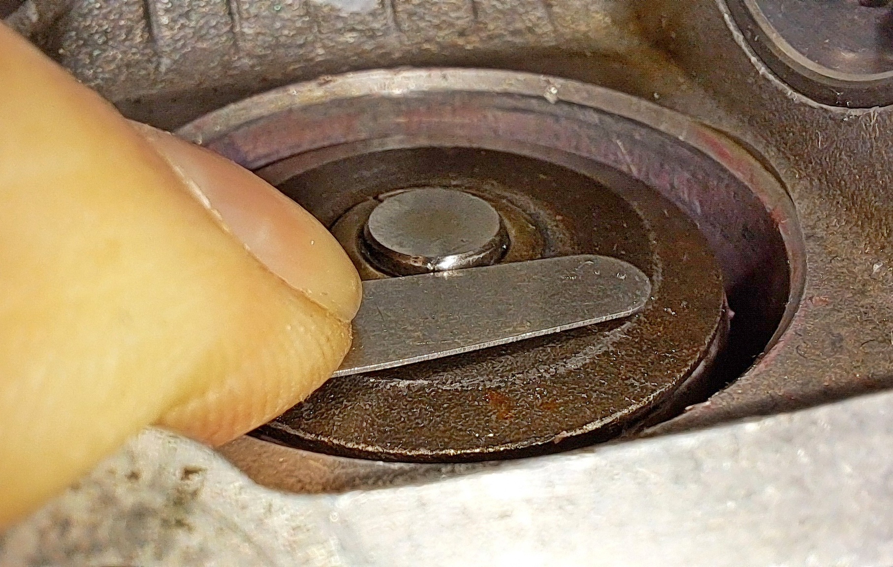

I have not taken the valves out yet but did a quick check with a 0.30mm felerblade that is pressed down on the keepers.so it is not tipped before i think.
