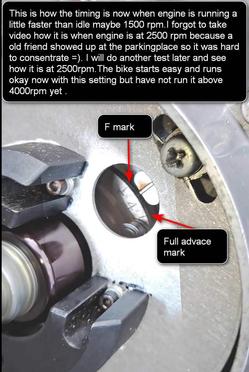

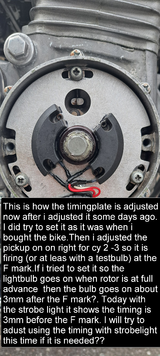

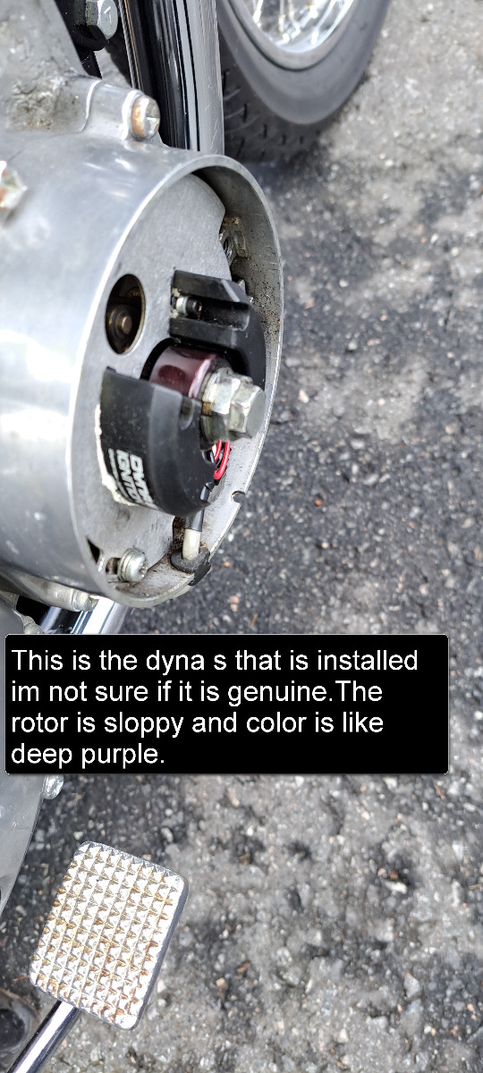

Then i attached the strobe light and this time i connected it to the battery in bike and it worked. Then i got distracted because a old friend i have not seen i a year showed up and started talking with him .So it was hard to keep focus on the testing.I forgot to run the engine at 2500RPM and i only filmed when the engine was running a little above idle. I took a stillpick from one movie and the timing is about 3mm before the F mark .

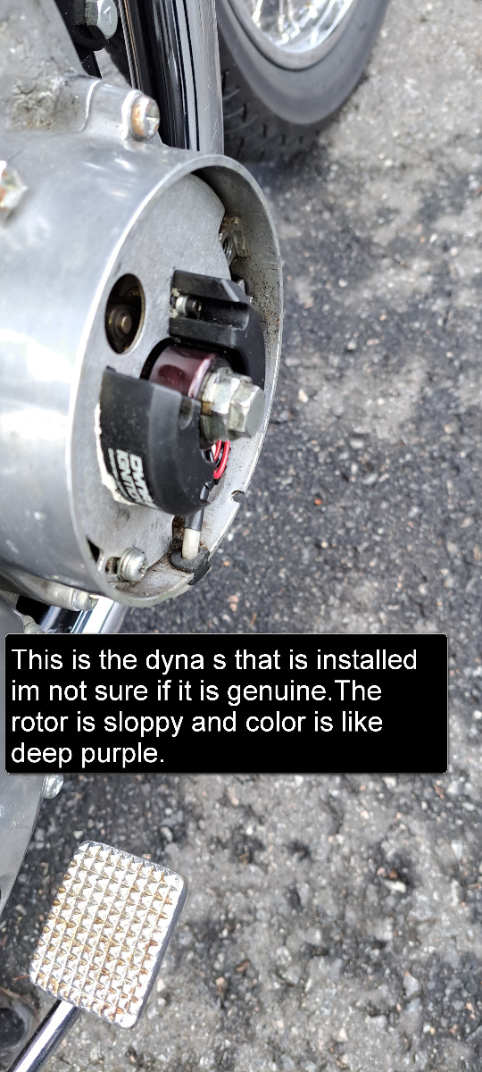

It is strange that with the testbulb the bulb lights up about 3mm After the F mark? Took a pick of the dyna-s and the rotor is sloppy no idea if it is genuine.
Not sure if i can just ride the bike the way the timing is set now. It runs good, but have not been over 4-5000RPM yet and maybe if the timing is to far advaced the pistons and valves can make contact??
I dont know what rotor i have where is the stamping?
I will do another ride and do some better pictures from the timing marks with the strobe at full advance
And i forgot the rotor wobble a bit when engine runs

The timing light is the best way to set it. Looks like you have enough room to adjust. When the rotor is sloppy it jumps back and forth a little causing a slightly rough idle. At high RPM it has no effect.

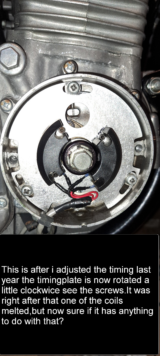

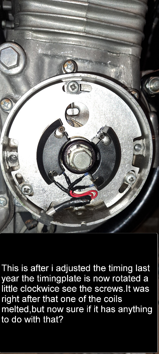

Steve: the bike idle steady ,but i have it at a little high idle now

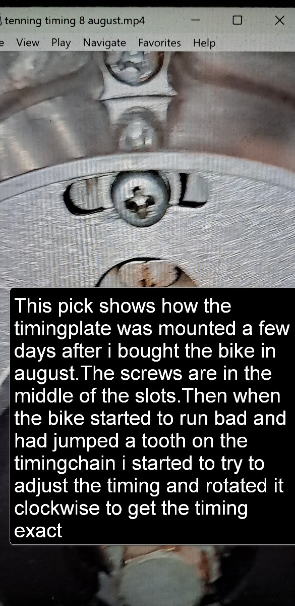

Here are some pics how the timing backplate is adjusted. I had a pick on how it was when i bought the bike before i started adjusting it because the bike started to run bad and the timing chain had jumped one tooth. Then i adjusted the timing but think that the timing chain already had jumped at that point.Then after fixed the jumped chain the bike started running bad again and this time it smelled burnt electrical and then stopped .Then i found one of the coils had bubbles underside and was not working
.But one important thing in all this was that i had trouble setting the timing on the camchain because it was worn out sliders rollers and stretched chain. Now after the rebuild and all parts replaced it was easy to set the cam chain timing.

Now when looking at the last pick above it looks like the rotor is not sitting centered .I will check that

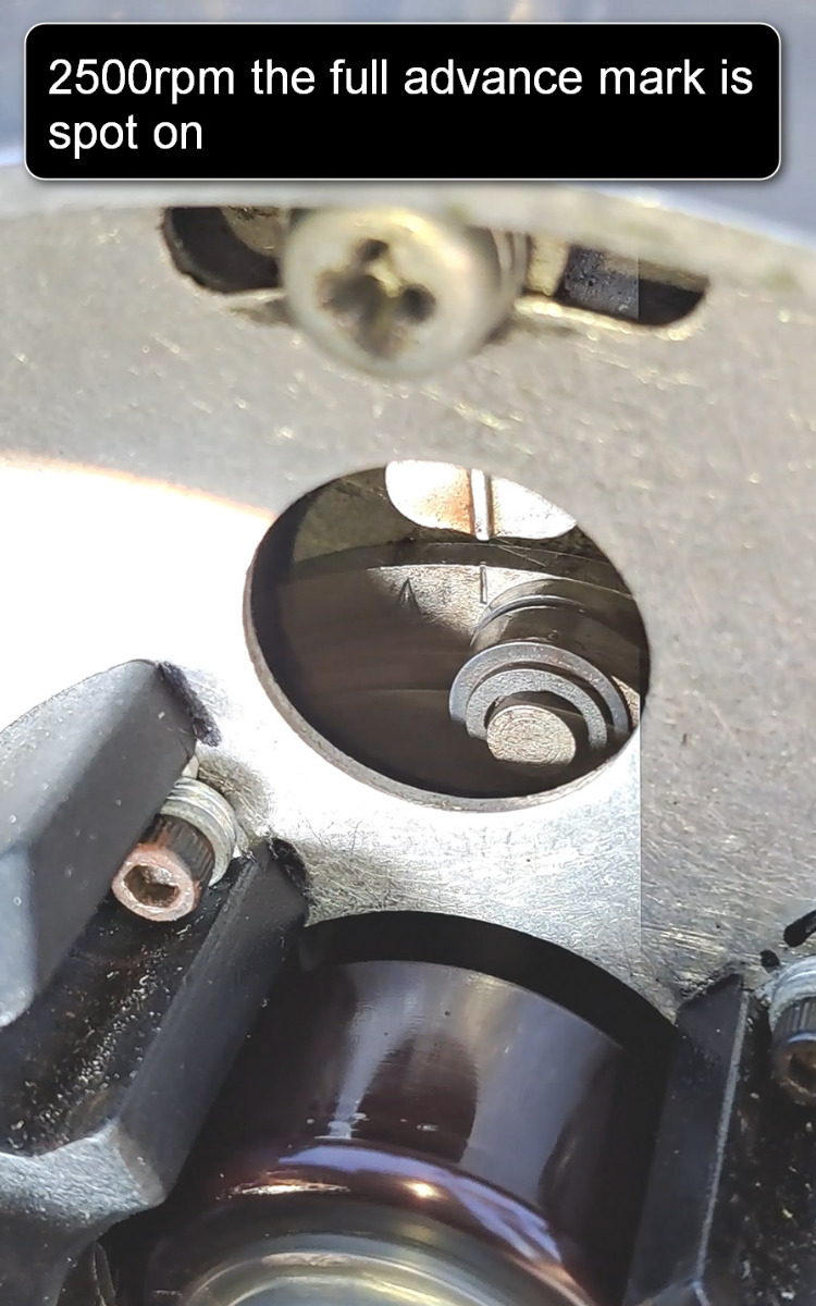

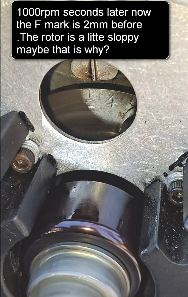

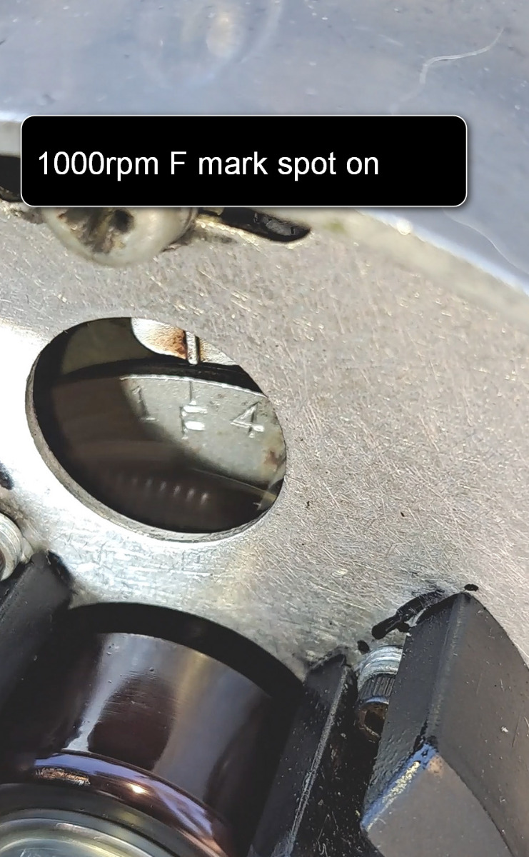

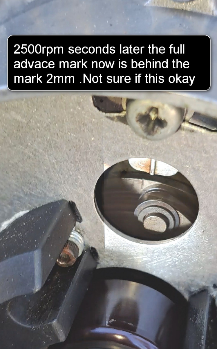

.Today i tok a long ride ,but i had to use to much choke the first 15 minutes of the ride to get the engine run okay.It was cold weather about 4degre celcius so it need choke, but not normal for that long and after the engine started to get hotter it runs with no choke but started popping from one exhaust .i knew that cyl 2 was leaner than the others since the exhaustbend was hotter than the other.So when at a gas station i turned the mixture screw on carb 2 15 minutes out and the popping stopped.cyl 4 was the coldest pipe so turned mixturescrew on that about 5 minutes in to get it more lean.Then i vent for a longer ride and the bike runs very good and today i was
pushing the engine up to 6000rpm and accelerating harder to make sure it is good pressure behind the pistonrings. Then when i reached the destination i started to check the ignition timing with a strobe test light.This time i turned the idle down to about 1000rpm before starting the check. I checked 1 and 4 first now the timing was spot on the F mark ,but not all the time it moves about 2mm. Then turned the idle so the rpm was 2500rpm and tested it was the same
sometimes it was spot on the full advance mark and seconds later it was 2-3mm before the mark so same there. Cyl 2 and 3 i could not check because the timinglight did not work and i also discovered i had forgot my JIS screwdriver and tools at home
so i will do another check on 2 and 3 later.
So the question : is it okay that the ignition timing point moves like this or is it because of a sloppy rotor on the dyna-s?? the bike ran very good so guess it is okay so long the advace does not move to far and start burning holes in my pistons.Here are some pics from today test
so i will do another check on 2 and 3 later.So the question : is it okay that the ignition timing point moves like this or is it because of a sloppy rotor on the dyna-s?? the bike ran very good so guess it is okay so long the advace does not move to far and start burning holes in my pistons.Here are some pics from today test

I don't think that will be a problem. You could retard it a little if it does. Have you checked if the springs are tight at rest?

21 Apr 2024 15:02I don't think that will be a problem. You could retard it a little if it does. Have you checked if the springs are tight at rest?
Hi Steve no i have not checked the springs maybe they have lost some tension did not think of that i will check tomorrow also will check if some circlips has fallen off like on your advancer in the video.
Re: Need confirmation that timing is set wrong on my 1976 KZ900
21 Apr 2024 15:06
You can tighten them up by carefully bending the loops so there is no slack. One side is usually enough.
