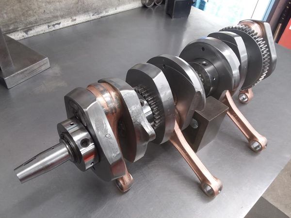

01 May 2023 08:31When I enlarged the video to full-screen with highest resolution, the playback would stop every couple seconds and provide a frozen momentary view.
Got me curious how a roller crank is balanced with rods flying all over...
Is the crank first dry-assembled, trued and balanced without the rods...then pulled apart, and welded together as it is final-assembled with them?

01 May 2023 09:14Yes!

And I believe the rods are weighed and made to be the same by taking off material to match the lightest one. On their page they show a Harley crank and the welds are tiny compared to other ones I seen.

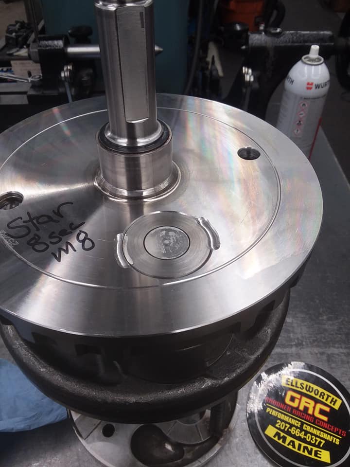

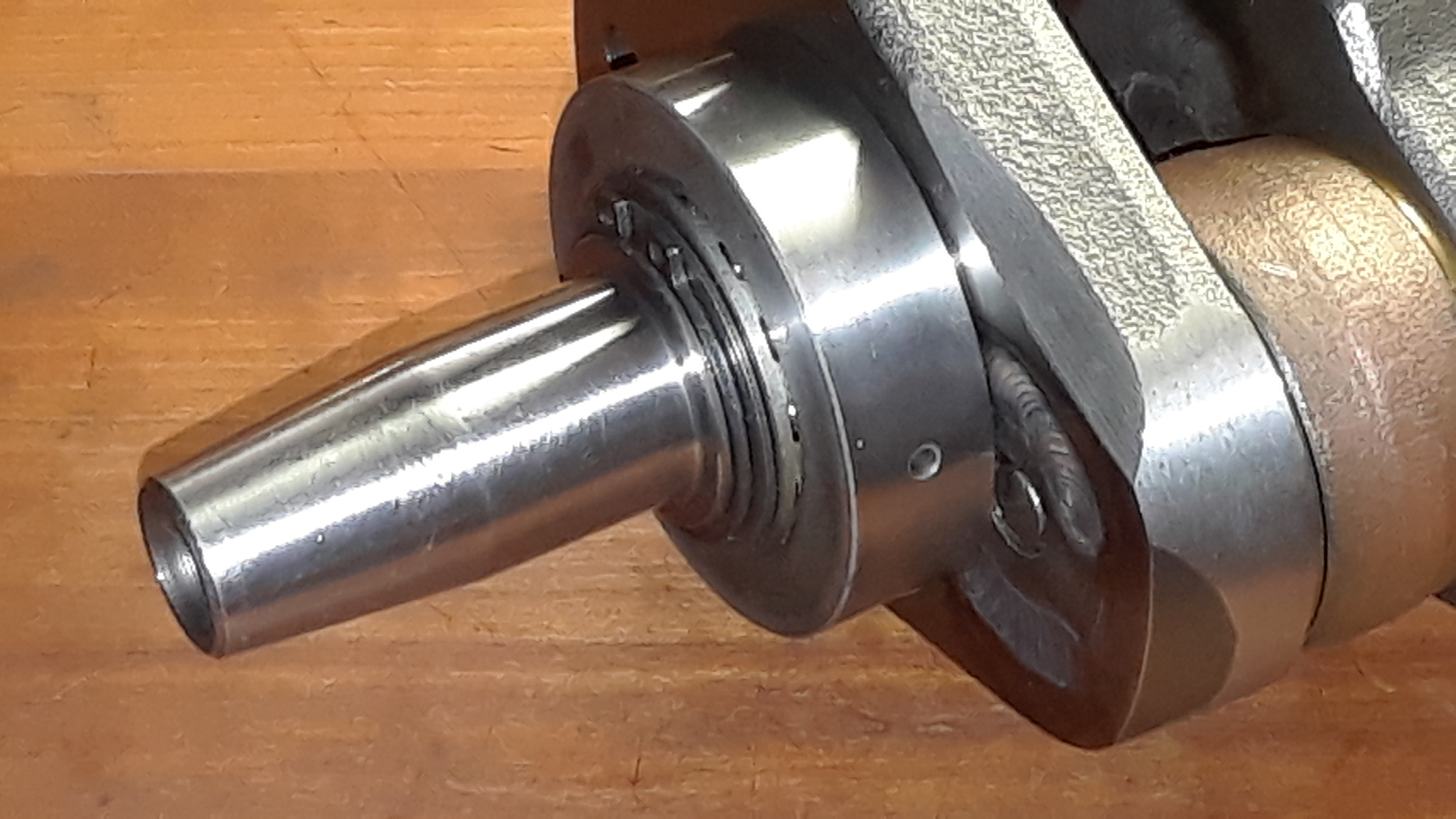

BTW these aren't welds only where the prepped it for welding.

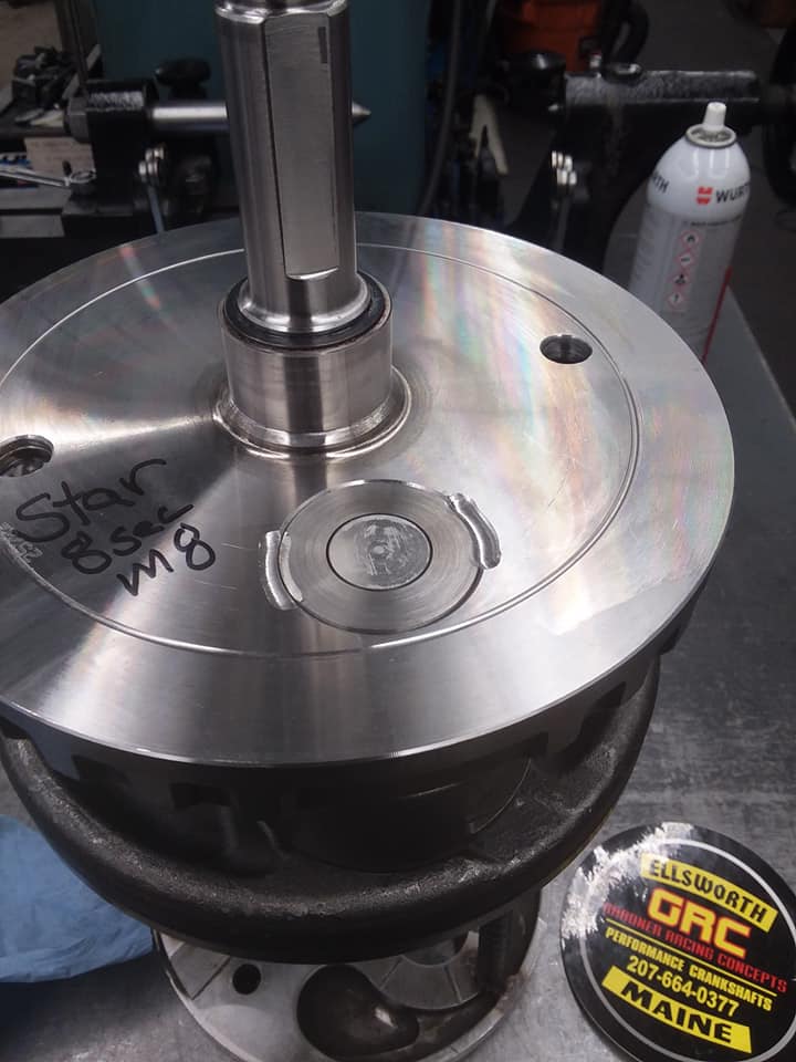

Is material removal during the balancing process a possible explanation for the ground-off areas of the counter-weight shown in the image below?:

Looks like it.
