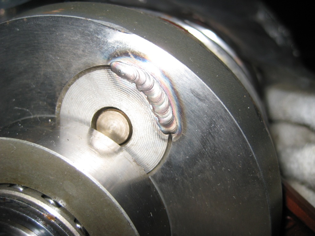

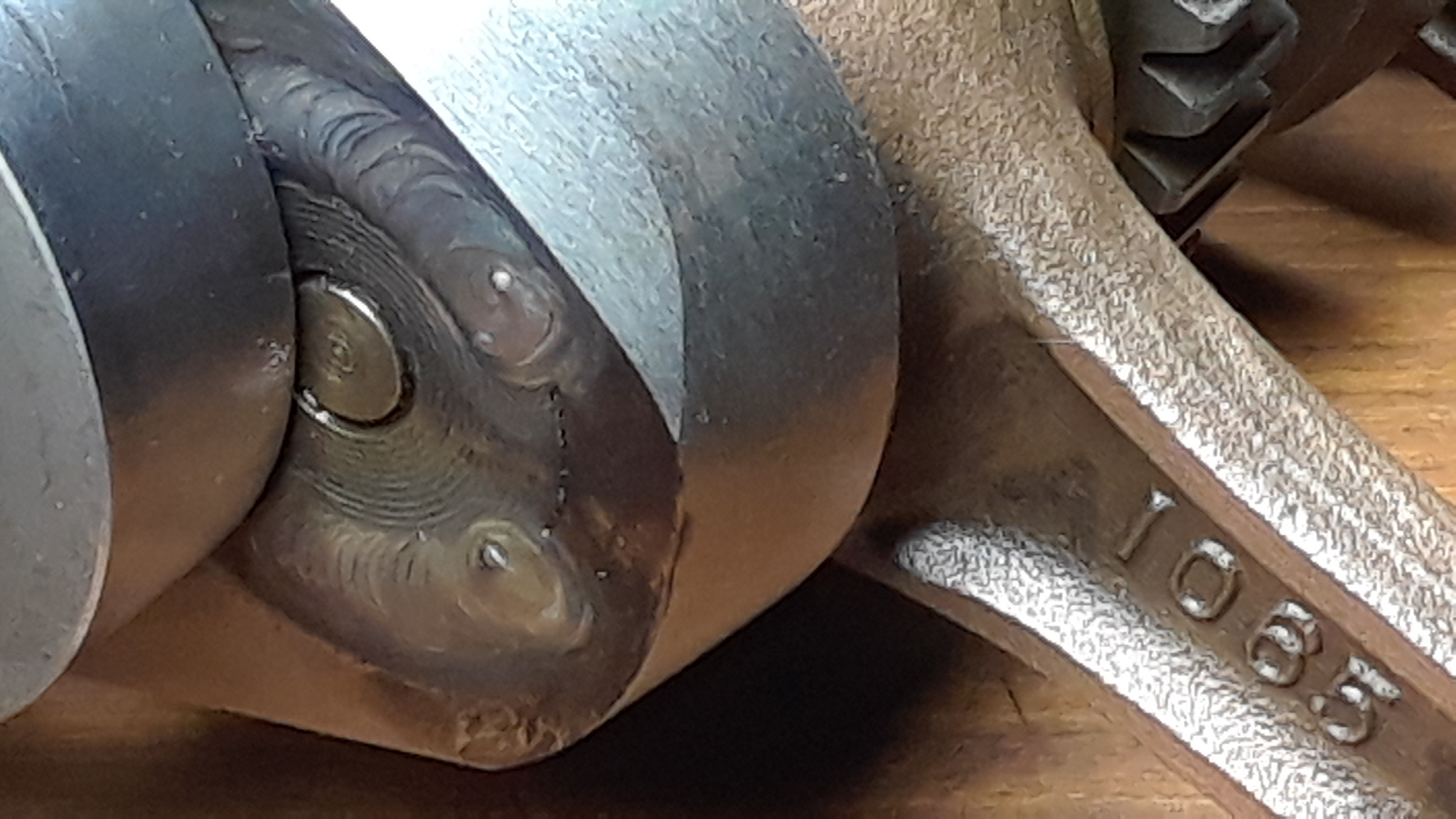

I have had two early KZ1000 cranks welded locally for $150 each (friend price) indexed and trued to within .004"
The welds :
Good enough for light drag or hot street. That guy has retired.
The welds :

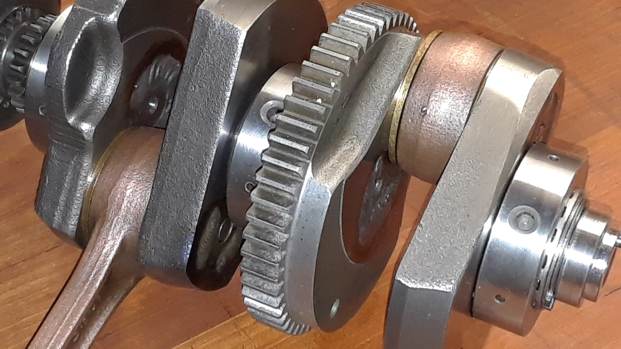

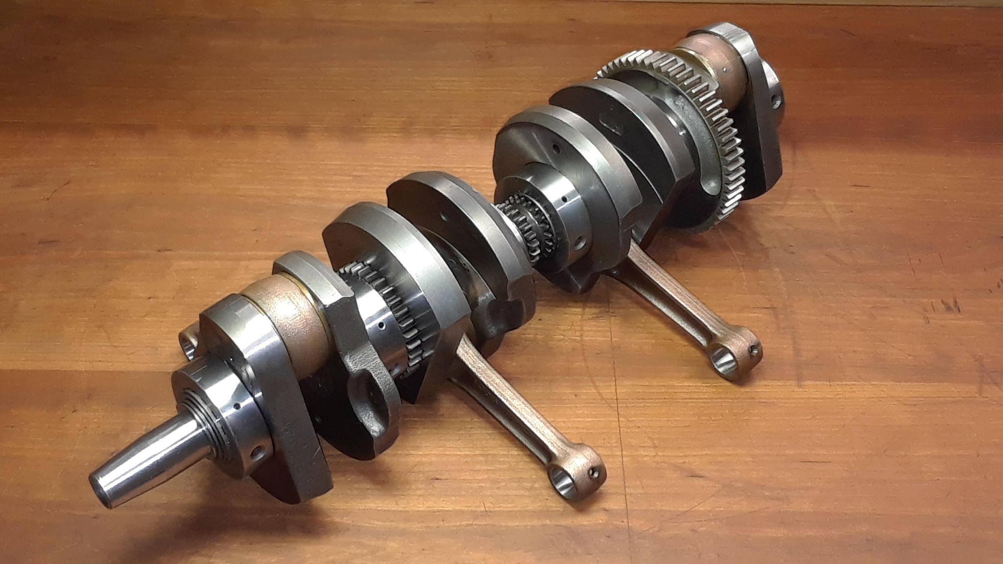

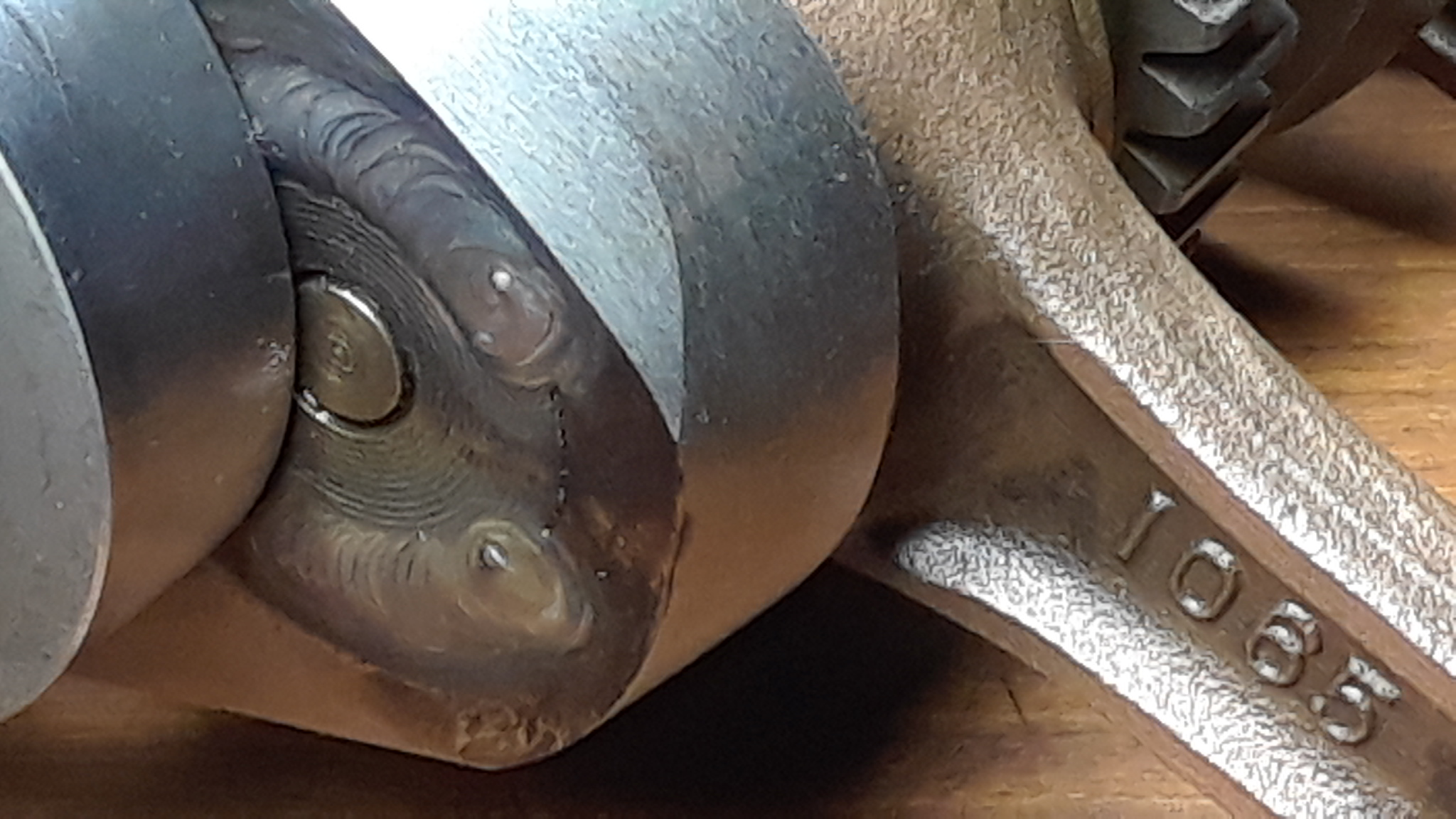

My latest stash addition for some presently unknown future purpose:
What do rod numbers 1065 signify?
1982 KZ1100-A2/1170 sleeper 😀
Last edit: 20 Mar 2023 22:13 by daveo.
The following user(s) said Thank You: Nessism, Wookie58

Dont know what the numbers mean

21 Mar 2023 06:31I suspect there is a "plan" festering for this gem - "go on" you call tell us, we won't tell Mrs "O"My latest stash addition for some presently unknown future purpose:
Re: Crankshaft Assembly Question
21 Mar 2023 09:11
Pearson mentioned the number on the rods is like a lot number of some type. He mentioned that rods with close numbers (50’s to 60’s) are ok to swap around. Numbers with large spreads (50’s to 100’s) are not interchangeable on the same crank. The way I understood it, it was somewhat of a weight concern in the lots. This came about when talking about using two crankshafts I have to build on good one. One has good bearings and a couple bad rod small ends, the other has good small ends but a couple bad bearings. Pearson said as long as the rod numbers are close he could do it.

21 Mar 2023 09:40
Looking at those welds I would think there will be no twisting on that.
21 Mar 2023 14:03She looks like a beauty Dave
A reliable source suggested it looks like a Falicon crank. What that means specifically I am unable to speculate.
The P.O. said that the donor engine was removed from service thirty years ago when it had just 3K miles on it.
I have to agree, based on the like-new condition of other related components included with my purchase.

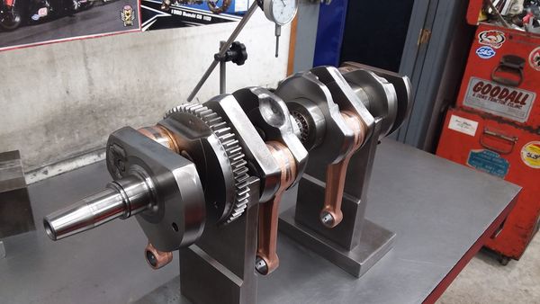

Here is a real Falicon
KZ 1000 crank
Ultra lite Supercrank
Round journals have been cut to porkchop 900 style to lighten
Then journals are knife edged to cut thru oil mist and air
Whole thing is highly polished
All the normal crank work to rods ,bearings, welding , truing, indexing and of course magic dust LOL
KZ 1000 crank
